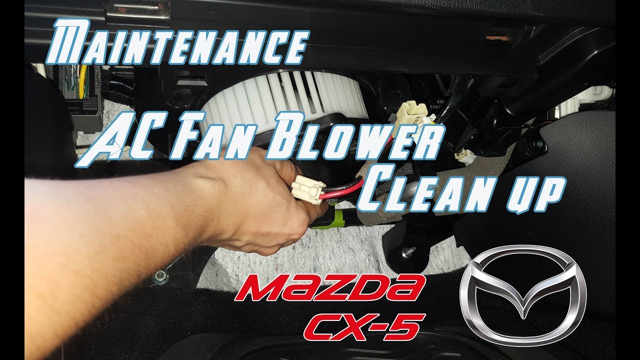

Does this happen when the heating or a/c is on AND off? I had a similar issue and it ended up being a small piece of leaf in the cabin intake blower under the dash. It’s fairly simple to remove the blower motor and clean the filter out - if that sounds like it could be it?
Here’s a video
If that’s not the case, no idea what it is.

See this post and follow the trail back to the user's video.
