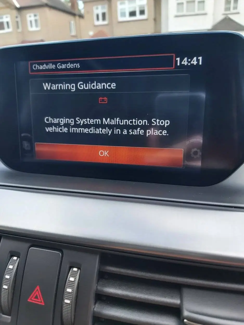

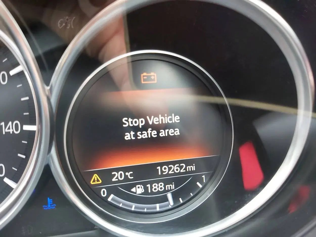

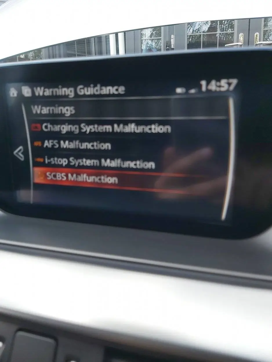

Hi, today I decided to reset the istop by disconnecting the battery.
I normally do this occasionally to get the istop running.
However on this occasion, the car threw up the following sign. I tried battery disconnection for about 20 minutes by disconnecting the negative terminal.
Before I take it to the dealers who will no doubt charge an arm and a leg, is there anything else I could try before surrender to the dealership.
Perhaps the alternator has packed in, or maybe the software needs resetting?
Anyone had this similar experience?
Forgot to mention, the a/c fans, indicator lights, hazard lights also stopped functioning.
I wonder if it's gone into limo mode? How do reset?
I plugged in my Autel code reader but no solid codes found.
The car battery seems to be reading 12.9v, and I've not put it on trickle charge.

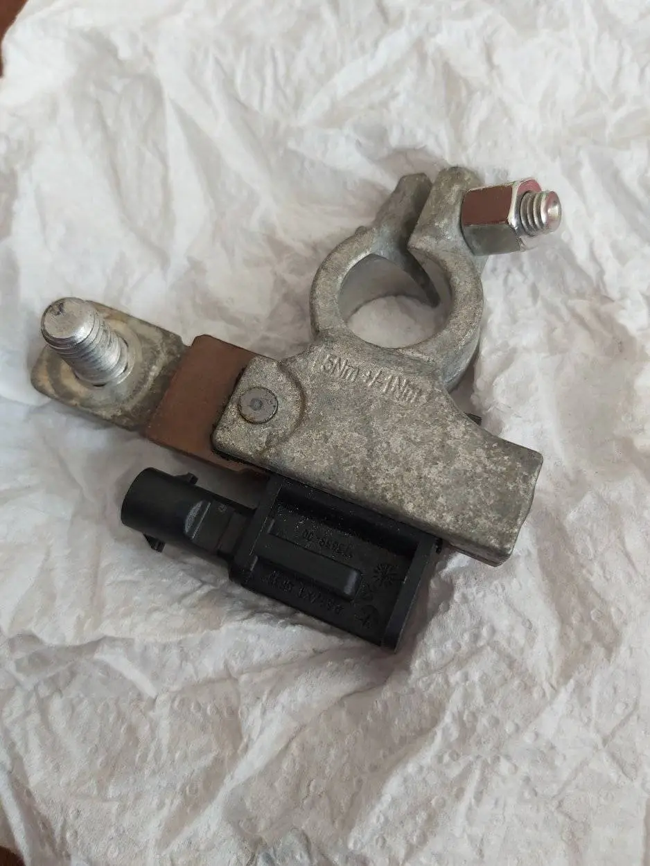

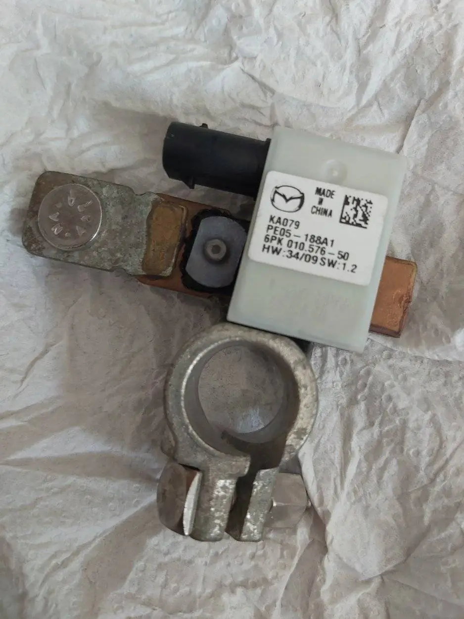

I have placed an order on ebay for second hand current sensor which is on its way. I found out that the part number is the same across most Mazdas with I loop. The one I have on its way was removed from a salvage Mazda CX. Part no. 6PK 010.575 -50
If it works it will be a cheap DIY fix and save a trip to the dealership.

Anyway, just an update regarding my problem. I swapped out the current sensor with no joy 😞

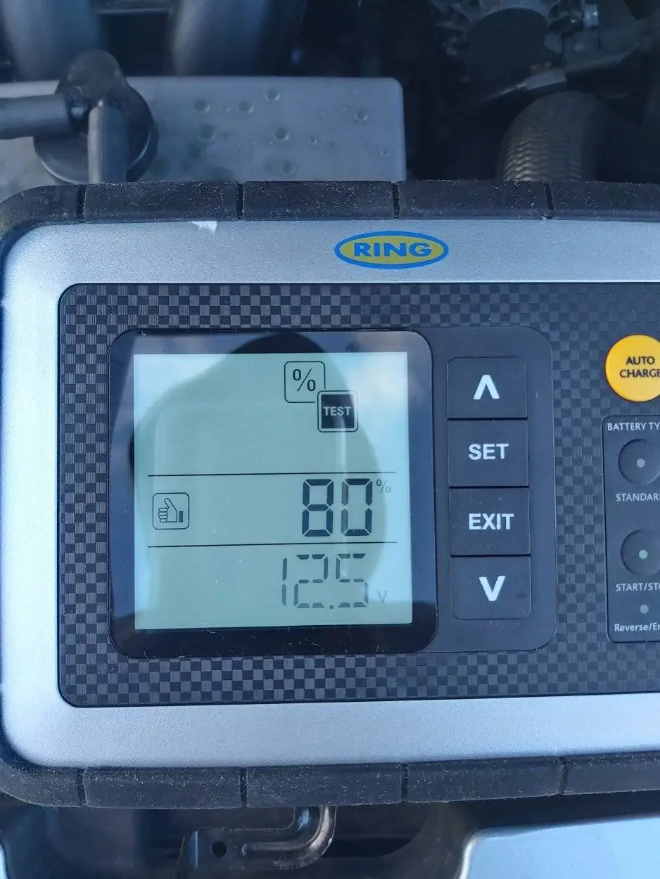

Anyways, I did another battery test and I got the following screen. I performed the test twice and the readings are shown below.
I have put the battery back on charge to see if it makes any difference. The car does start though but the dash remains lit with warning lights.

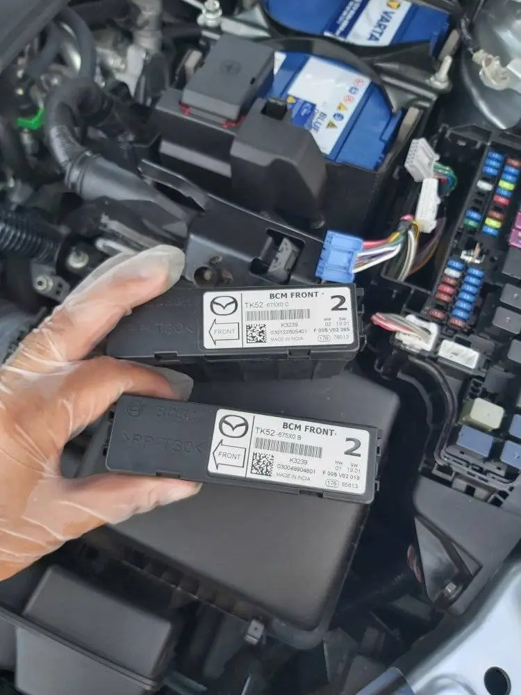

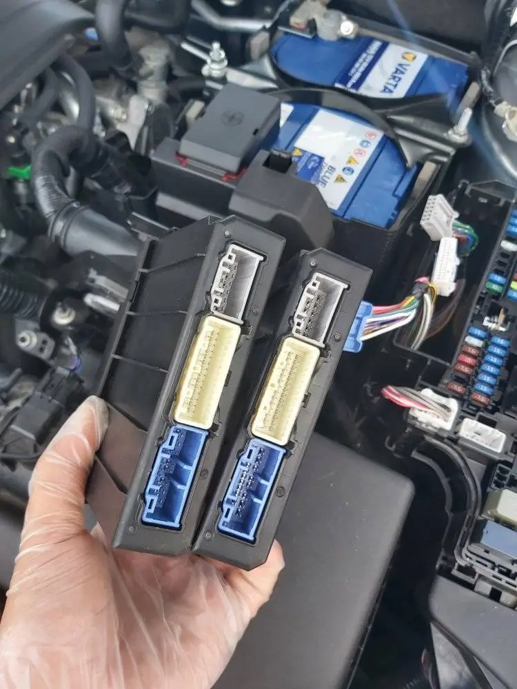

Okay, got some good news. The car is now fixed. I apparently fried the BCM whilst performing the battery reset. I have no idea how it got fried but that's what it was. I took the car to Mazda dealership to run me a diagnostic, confirming a faulty BCM.
The car is now running fine, no problems. The BCM is actually easy to replace, only took me 5 minutes. Its housed inside the fuse box any anyone can replace it, no previous experience required, only need flat screw driver to release the clips to remove the unit which slides out. Even the plugs are colour coordinated so can't go wrong.
I hope this thread is useful to someone. If you experience the same symptoms, it may need a BCM. The part I installed is second hand and taken out from a Mazda CX5. The part numbers must match for it to work but please check on, the numbers sometimes are superceded and usually denoted by a minor change to the last character. For example my original part number is TK52-675X0B, which was later only available as TK52-675X0C.
Anyways, happy days. 😊

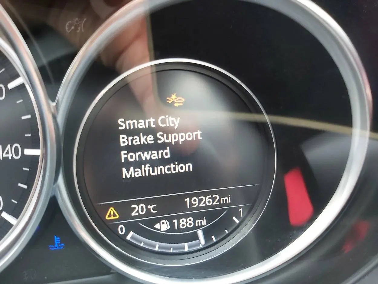

Hi apologies, the BCM stands for body control module, it's controls some of functions like Istop, smart city brake assist, interior fan heater/AC, wipers, indicator/hazard lights. These were all the items which were knocked out when I fried it.
Thankfully I found a cheap replacement from ebay, a secondhand item from a CX5. The BCM is found inside the fuse compartment box, it's rather expensive from the dealership, so was lucky to have found it.

Hi, have a Mazda 6 skyactive istop, removed the battery to swap the fuel filter and got exact same symptoms you describe, to the letter!! I came across your post after trying every other possible reset on forums, had an Autel on it etc etc. I've ordered a replacement bcm from ebay. My question is did you plug it in with battery connected? I'm not too keen on disconnecting the battery after last time you see!!
Usually you have to disconnect any car battery in the correct order of negative off, then positive off, and reconnect with positive on, then negative on. If it's not done in the correct order, the battery can cause a short that fries the BCM. Since the module doesn't require any programming, I would just connect it while the ignition is off. Hopefully @badgx can chime in.
In the future, if anyone anticipates the need to disconnect and reconnect the battery for troubleshooting or resetting the car's electrical systems, it might be a good idea to install a battery disconnect switch.
Wow! I'm very sorry to hear this. I have disconnected the battery on my 2015 6 many times at different intervals without any issues .
Yeah I've no idea why it's fried the bcm, did the standard thing negative off first on last. Unless anyone's any other ideas I'll go with ignition off and connect the bcm. Many thanks for your help
Just a follow up on the BCM issue, got a 2nd hand one from Australia on ebay. As per badgx it sorted issues completely. For anyone else wondering, fitted it battery connected ignition off, doesn't need programming as per badgx has already mentioned. Only slight issue indicators didn't work initially but stopped engine and restarted they were fine. Happy days!
