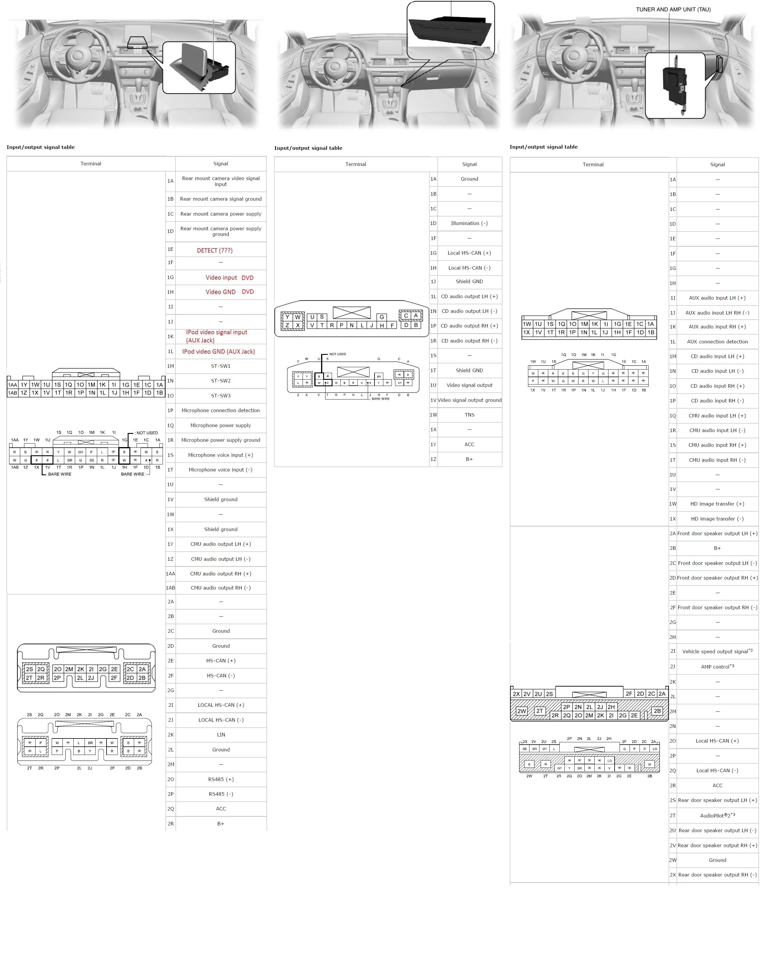

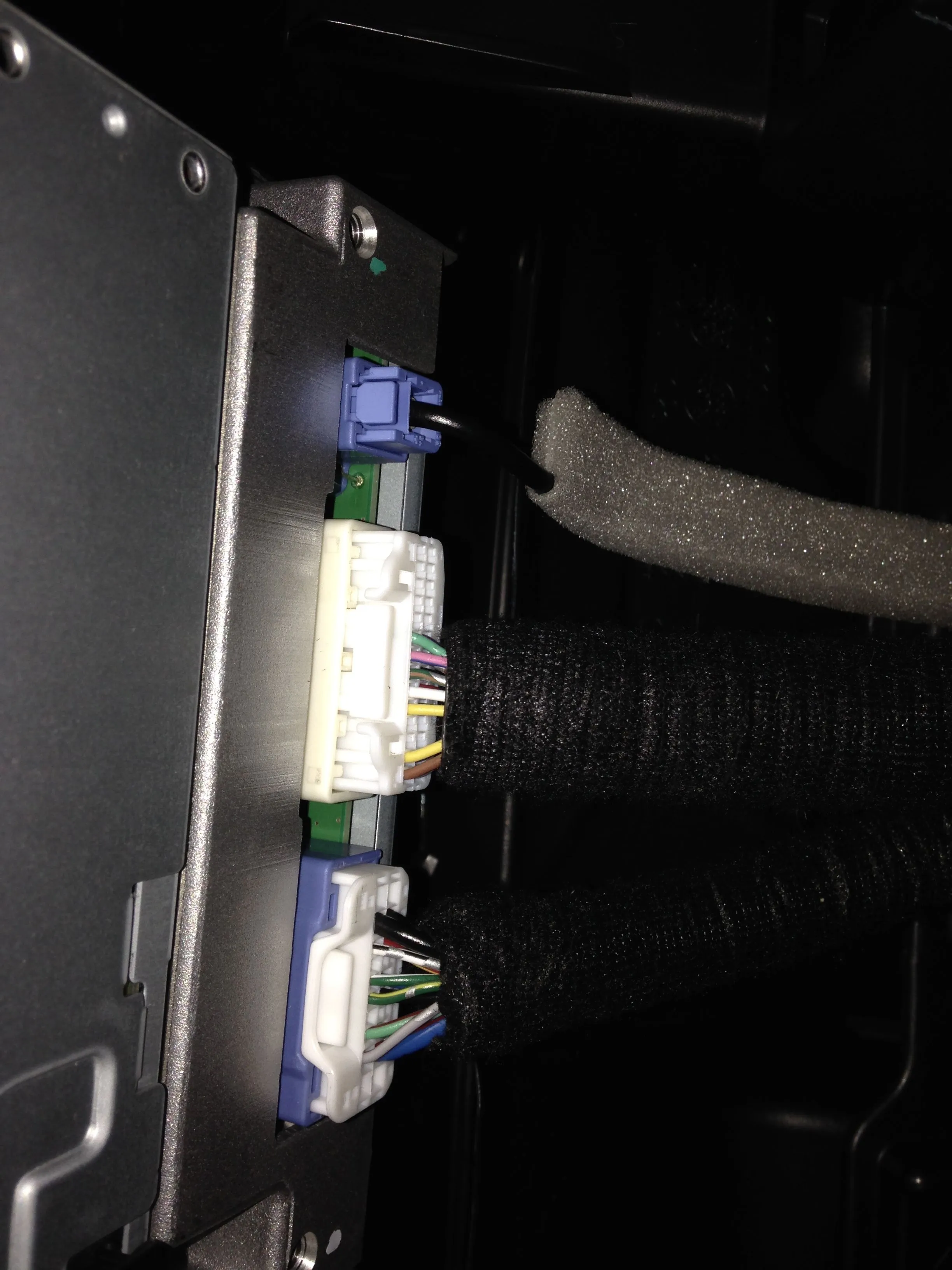

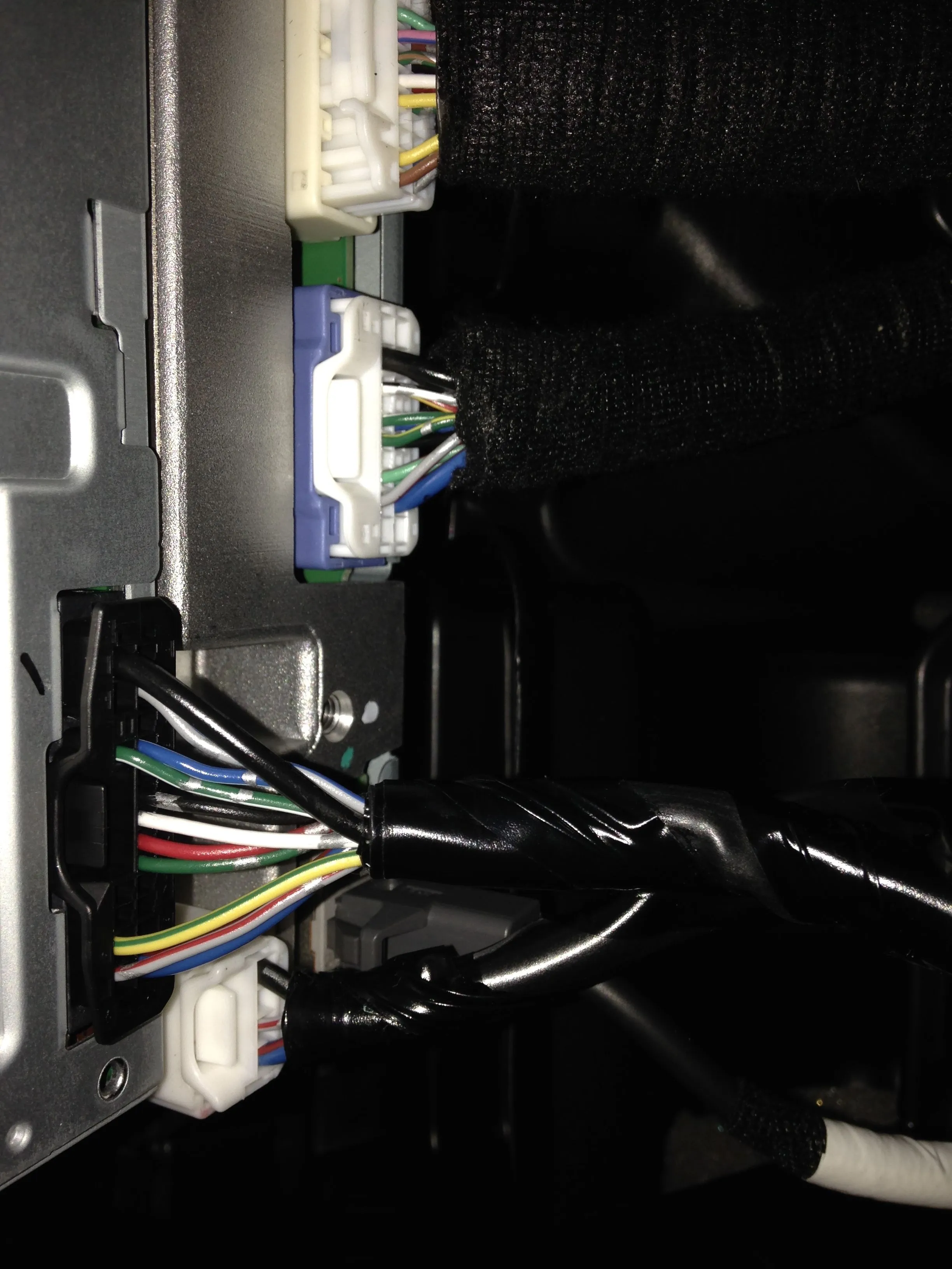

Oh and related to your original question now that I have spent a bunch of time behind my radio. There are 6 connectors and on mine one empty plug which I believe is another spot for USB ports.
I have attached the diagram from a mazda 3. My experience is they are the same. The screen part and cd drive part are bolted together with a bracket for the cx-5.
so you have the three from the left two columns. There is a GPS plug which is blue with a black wire. Then there is a dark gray plug which I believe is USB. Lastly there is a smaller white one with 4 (I think) heavier gauge wires which I'm not sure what they do. In the pictures, the top black one is the CD drive. The rest plug into the screen unit which must be the brain/arm computer with Linux.
But, there is no specific audio out there. They have separate source outputs that all run to the amp. In the passenger kick panel you will find the amp/fm receiver. That has the four channel high level outputs but again there is no specific stereo input you could grab.
