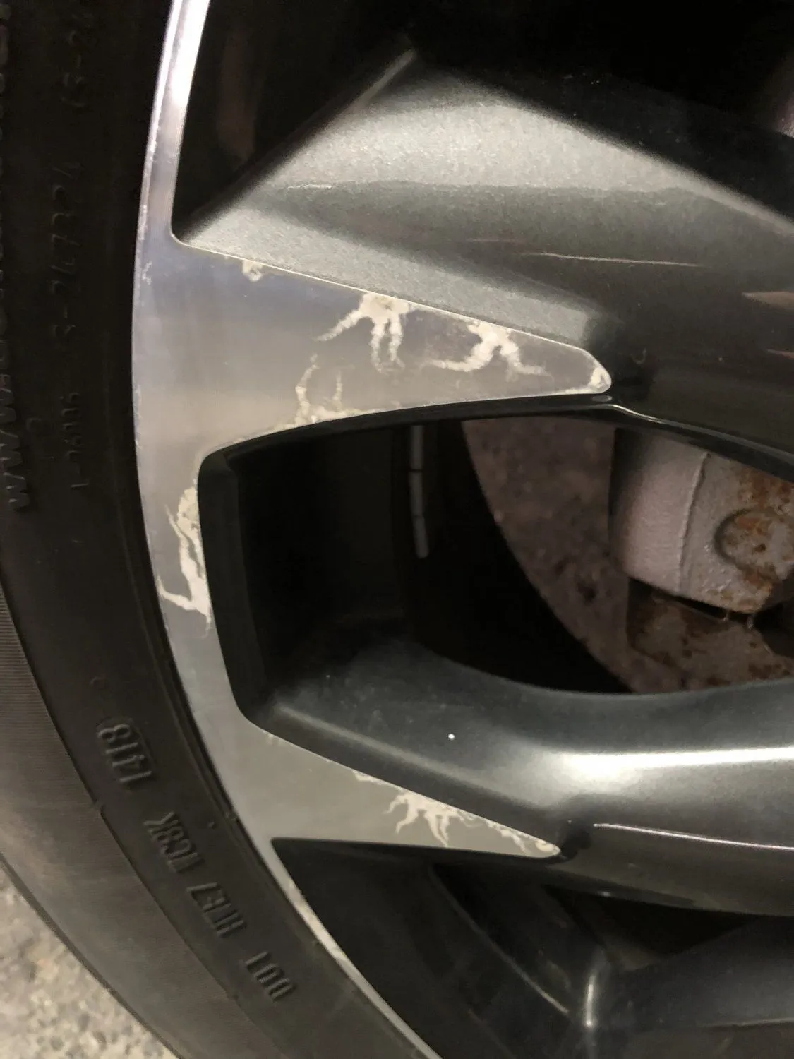

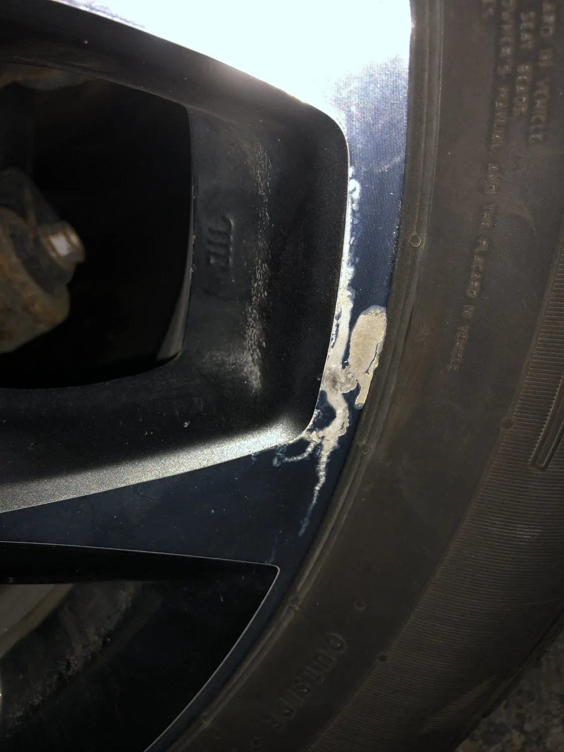

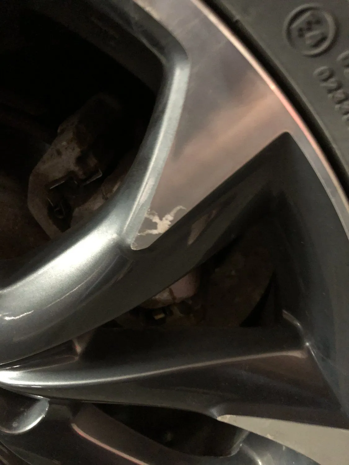

Hi guys, I've come across an issue with my 2016 CX-5 GT and wanted to ask if anybody here have experienced the same. Certain parts of my wheels have frosted patches, kind of hard to describe but I've attached photos. The patches are completely smooth and same level as non frosted part of the wheel when running a finger over it so they weren't caused by curbing. Is this corrosion under the clearcoat? These frosted patches are only on the machined part of the wheel, the dark portion of the wheel is unaffected. All 4 wheels have these white patches.
I noticed the spots when they were very small flecks but now they're spreading and "veining" out. Anybody know what could cause this?

... and yes, it IS corrosion under the clearcoat.

You might be on the right track though, all the "frosted" patches originate from an edge, and only on the machined part of the rim. The clearcoat might be so thin at that edge transition, that moisture found its way under and therefore the corrosion.
