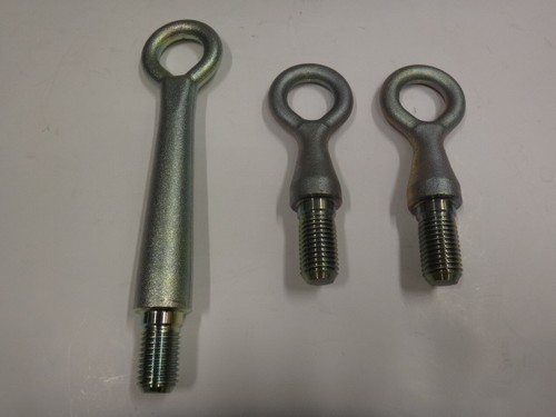

Mine doesn't have the tow hook, only an empty slot to store one. Has anyone figured out the thread size or found a cheap tow hook for their 2017 or newer model?
I had a similar question when I took delivery of my 2018 CX-9. The CX-9 and the CX-5 use the same part numbers for the hooks.
Here are the part numbers:
The parts list shows two "tow hooks":
Front KD53-50-EJ1B
Rear KD53-50-EJ2B
And the eyebolt details if you want to make your own:
You can make the eyebolt. The thread is M20-2.5. I'd use an eye nut plus a threaded stud of a suitable length.
https://www.mcmaster.com/#eyebolts/=1eab32n
I dont know why Mazda US remove them, they are left in on a new U.K. vehicle and in some cases they leave a second set in a separate bag. Ive got a drawer full of the things at home, Id have brought some over and posted them out if Id known. I can assure anybody doubting their use that they are used to steady them on the ship and in the U.K. they come off the transporter with the blanks in the bumper not fitted but they also use purpose made holes in the chassis.
