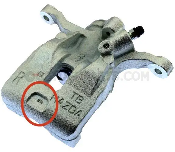

Thought to add to this thread rather than starting anew... have a 2016.5 CX5 that I have 31,500km on and have been hearing some brake noise from the rear. Inspected brakes front and rear and fronts still have life left, but rears need replacing and the outer pad on the left caliper is down to metal (hence the noise heard).
Ordered a full set of Powerstop rotors and pads so am sorted for that, but my questions are on the apparently relevant TSB (R052/16C): by my VIN, I believe I fall within the range affected but my calipers do not have a lot # stamped on them to indicate whether or not they have been modified. So, from my reading of the TSB I would need to replace the affected side (i.e. left caliper), the local dealer I bought the car from no longer sells Mazda so are little help and the next closest is some ten hours drive away.
From the TSB they give the part # for the replacement caliper needed, but would a OE-equivelant caliper suffice? Rotors and pads have cost me some $460 all around and I would like to keep my costs down if possible and would be doing the work myself. Any thoughts would be appreciated and thank you to Anchorman and yrwei52 for the posting of the TSB's and other information.

My opinion is you want to replace both rear calipers with revised OEM calipers. You replace everything in a pair on the same axle for brakes, especially brakes are important safety item. Your right rear caliper will be getting worse, and may lock the tire in the worst case scenario.
I’d get OEM rear pads and rotors for $200, and use $260 to get a pair of revised rear calipers and seals. I don’t even believe you can get aftermarket rear calipers with EPB.
Thank you very much for the advice...
⋯ have a 2016.5 CX5 that I have 31,500km on and have been hearing some brake noise from the rear.
BTW, since you can’t see the lot number on rear calipers, what is the manufacture date of your 2016.5 CX-5?
