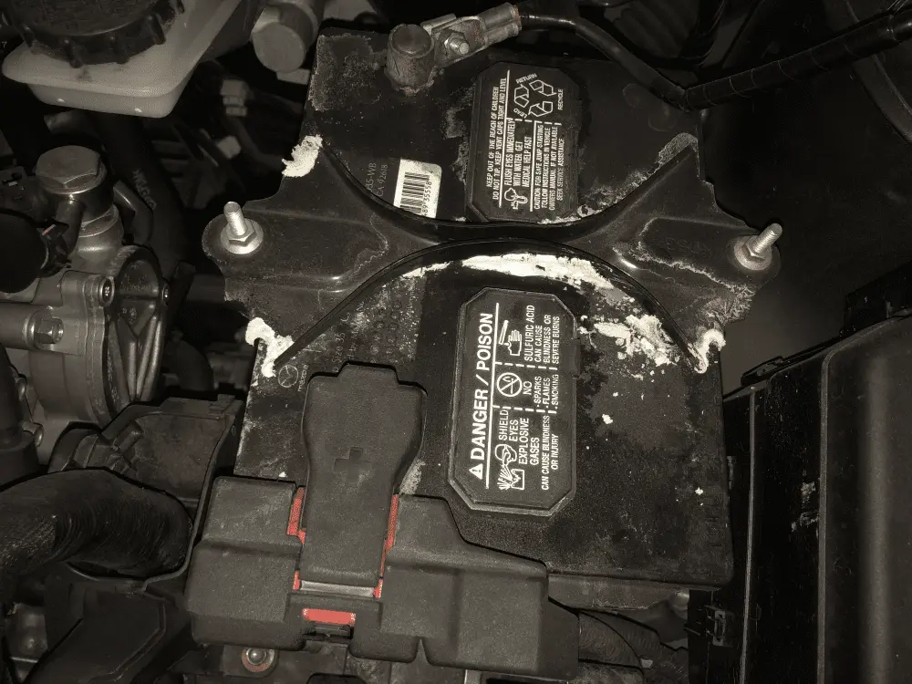

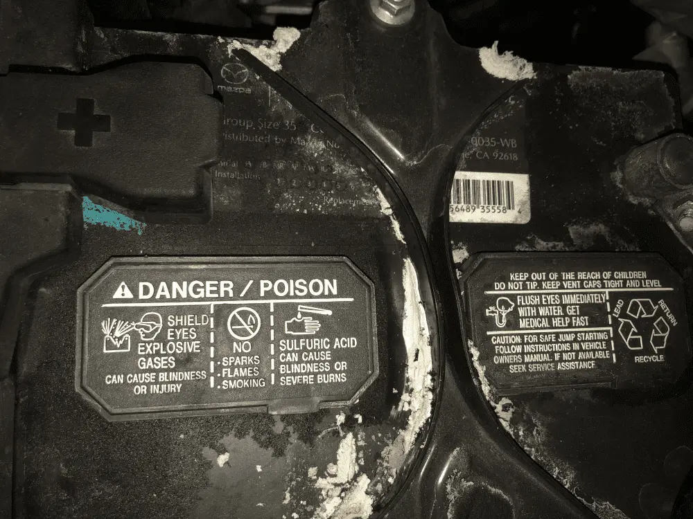

Sometimes the electrics on my 2016.5 CX-5 die...Meaning I have to use the manual key to open the driver's door. The engine seems completely dead. But my daughter's friend told me to open the hood and touch the engine in a couple of places then try to start the engine again...It worked and didn't need a jump start. This is now happened once or twice a day. Any idea why? Btw, the battery looks like this at the moment.

Dying battery maybe? How old is it?
Also what’s the white stuff? Is the battery leaking (i.e. casing cracked at the holding clamps, etc)?
To be honest, overall it seems terrible on the outside.

Touch the engine in a couple of places? And this allowed you to start the car when it wouldn't start before?
Have you had the 'healing touch' in the past? :ROFLMAO:
That battery needs to be replaced, ASAP!
In the pics you didn't lift the positive battery terminal cover but I can see blue corrosion next to the cover. I'll bet that if you lift that cover that the entire positive terminal is corroded. You can clean that blue and white crap off with a mixture of baking soda and water. Use a brush with the baking soda solution and rinse with clean water when done.
You'll still need to replace that battery. Be sure the clean ALL of the connections when installing the new battery.

You have OEM Mazda High Performance battery made by Interstate. OEM battery has 36/60-month replacement warranty. 1-36 months: free replacement and labor. 37-48 months: customer is responsible for 70% of the battery MSRP and labor. 49-60 months: 80% of the battery MSRP and labor.
The factory Panasonic battery should last at least 2 ~ 3 years. This means your current OEM battery should be less than 3 years old in a 2016.5 CX-5 and still has free replacement warranty.
Like mentioned above, take your CX-5 to your Mazda dealer and get the battery replaced ASAP. Leaking acid is a legit reason to get a new replacement battery even if the dealer claims the battery load-tested good (I doubt it though), although sometimes it could be caused by the charging system (over-charging).
Do ask the dealer to clean up all the white and blue stuff on both post terminals and battery holders. I’d ask for free new holders and OEM cable with terminals as the leaky battery has damaged those parts.
If you haven’t, replace the CR2025 battery in both of your key fobs too.
