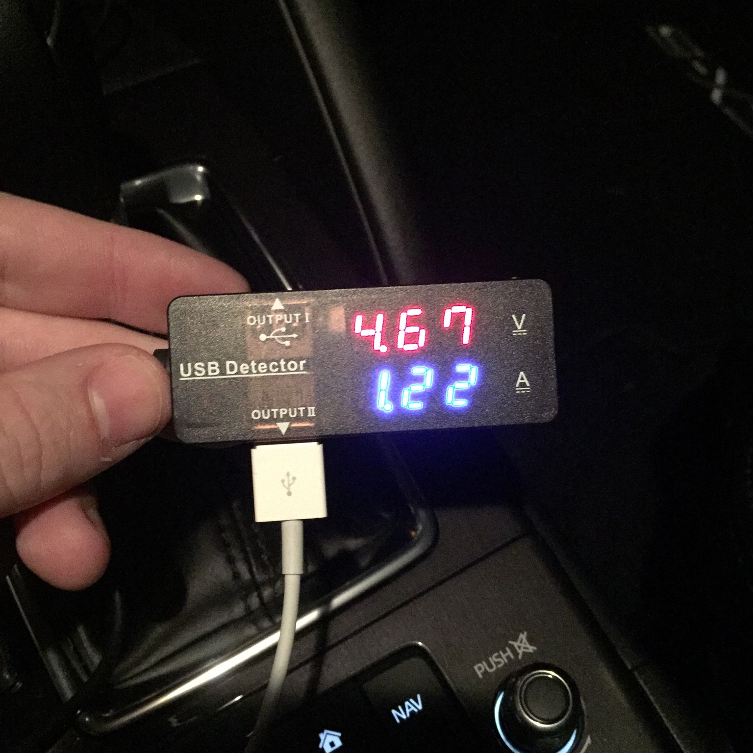

So I picked up a USB power meter and did some testing on a 2016 CX-5 GT. It's pretty interesting, I'm unsure why the port in the car doesn't charge as quickly as we expect it to. All testing was using an iPhone 6+
In this first photo you can see the factory USB ports put out about 1A. It didn't matter which port, they both supplied the same amperage.

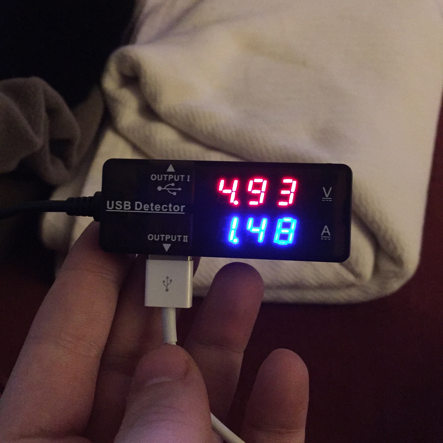

The second photo is with the Y adapter that I spoke about earlier. I expected the amperage to almost double, but as you can see its a minimal increase.

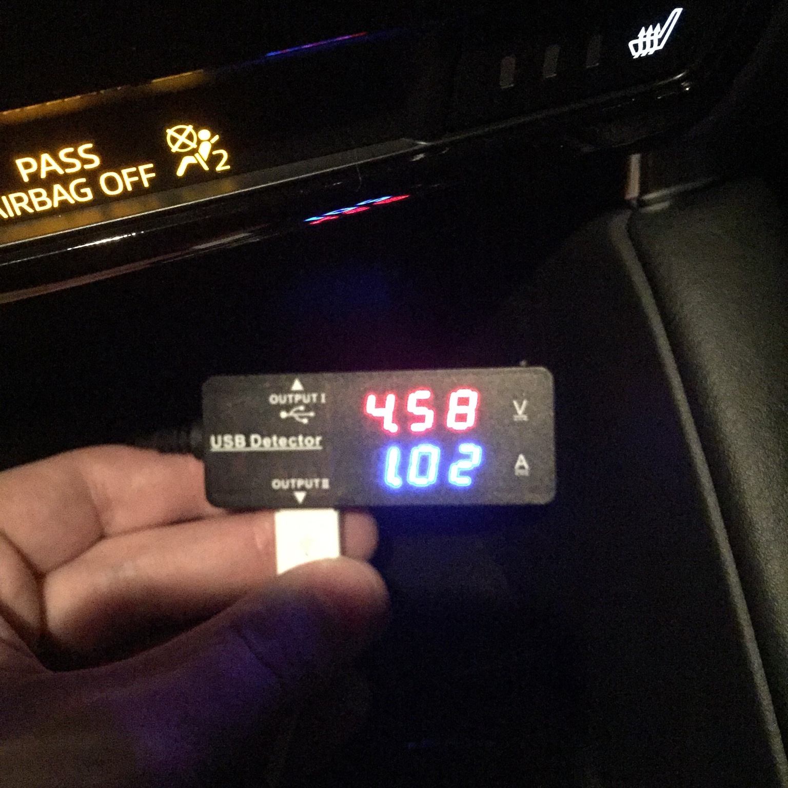

The third photo is to show you what a 2015 MacBook Pro Retina puts out with its "high powered" USB 3.0 ports.

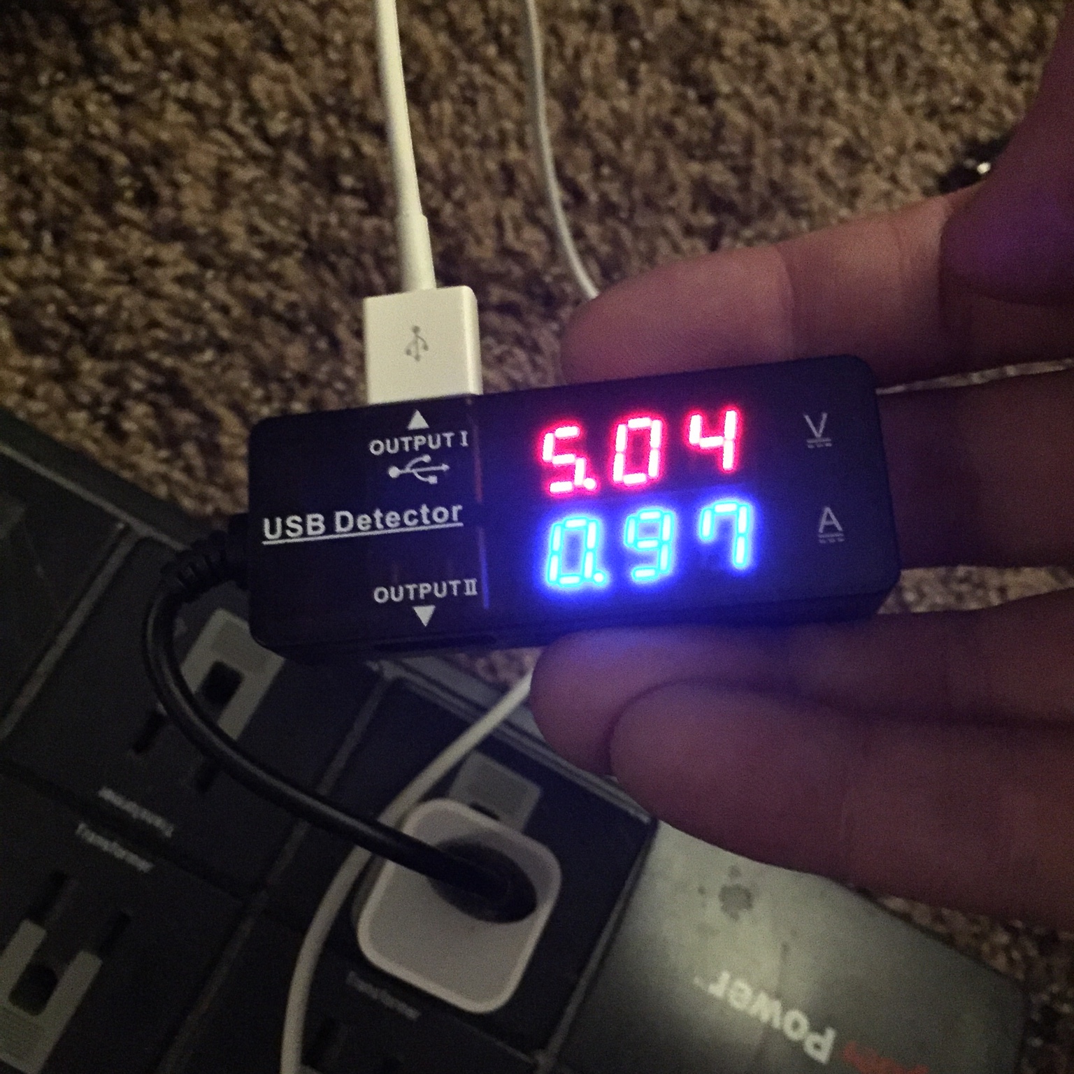

This final photo shows what the Apple supplied charging block provides.
The Last photo is really throwing me off, the Mazda puts out more amperage but charges slower.

Thanks for the great info! I've also noticed the 2016 ports charge an iPhone 6 plus very slowly. One thing though is that the current meter shows the total current draw, which maybe different from the charge current draw. When the iPhone is plugged in it may be drawing some current to establish communication with the car. So the actual charge current draw maybe less than what you measured. Just a guess.

So the 12w charger and the the Scosche dual USB (5amp Max each) both provide 1.0a to an iPhone 6+. At this point i definitely feel like the iPhone dictates what i needs and pulls that. Also, i noticed this morning that my power meter has 2 different ports. Power only and Data+Power. the data+power side only provides 0.5A, even with that Y adapter attached. Someone earlier in the threat said that may happen, interesting to actually see it happen. I've come to the conclusion that the ports are sufficient enough to prevent the phone from draining when using Waze with the screen on, but don't expect any increase in your charge. I'm going to keep using it this way for now, and use the center console port when an emergency charge is need. Probably not that often is my 6+ could last 2 days if needed.

Not really. Look at the voltage readings. Charge rate is a function of amperage x voltage.
Were the measurements taken at idle, while driving or with the engine off? It also matters whether certain high draw electrical components are on/off.
