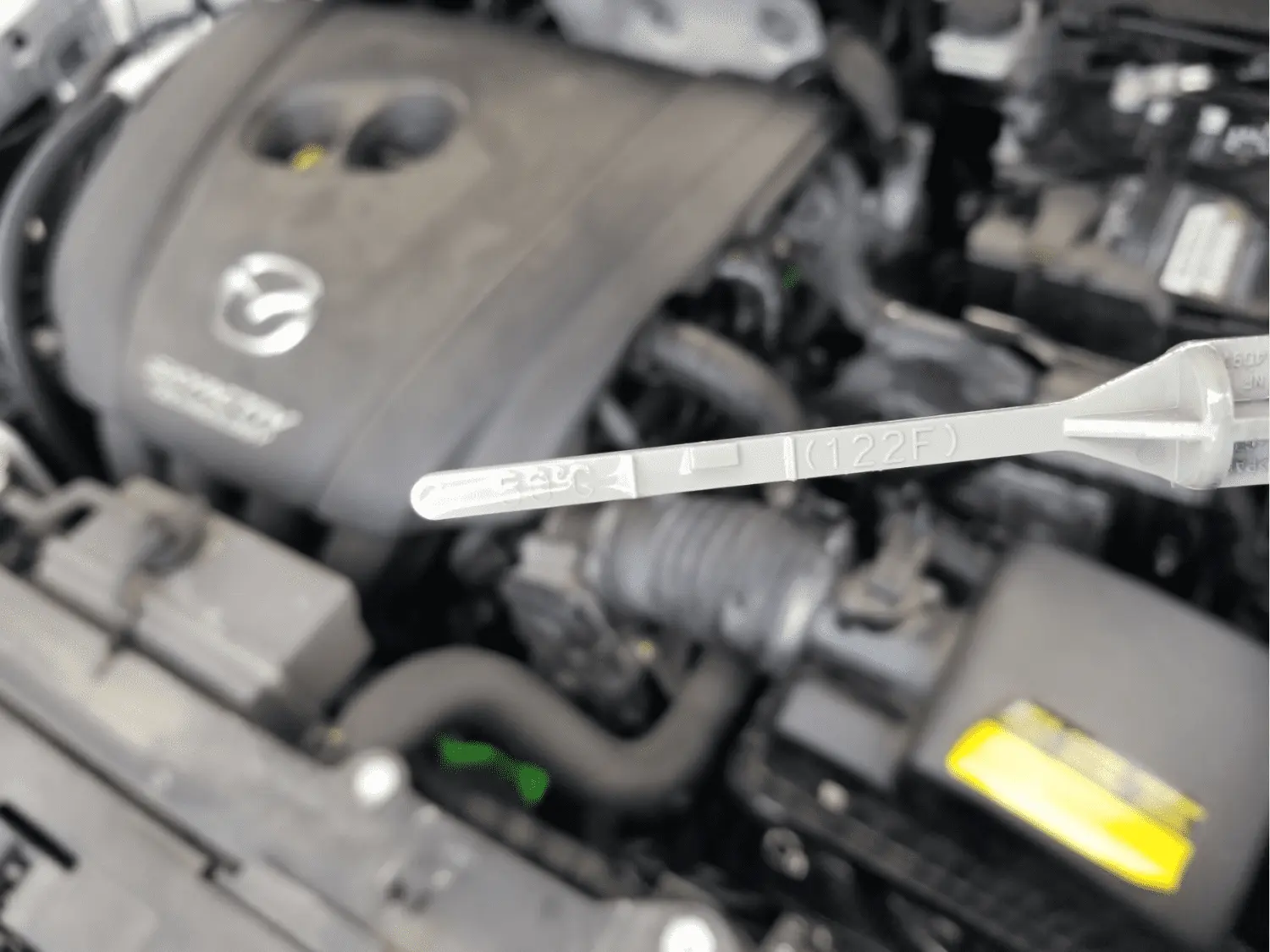

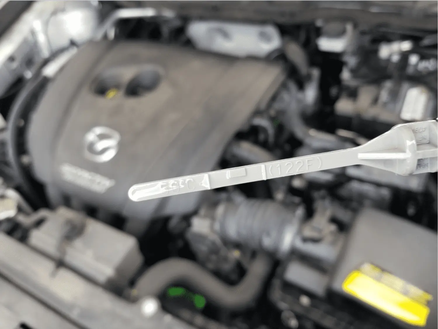

  2. I used about (3) different OBD II tools and I still couldn't see the ATF Temps on Torque Pro so I don't know if it's something wrong with my car or if these OBD II readers just don't have the sensors built in. I did check the sensors in the adapter settings as well and they were not listed so I'm guessing the only way to see the actual ATF temps is by using an expensive bidirectional scanner or having the Mazda IDS software.

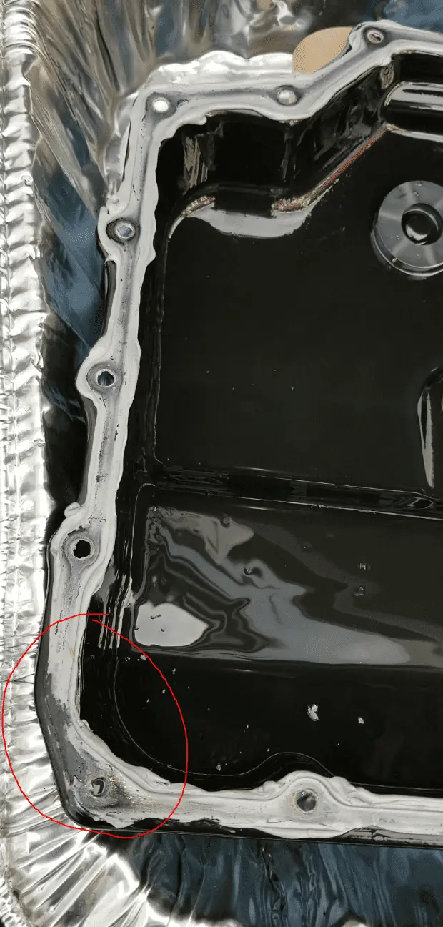

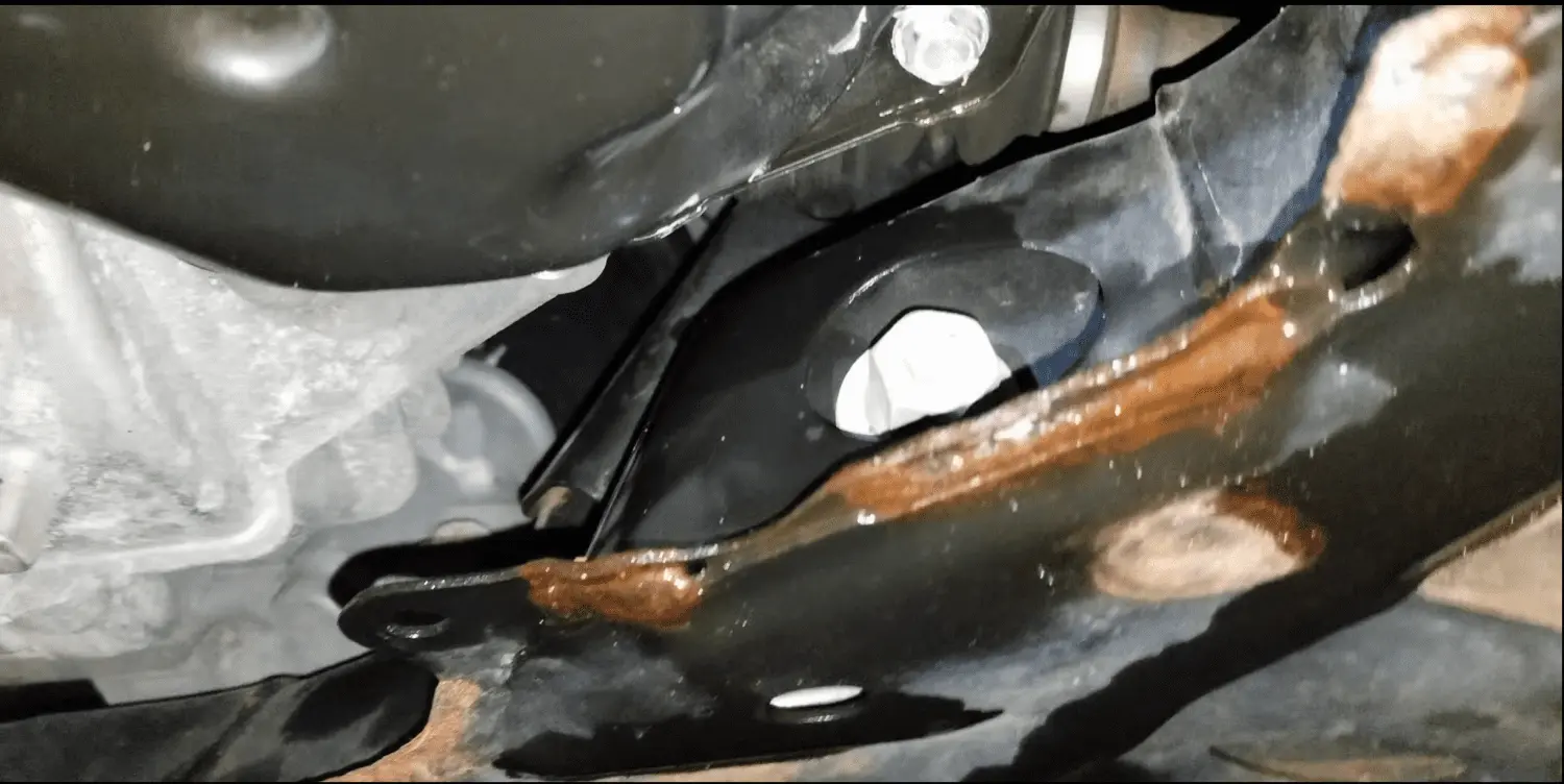

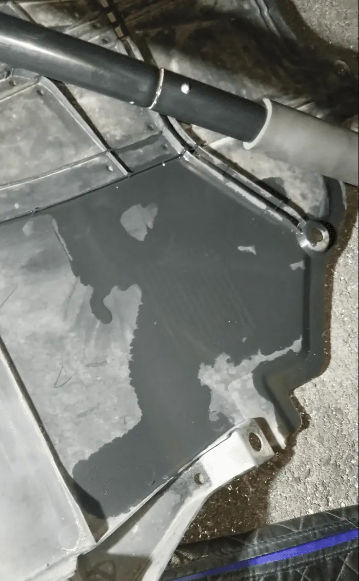

So it looks like I messed up the RTV application process and the ATF FZ is leaking out from the corner. I noticed a puddle when I decided to inspect the bottom of the vehicle just to double check. I guess I'll be redoing the RTV after all, but I'm going to use the Permatex Automatic Transmission RTV Sealant (3 oz.).
Yes, switch to a different RTV. And try to follow the procedure from Mazda FSM.

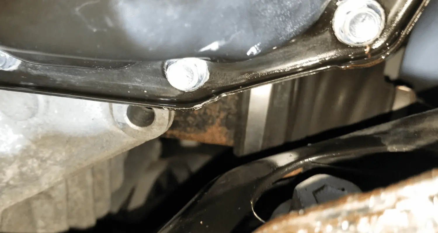

I think the reason why my pan was leaking at the corner may have to do with the fact that I either:
  1. Didn't apply enough RTV at that area
  2. Smudged the RTV against the underbody mounting surface by accident
#2 seems the most likely though but I'll definitely apply more than I did before just to be certain. Also, given that I don't have time constraints, I can take my time and carefully go around all of the bolts

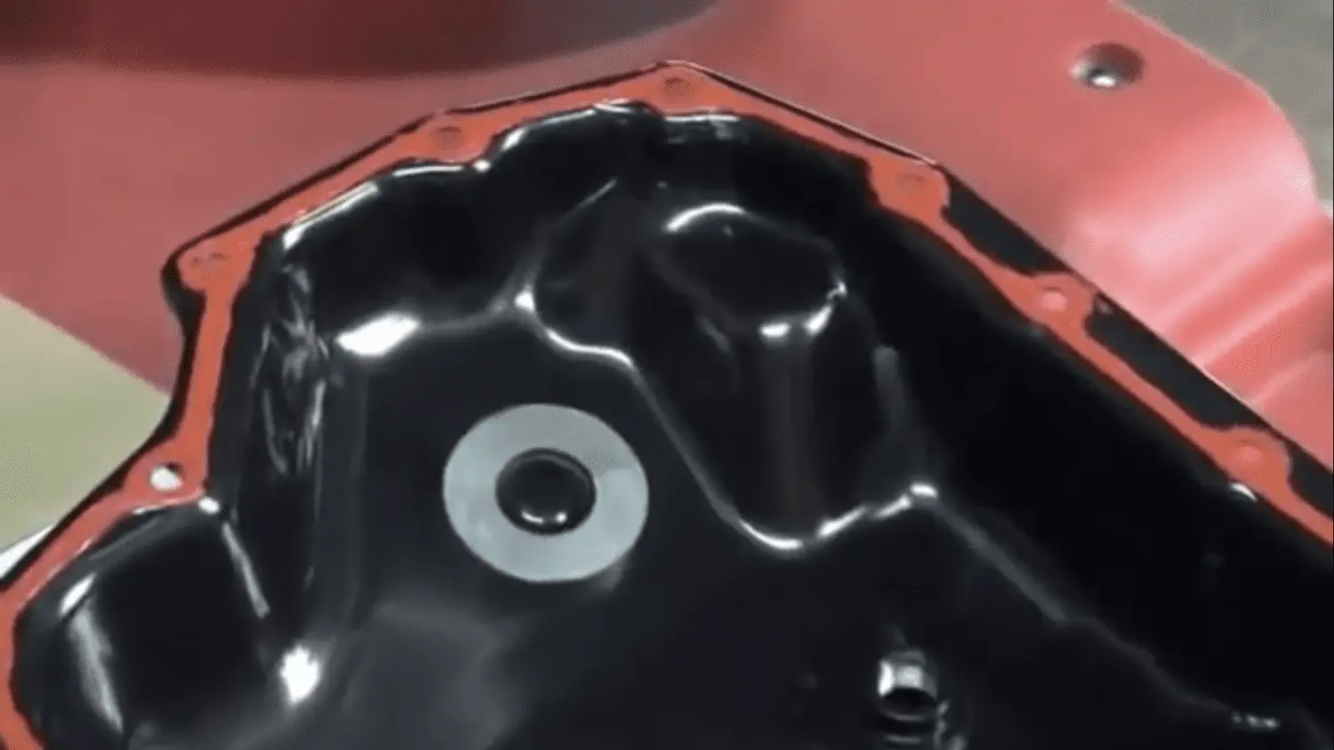

I think this video below does a good job in showing how it's done.

IMO, your leak is caused by wrong type of RTV been used, especially yours is a fast-drying one. Looks like Permatex Automatic Transmission RTV Sealant should be a better choice than Permatex® the Right Stuff® 1 Minute Gasket™ GREY Gasket Maker. As far as on applying method, I personally would prefer method #3 you mentioned above. Also, clean any old silicone sealant, which should be a bit easier since it’s fresh. And degrease the sealant area on the contact surface of the transaxle case and oil pan.

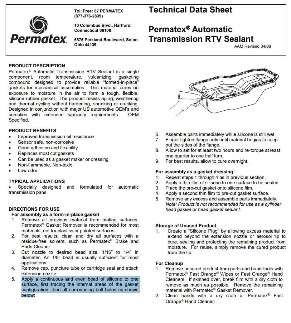

Fyi my experience with the transmission rtv was difficult. It was hard to squeeze out, so one continuous bead was not possible for me. My advise is to lay quarter inch bead as far as you can and if you stop, just overlap and continue. Any location that might look too thin, just glob on top.
You are honestly 100% correct about the RTV being extremely hard to apply. I just used the non-c02 powered one and it was a PITA. It requires someone with vise grip fingers in order to squeeze it out as my fingers were going numb. I went over some areas twice and I went back and put more on top.

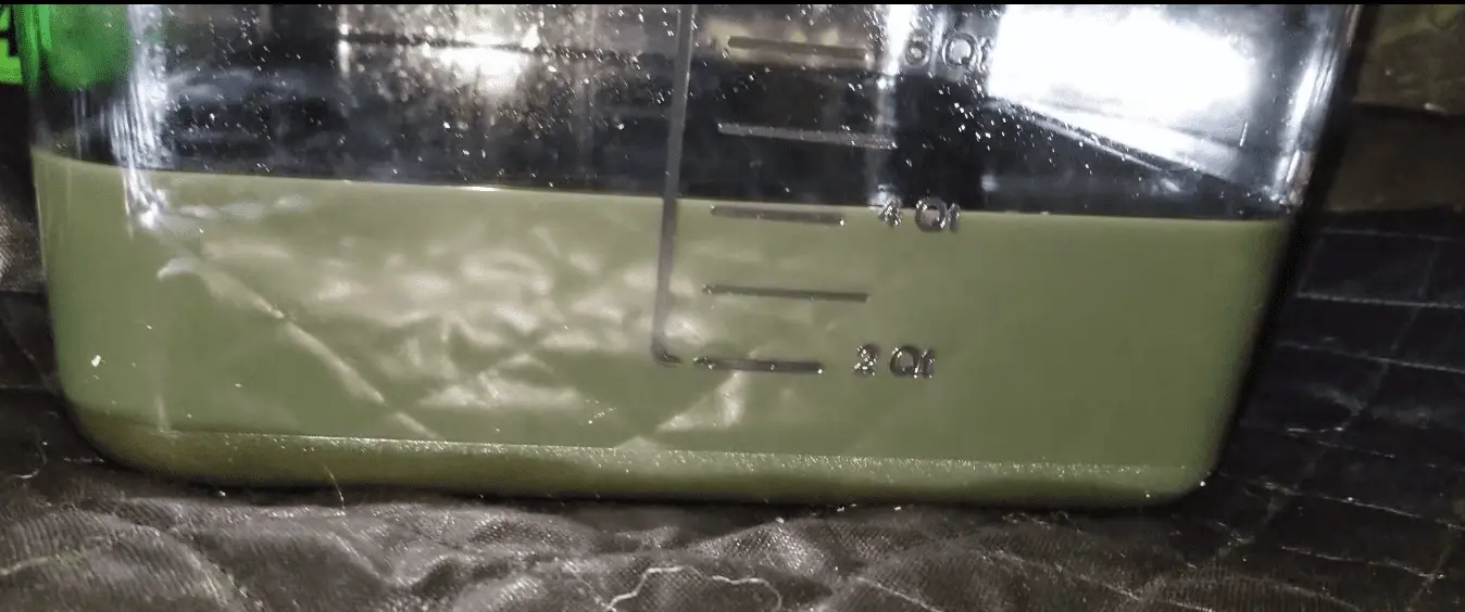

9/28:

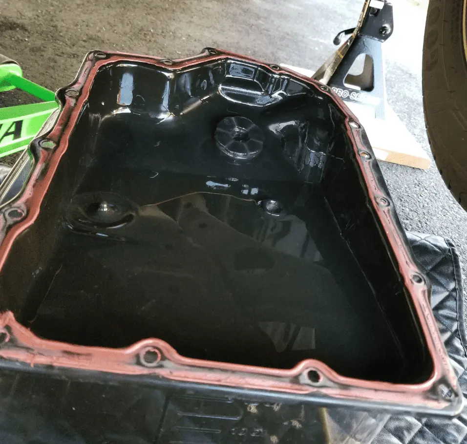

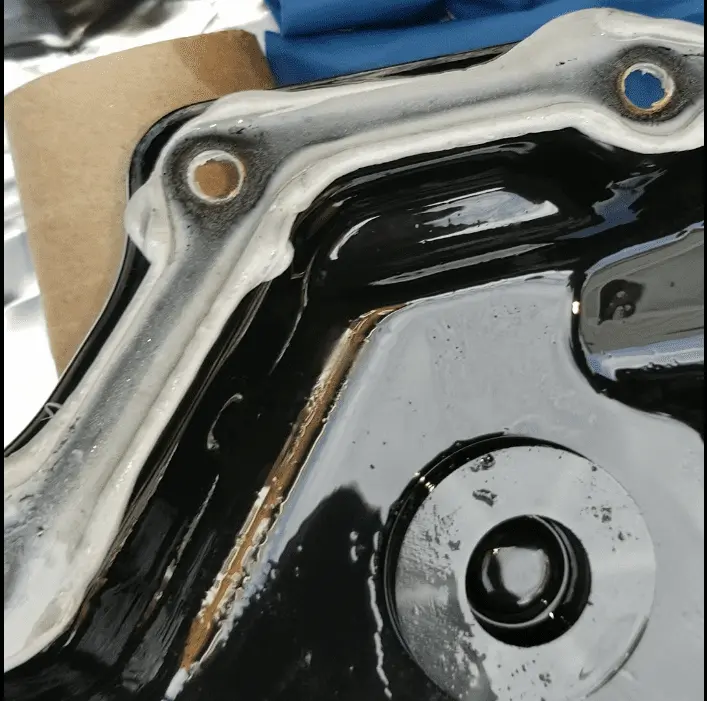

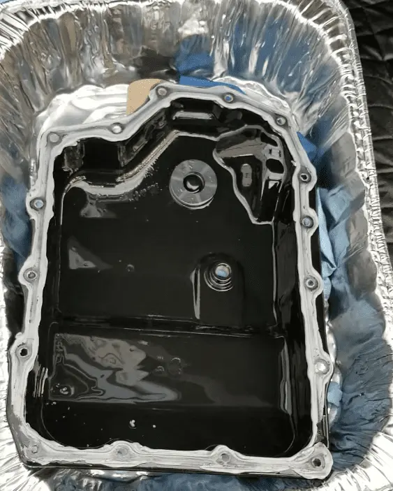

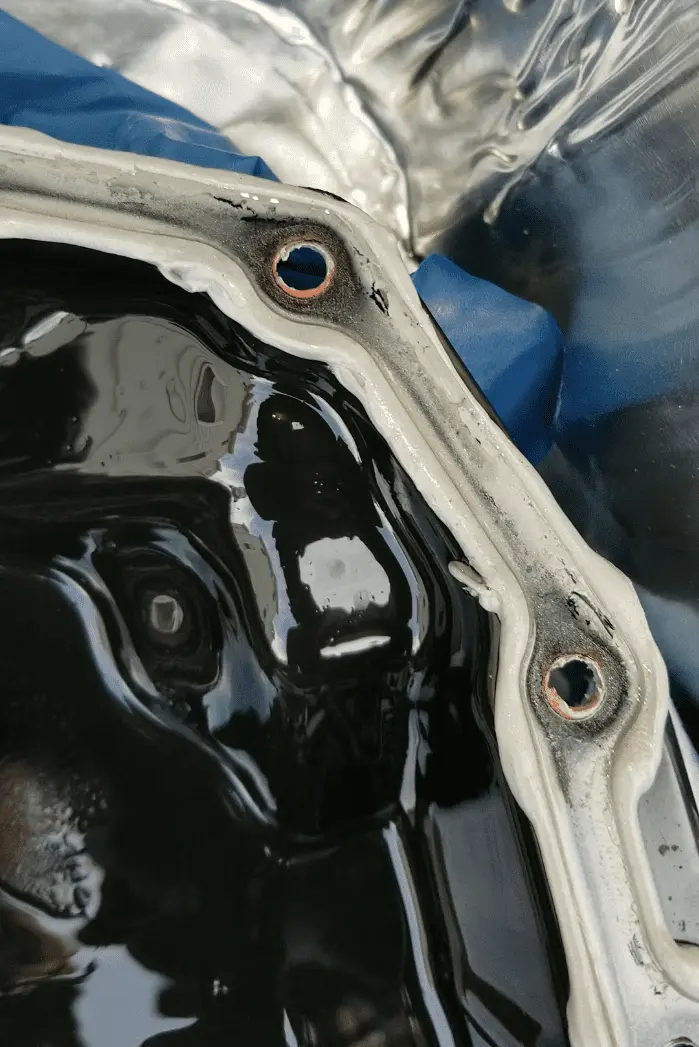

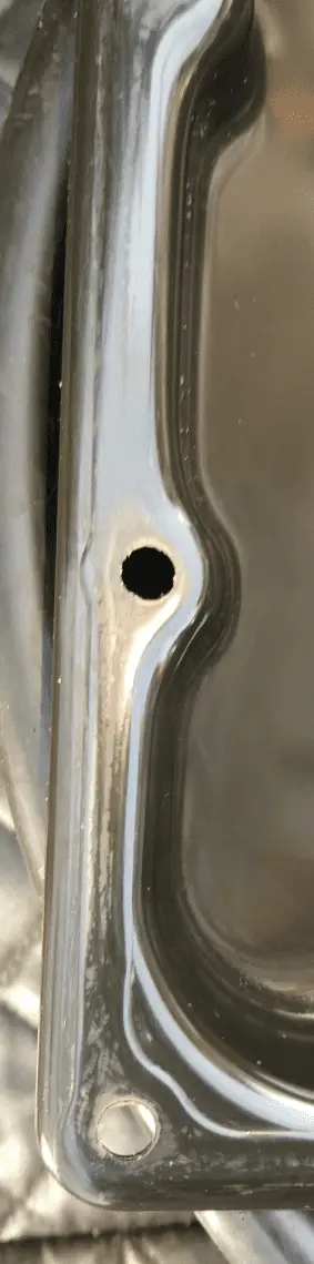

So after taking apart the pan, I honestly don't even see anything wrong with the way I applied the RTV. Everything seems fine in my opinion as the RTV made its way all around. In fact, I would say that I did a way better job the first time applying the RTV two days ago than I did today with the Permatex Automatic Transmission RTV since it came out at a much more consistent and even pace and I didn't need to squeeze for dear life to get even a tiny bit out. Honestly, the only thing that I can think of is that the RTV got stuck on the tip of the new bolts and this caused the room to be taken up and then the bolt did not fully compress all the way into the hole.
In addition, somehow (6) quarts of fluid came out instead of the usual (5) quarts for the pan drop. I'm not sure if it's because I drained it last night and came back this morning and opened the plug again + dropped the pan but there is definitely (6) quarts, not including the amount that leaked out on my driveway.
This article honestly illustrates what I am talking about perfectly if anyone wants to have a read.
Transmission pan leaks

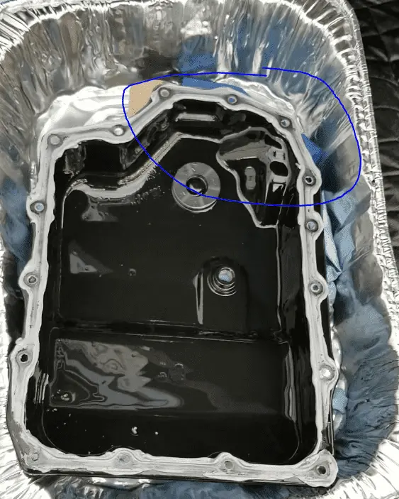

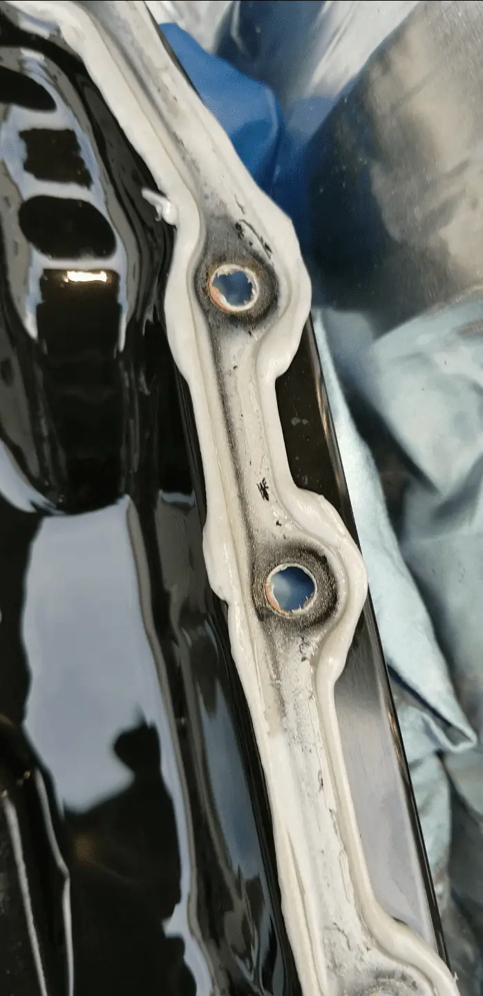

For the second time, I cleaned up the bolts with all that extra RTV but I probably still made the same mistake of contacting the RTV on top of the bolts. It was getting extremely late and I had to start putting it all back together as I did not want the transmission to be exposed to the elements any longer due to being already open during the rain. I did not take any pictures since it was dark outside and I did apply a thicker layer on the transmission pan and also, I rubbed some RTV on the mating surface this time. So in about 48 hours, I'll post an update and let you guys know everything goes.

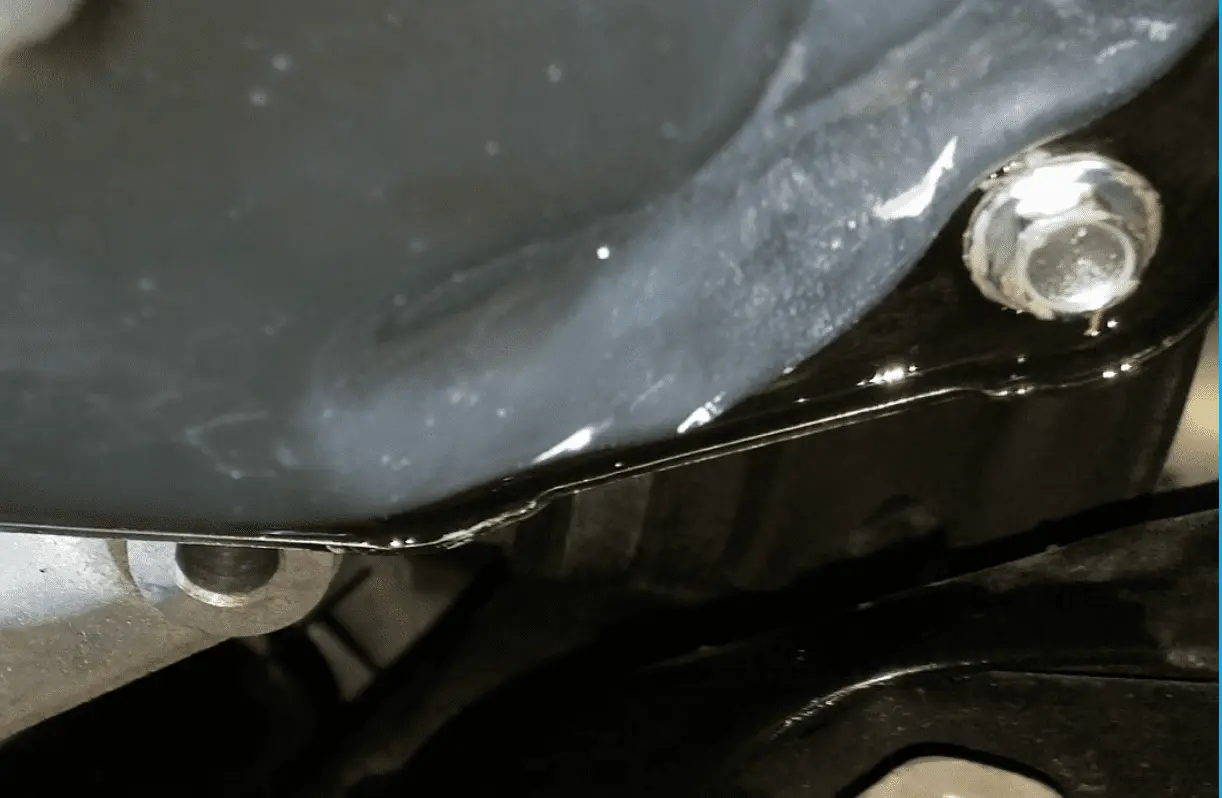

Funny thing is, this area in red that seemed to have a light amount did not leak at all.
The area in blue is where the ATF FZ was leaking from and if you look at the RTV, there is no breaks so the only conclusion I can come up with is that the bolts on that area had extra RTV on the top of it which made the bolts not compress all the way in.

there's lots of dried RTV in the screw holes. did you degrease the surfaces before applying?
Yes, I don't think its's due to not degreasing it but probably because I only had a limited amount of time to apply the right stuff (dries in 5 minutes) and I had to put everything back together immediately. The bolts most likely contacted the RTV when I was installing it and caused the RTV to compress inside of the bolt hole.

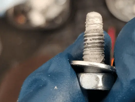

I had a few questions for anyone that can answer. So let's say that the RTV is already cured and I see some leaks on the floor still:
1. If it's caused by the RTV being stuck on the bolts still, would I be able to clean the bolts off and then torque to spec or is it too late since the RTV is already cured?
2. If you take the bolt off on one side, would it compromise the integrity of the RTV?
Thanks again for the update.
IMHO the problem of your leak most likely is the degreasing the sealant area on the contact surface of the transaxle case and oil pan. The reason by comparing your ATF pan taken faience with factory RTV, and the pan with Permatex® the Right Stuff® 1 Minute Gasket™ GREY Gasket Maker:
We can see the Permatex® the Right Stuff® does sealed every area properly including the leaking corner evidenced by the sign of metal-to-metal contact is made. I don’t believe the extra RTV pushed into the bolt hole would cause the bolt couldn’t be seated properly.

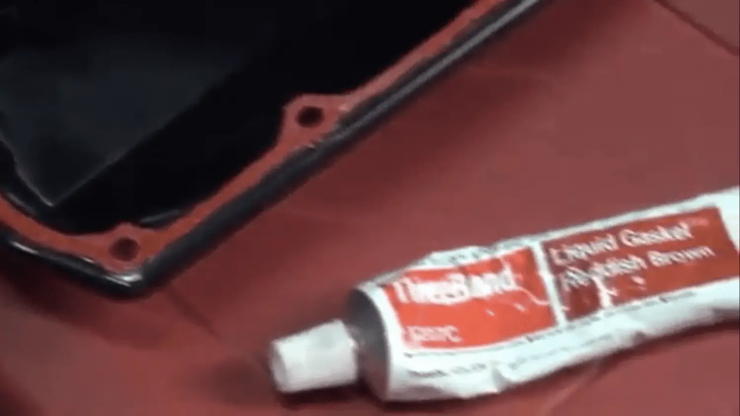

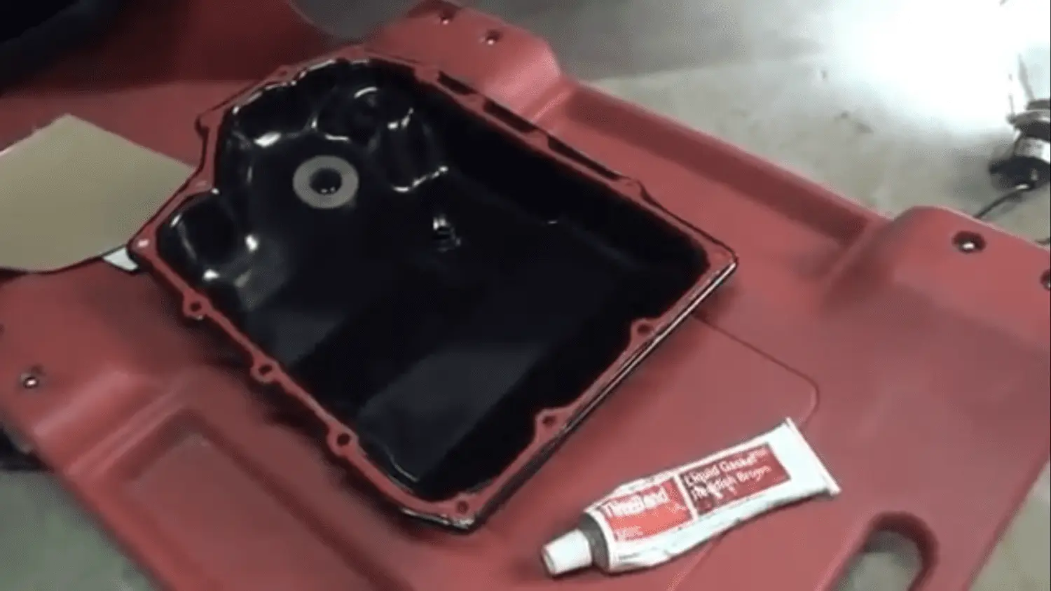

May be I should try ThreeBond 1207C Liquid Gasket Reddish Brown or OEM RTV as it looks like more easily to apply? (Or could be the guy in the video has good art skill?)
6 quarts of ATF with pan drop was also reported by Boland01. So 5 ~ 6 quarts of ATF with pan drop is needed.

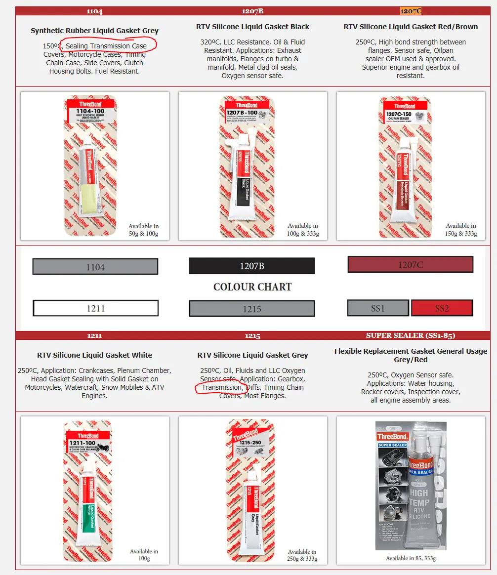

On the official Three Bond website, the spec sheet doesn't list "Transmission" under 1207C. I think Three Bond 1215 is the one you're looking for but I could be wrong since the guy in the video is using 1207C.
Honestly, I have no idea on other brands as I've only used Permatex so far. Maybe other brands may have better consistency when being applied. Only way to find out is to test it but there's no denying that guy definitely has good skill :D
https://www.threebond.com.au/liquid-gaskets.html

Here's a compiled list of probable causes that could've caused the pan to leak based on what I think happened.
  1. Extra RTV on top of the bolts around the corner allowing an extra gap for the ATF FZ fluid to spill out.
  2. Not tightening & torqueing the bolts before the 5 minute mark and by the time it was tightened, the RTV hardened up and did not become effective.
  3. ATF FZ fluid may have dripped onto the newly applied RTV while I was attempting to re-install the pan rendering the RTV ineffective/not curing.
  4. Not enough RTV being applied to the surface causing a small gap.
  5. Not waiting 24 hours for the cure time before pouring in new ATF FZ fluid
  6. Pan was moved during the installation process
  7. Did not smear a layer of RTV onto the mating surface

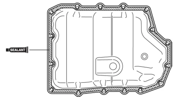

Look at the RTV diagram posted. The bead runs on the inside of the screw holes only, not completely surrounding them. Could that be an issue?

I took a look again at the picture of the Three Bond. It doesn't look like he used the continuous "bead" method but the "smear" method. Reason being that the lines look too perfect so it looks like he just traced the pans lines using his fingers. For example, in the below picture, there is no RTV but you can see the indentations.
I don't know if that would be a cause for concern but I would think having RTV around the bolt holes would provide additional coverage when it is being compressed. For the second time I applied the RTV last night, I didn't go on the outer edges of the bolt holes. I simply remained on the inner portion of the bolt holes so hopefully it makes a difference. I mean the Permatex TDS recommends to apply around the bolt holes but in the diagram from Mazda, they skipped the outer portion...
