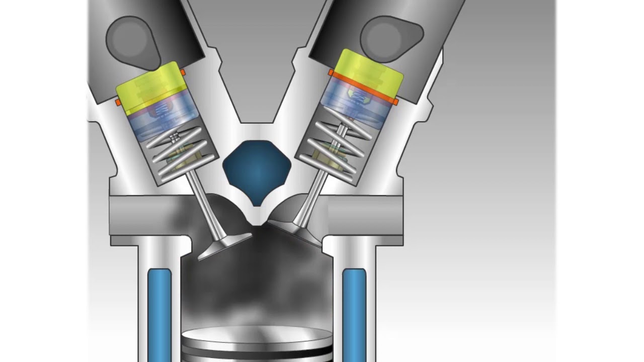

Sounds like hydraulic lifter tappet noise.

Good for you in providing a video. I personally would monitor that and see if it develops. You’ve done exactly what I would do as an experienced mechanic. I think it’s probably a noisy lifter so it’s going to be head strip down to sort it and it may well run like that indefinitely. You know what to listen for so just be aware of it. If it’s perfect when warm I doubt it will take any harm.
I agree Anchorman, back in the old days (LOL) a can of Marvel Mystery Oil in the sump (or some swore by ATF) to try to quiet noisy lifters. The oils weren't as good then. Probably due to gunked up lifters due to infrequent oil changes. It's when the noise doesn't disappear when warm is when it gets concerning.
