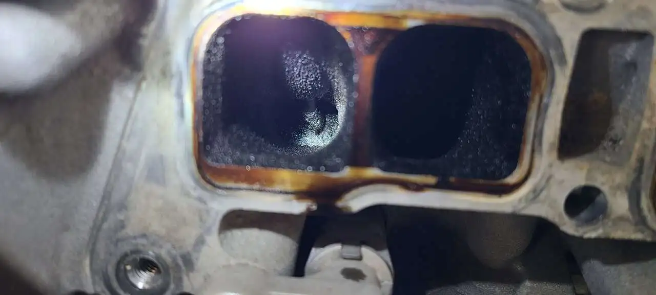

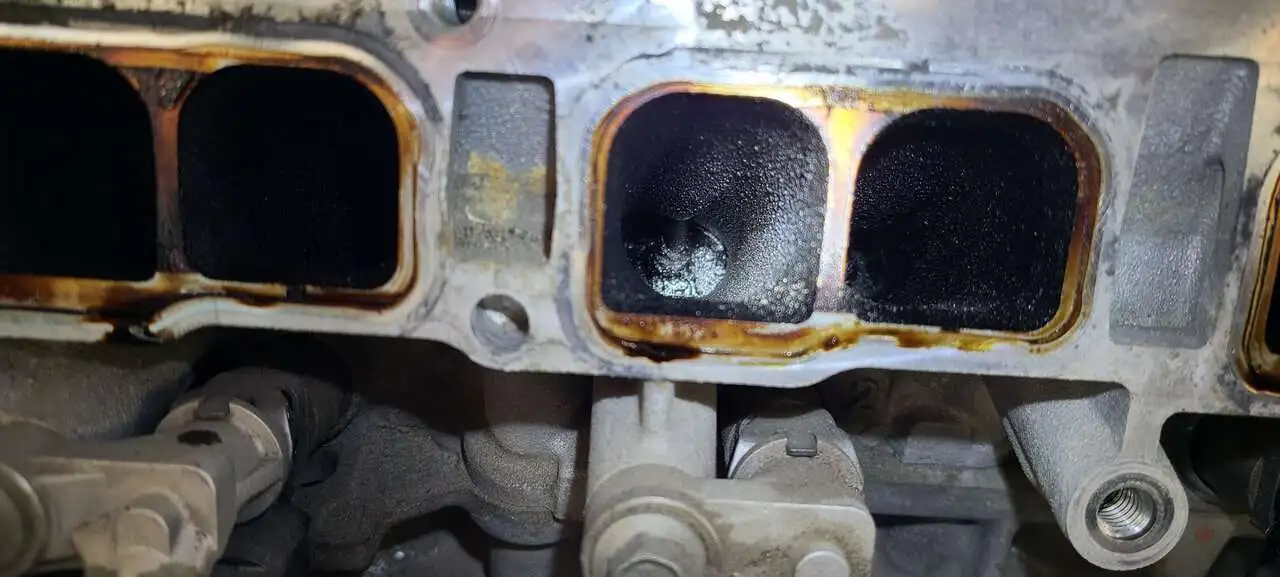

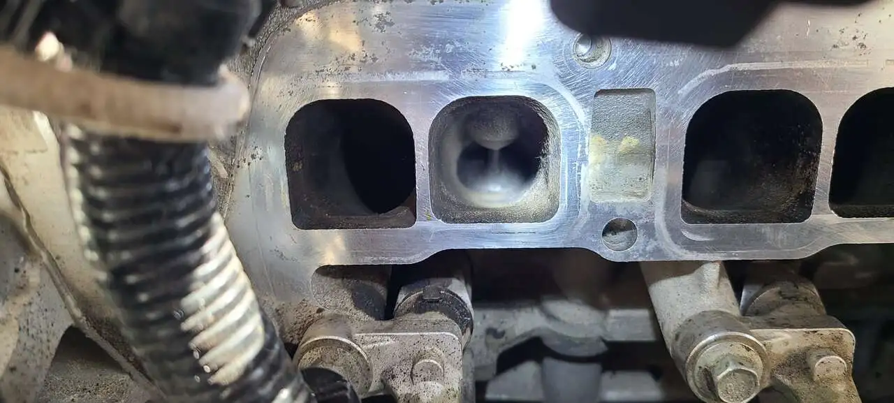

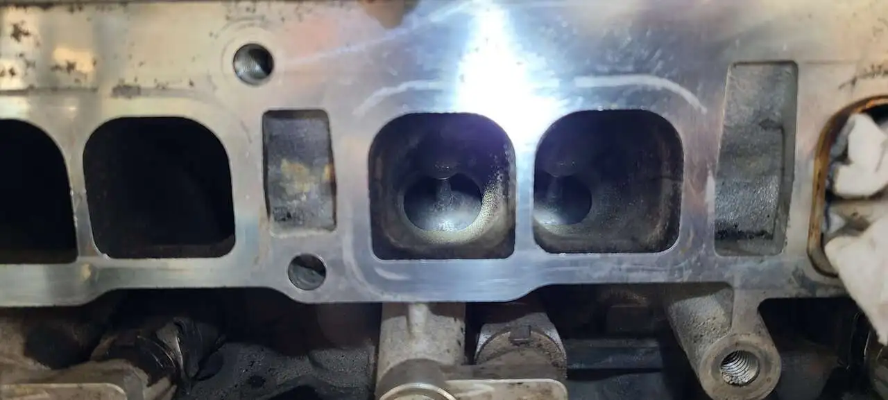

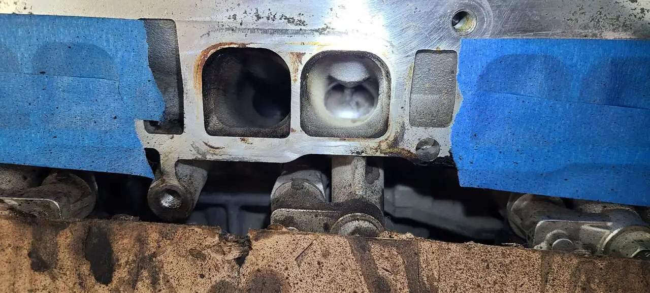

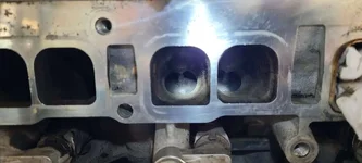

Well, I tackled the big job of cleaning the intake valves today. Boy they sure were nasty 188,000km's
Car runs like an absolute dream now. No more missing and stuttering on cold starts. Seems to have a little more throttle response now too. Guess time will tell how much better the fuel mileage will get. Not a hard job at all, just time consuming and lots of scrubbing. Just presoaked the valves with carb cleaner and used the zip tie method in my drill and some nylon brushes that fit in my drill as well. The key is to soak them real good and then the hard carbon turns to goo. I just cut up a whole bunch of small rags that i jammed in down to the bottom with a screwdriver to soak all the carbon up and it worked pretty well. Took me about 6.5 hours from start to finish. I see why walnut blasting would be the preferred quicker and easier method though. If I had to do this more than once in awhile I would get one.
