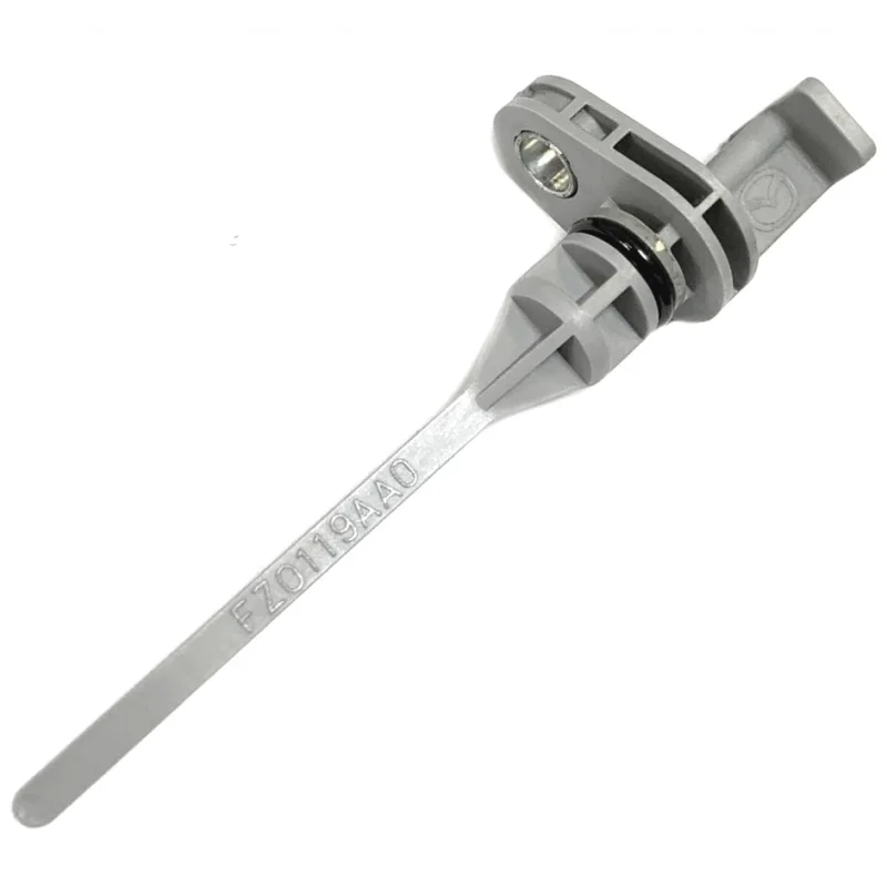

Dipstick PN: FZ0119AA0
so looking at the stick it seems the oring goes into the hole. I always thought its gasket that sits on top of the hole. Thay may be tricky , its likely swollen too and stuck.
If you still decide to try - Have to pry from at least two sides (as close to the oring as possible and not from the top handle ) to minimize the pressure point. And dont use metal for prying.

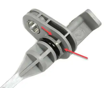

Thanks for the pictures! I'm looking at where the arrows are and I'm dismayed there is a gap and not solid plastic there. If I used a pry tool, it could break the plastic. On my 20 year old Volvo, plastic engine parts explode when you touch them. Mazdas should be better though.

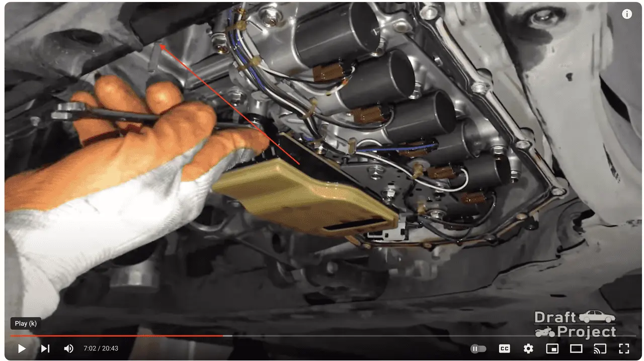

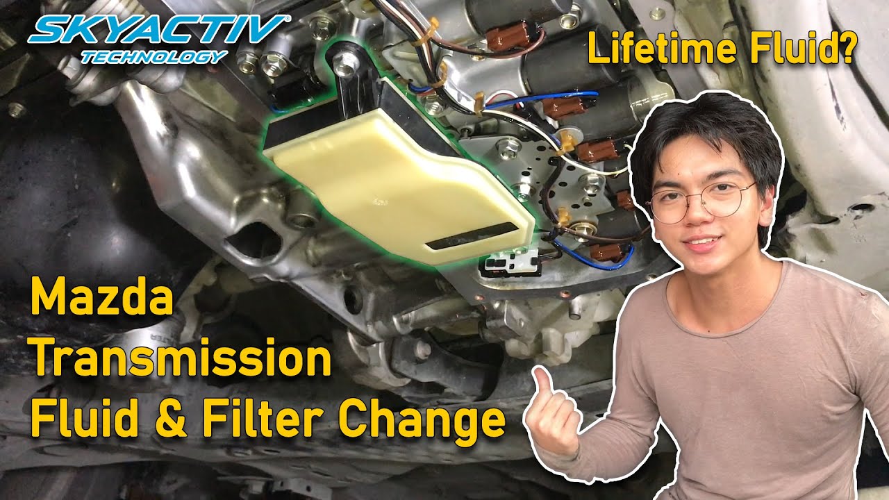

The option with dropping then pan may be better for your use case.
I don't know what access looks like, but if I were going to apply force, I do from one of these places. Not in the gaps just above the O-ring.
The part looks injection molded. Liquified plastic gets shaped by a mold and then cools and hardens. If the area pointed out above were solid plastic, it would cool slower than the rest of the part and deform the shape as other areas become rigid and it is still hot and flexible.
