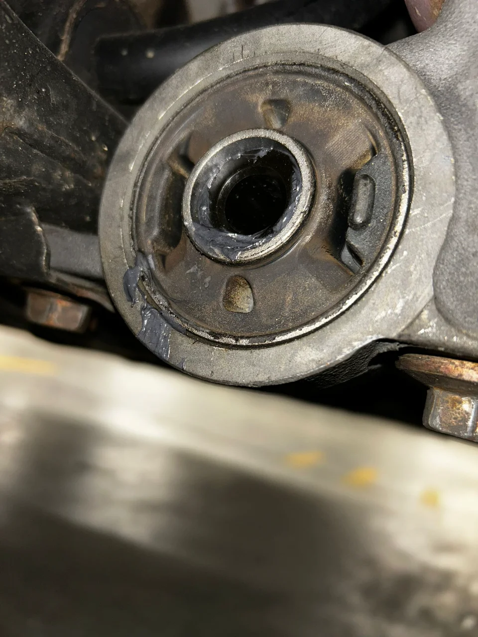

My 2014 CX-5 has been making clicking or knocking sounds on front passenger side - brand new shocks and struts but sound still there .. took a picture of my LCA bushings and noticed some weird grease but these aren't liquid filled right?
Also what do you guys think of the condition? Could this be the cause of the sound or should I look elsewhere? Tire rods were solid and same with the ball joint and CV axle

The LCA bushings are solid rubber, not liquid-filled. Maybe a tech greased that point sometime.

As the bushing looks good on the LCA picture you posted, I wouldn't be in any hurry to replace it. It looks like it's been replaced already with an aftermarket one.
Was the CV axle you replaced leaking grease and slinging grease around? I didn't see any mention if it was. I'm still curious about the grease on the LCA bushing.
I didn't see any grease flying around.. I am also curious about that! Where else could it come from? Unless someone tried to grease it when installing it?

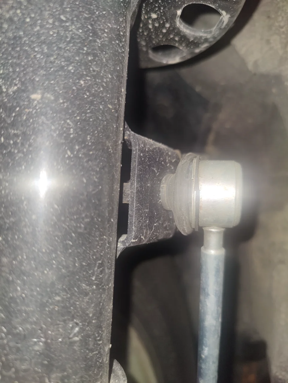

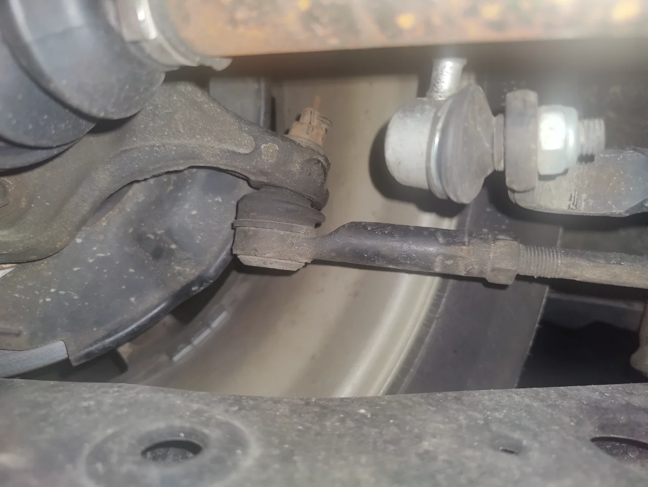

Do the sway bar end links look bad here?

Those look fine to me, but you can't necessarily tell from pictures. Grab hold of the ends and see if there's any free play. In fact, if I were you, I'd also jack up that corner and grab the wheel itself. Jerk it back and forth vertically and horizontally and see if it moves/clicks. If it does, go from there and see what's allowing it to do so.
As mentioned above, you can't go strictly by looks. Grab each end and push and pull it in and out as well as vertically along the axis of the rod . This is done jacked up with the wheel hanging free to relieve tension on the link. Going by all of the pictures you've posted, along with the lower control arms looking like they've been replaced with aftermarket, these end links look to have been replaced also. I'm guessing you acquired this CX-5 used so you're not aware of which parts have already been replaced.
Yes I bought it used.. is it bad that these parts have been replaced with aftermarket? I'm just worried that every time I take it to a mechanic they replace parts to no end without figuring out where the noise is coming from
No, it's not necessarily bad because they are aftermarket parts. Aftermarket doesn't automatically mean poor quality and OEM Mazda parts are expensive. So don't fret about it because they most likely needed it so it's a good thing. In fact some of the aftermarket control arms have thicker, beefier bushings. The lower control arms and end links were replaced before/by 60,000 miles on my 2014. Mazda has had issues with the bushings in the lower control arms and has gone through several iterations of them. Now the challenge is to find the source of your car's noise.
