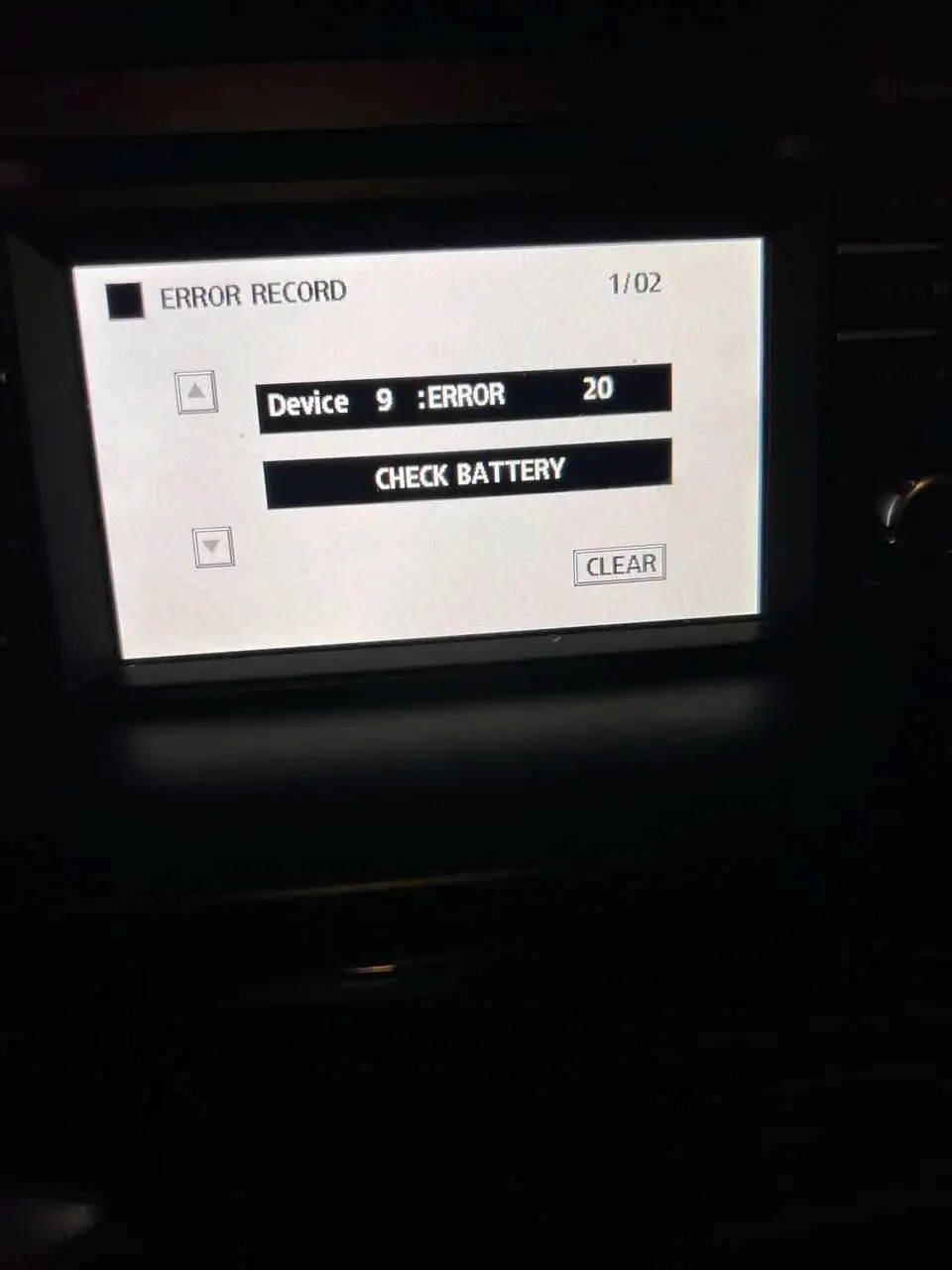

I was able to pull up some kind of diagnostic screen by messing with button combinations, and found some kind of error record showing:
device 9 error 20 check battery
This message was indicted for both show errors (i.e. 1/02) See attached photo.
The closest Mazda dealership is a good distance away, and frankly if this is just going to be a matter of replacing the stereo, I'm inclined to go aftermarket and upgrade versus paying premium for stock Mazda.
Anyone have ideas on what the cause could be, knowing the above? Is the bluetooth module just shot?

Mazdas of that vintage has notoriously bad BT modules. Assuming that a bad module is indeed the issue (and it probably is), it's cheaper to get a new Kenwood, JVC, Alpine, Pioneer, or Sony than to get a replacement module (which will also eventually die).
The BT module on my 13 was dead when I got it. I replaced the radio with a Kenwood. Much nicer radio than stock, too. And now I even have Android Auto!

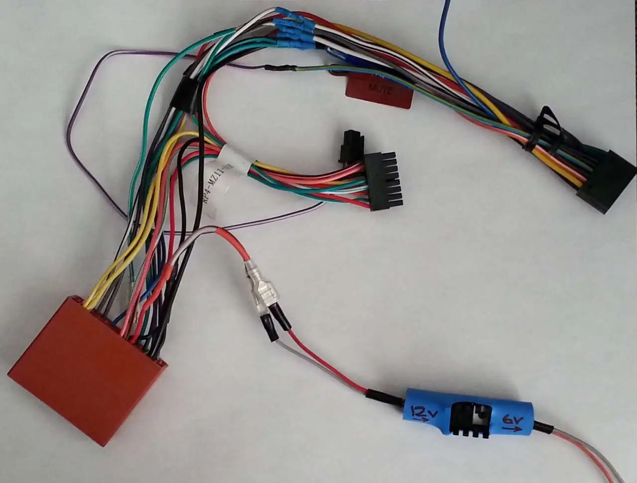

I did this on ours when we first got it (so ~9 yrs ago!). I reused the factory camera, but it requires a 6V power adapter (based on the attached pdf). Also attached is a pic of my adapter harness with the adapter included, and my wiring x-ref spreadsheet, .zip file renamed as .wav for posting (please don't ask more, 'cos it's way past my old age memory limit :) )

Thanks! This might be above my technical abilities but appreciate the insight. Did you have troubles with your bluetooth module as well or just wanted to upgrade?
Yeah, if you have a factory camera, use that one for sure. You'll just need the voltage adapter.
