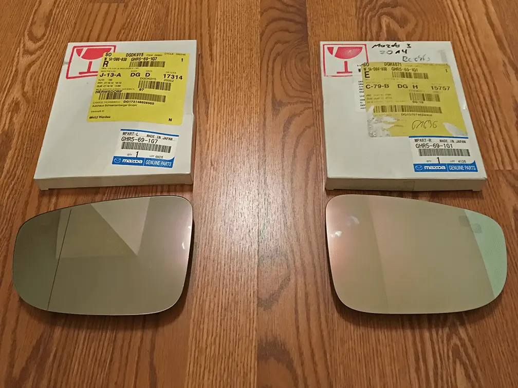

Costing a small fortune, I imported a pair of mirror glass from Germany. Really, the passenger side glass isn't really necessary because the USDM glass is also convex, except the EDM one has no silly warning label. I just chanced upon one on German ebay for "cheap", so...

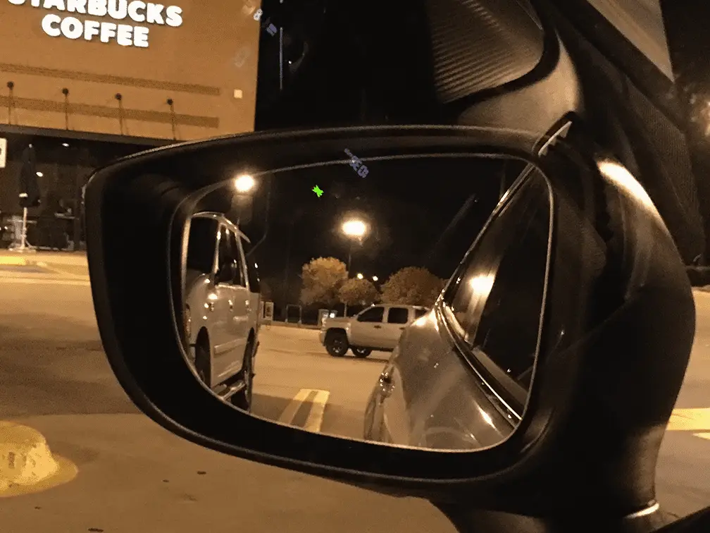

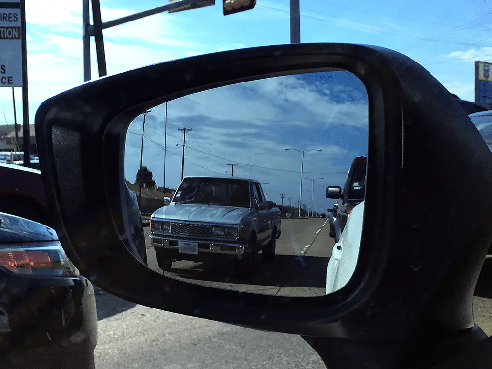

But, this pic should really show how much improved rearward visibility is. There's now zero blind spots when you are parallel to another car/traffic, and greatly reduced if you're at an angle.
attachment.php
The Acura on the left can be seen in the window AND barely in the mirror! The angle is so wide, I can adjust the mirror to both cover a bit of the side of the car (great for parking) and it still reflects the outer portion of the housing!

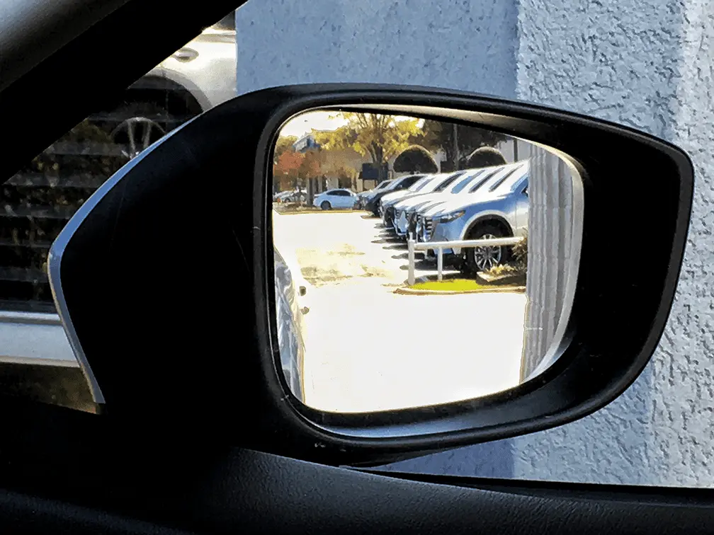

Meh, right side... no stupid "objects in mirror" warning label distraction

Installation is not quite as easy as it used to be with the older Mazdas. The mirrors are a frameless design. They are glued onto the plastic bracket/backer which means you have to be extra careful removing the original glass. The shop manual says to heat up the mirror with a hair dryer for both removal and installation, which is a good idea because the sockets are very tight fitting compared to the "genwon" (BK) and "genpu" (BL) ones. I believe this is by design as an anti-theft measure for some countries where mirror theft is high (such as Mexico). Even when heated up, removal and installation is not very easy as considerable amount of force is needed to pop these in/out, which can be a bit scary! (nailbyt)
For those interested in importing these (contact an importer/exporter, I can't help you), glass only part numbers:
Japan build (LHD)/Ishizaki Honten make
2014-2016 (BM):
Left with BSM, heated-- GHR5-69-1G7
Left without BSM, heated-- GHP9-69-1G7A
Left with BSM, non-heated-- G44P-69-1G7
Left without BSM, non-heated-- G44N-69-1G7
Right with BSM, heated-- GHR5-69-1G1
Right without BSM, heated-- GHP9-69-1G1
Right with BSM, non-heated-- G44P-69-1G1
Right without BSM, non-heated-- G44N-69-1G1
These are shared parts with the 3rd gen (GJ) Mazda6 and can be used with a 2014-2016 Mazda6. No auto dimming is available, at all as it is USDM only.
