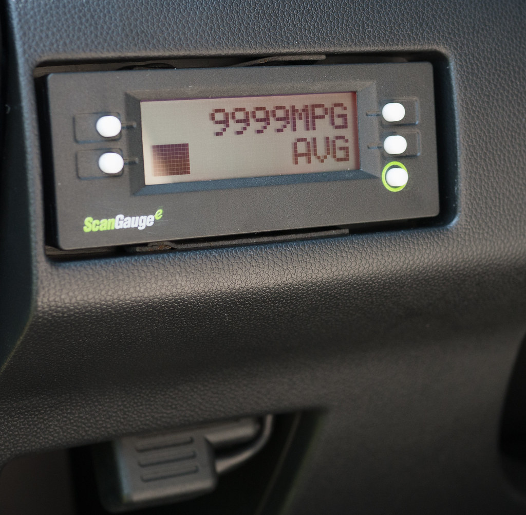

I just use a ScanGauge E for a trip computer

The ScanGauge looks like it was made for that opening! Nice!

The scangauge E is so much better a trip computer than the OEM its almost laughable, get one of those, install it as Tuanies did his and you will never miss the factory crap again. Just for starters the Scangauage has a user settable correction factor that over time means it is 100% accurate, as in down to a tenth of a gallon accurate which is something the OE trip meter can't do.

Taunies, Great job on finding a location to allow that Scangauge E to look factory installed. I have a 2013 sport so don't have any switches in use but thought when I looked up from below the dash saw some wires leading to the back of one of the false buttons (perhaps just securing an unused wire lead?). I was wondering if you needed to do any modifications to the dash to use the Scangauge E at the locations? Such as cutting out any plastic cross members that might be holding the false switch plates in? It is unclear if when all 4 false switch plates are removed if it will be 1 large opening or 4 smaller ones? I recall when I checked into purchasing a switch for that location from Mazda a few years ago (that I didn't end up doing) that the switch was held in with pressure tabs at the top and bottom, does that sound correct? Were they easy to remove? It has been a few years since you installed the scangauge, is it still working? Are you still happy with it? Is there anything you would do different?

I saw a DIY somewhere here but can't find it now. Once the switches are removed, it's one large opening with tabs that require some trimming, then I think the ScanGauge-E is a light press fit. I'm not sure if the trimming keeps you from being able to put the switches back in at a later date.
