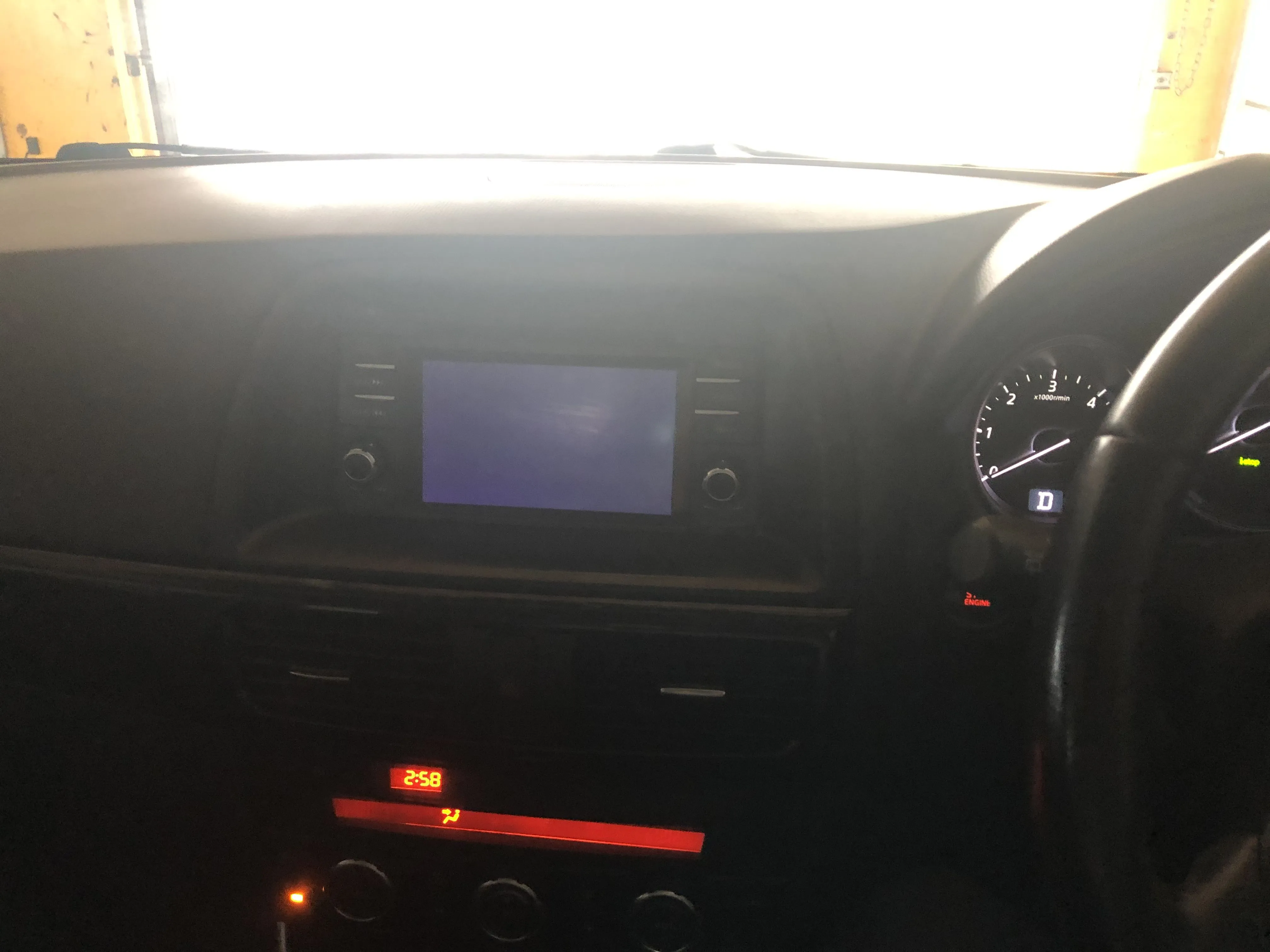

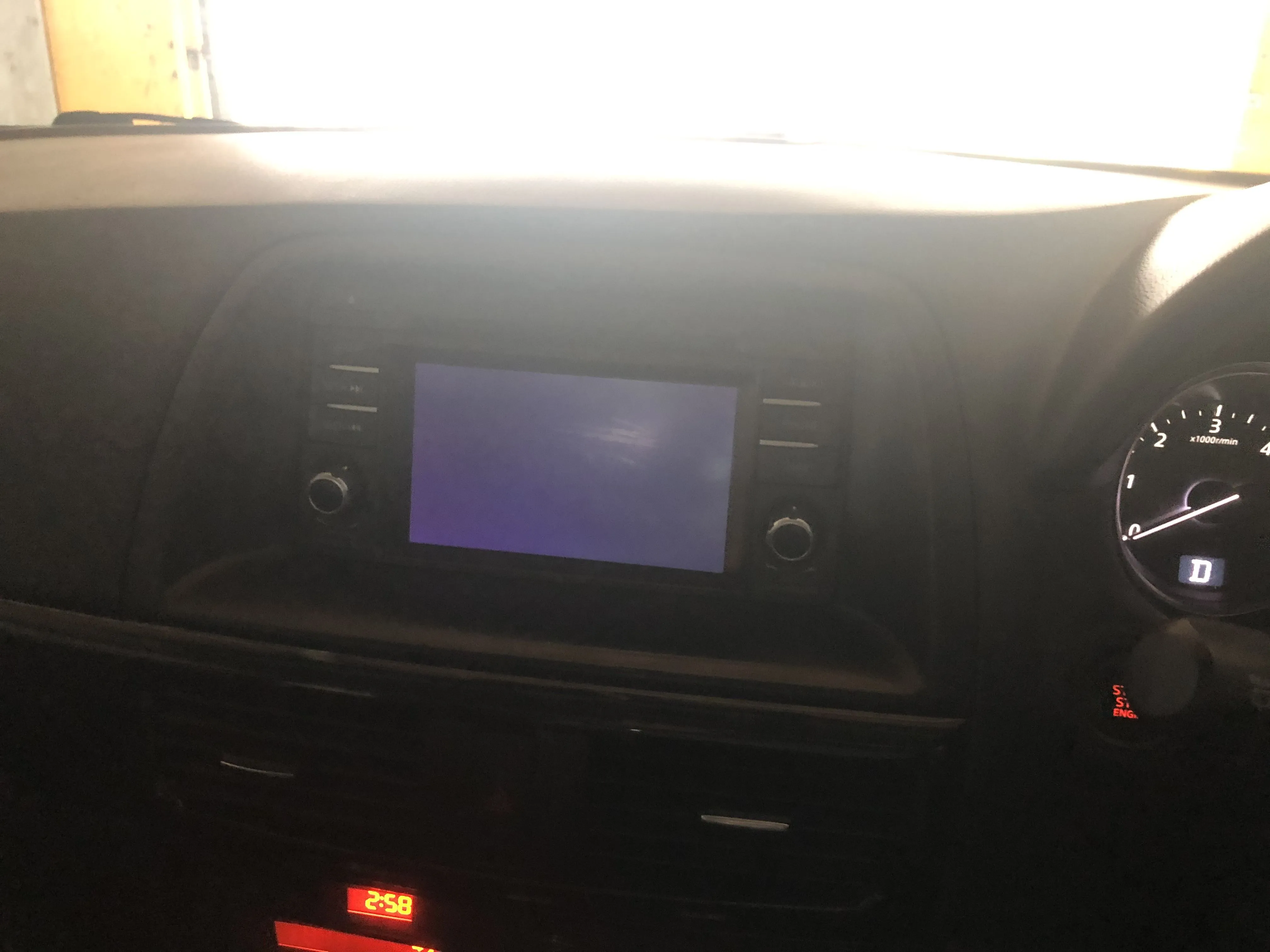

Hi there, I am having a 2013 Mazda CX-5 My 13 Wagon %dr Skyactiv 6s PAw sports Automatic, suddenly the audio display screen blackout, touch is working, Bluetooth working, FM/AM, AUX etc everything working but screen display dark not visible on screen anything.
What will be the fault? service center suggested to replace whole unit. Is there any other way?

Crap. Screen probably dead. I’d try unplugging the car battery for a few minutes and reattaching. If no luck I’d replace the head unit. Sorry man.

If you can see the backlight but nothing on the LCD (have you looked with a strong light on the screen?) then that does sound like the lcd panel is bad. Is that easy, or even possible to repair? Probably not.
Call you recall any particular circumstance or event that precipitated this symptom?
