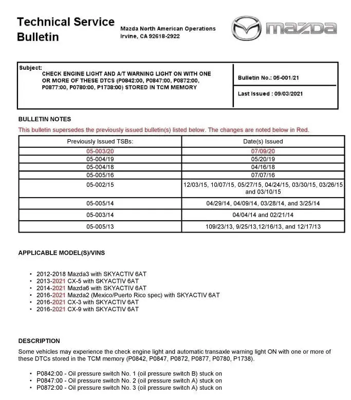

As for whining noise it could be the front input bearing is failing. There’s a TSB for the problem and Mazda had to modified the front casing to prevent the problem happening in later model years.
Mazda Malaysia said the TSB only apply to North America and not Malaysia. But i am guessing Mazda Malaysia just doesnt care because TSB's are issued to protect Mazda from any lawsuit. Malaysia doesnt have a strong consumer protection laws and so Mazda just let it be.
TSBs issued in the US have no warranty purpose either, they’re only for those techs at car dealerships easier to resolve common problems and instruct them how to fix them properly. We as the consumers can utilize them to be aware of those common problems for the car and learn how to fix it properly too.

Whining noise complaint from transmission isn’t uncommon in earlier days here before Mazda modified the front casing. Usually MNAO replaces the entire transmission if there’s warranty instead of replacing the front input bearing. Search the forum.
Those TSBs, especially the newer ones, published on the US NHTSA website will not only state the cause of the problem, but also outline steps to fix it with revised parts listed. I like to read those TSBs, which usually will expose the potential problems the vehicle may have, and finding updated parts to repair if needed.
Yes, so far the TSB on 2013 onwards cx5 transmissions that i've found is only on whinning noise. Another one being check engine light and AT warning light with was caused by stuck oil pressure switches, i'll read all the TSB later when i have time. (our car apparantly did not show and store those codes!)
