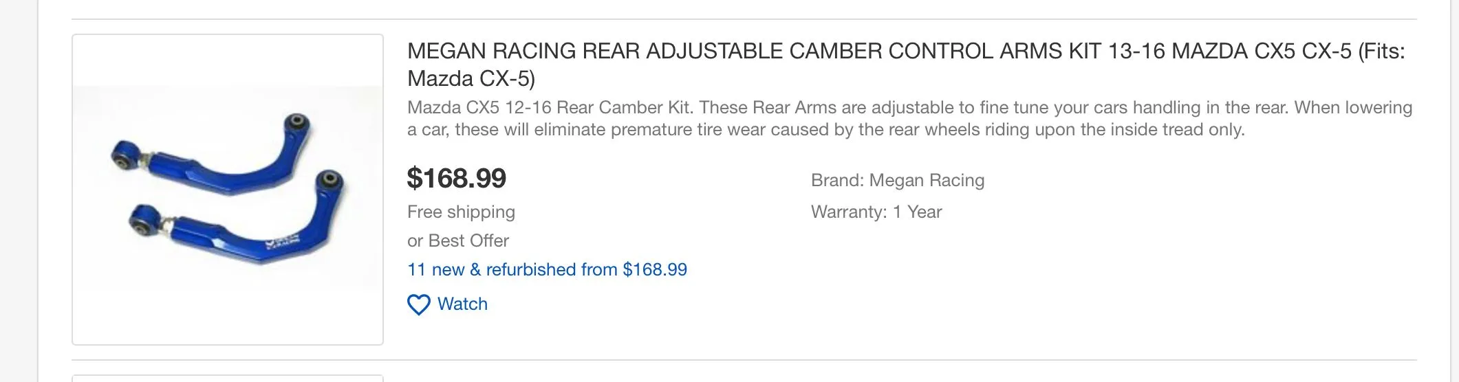

These?
I'm not familiar with those. I have modified different arms in my rear suspension. My setup is unique, most likely, nobody has their cars done this way.
But I guess, those you need to adjust rear camber.
