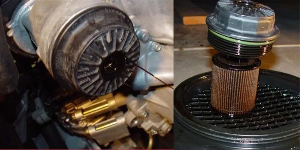

Perhaps we need pictures because my 07 is definately what I would call a cartridge. Just a filter with no covering. Installs inside a housing with a plastic cover.
What he discribes for the 09 is a metal housing with a sealing surface where it screws on to a mounting plate. That is what I consider a spin on.

A Picture is worth a Thousand Words.
I can't say for sure when the switch to spin-on filters happened, but . . .
Top: Photos of cartridge filter element taken from this post wherein Mazdas24/7 member dommo_g describes how to do an oil/filter change on what judging from the date of the post must be an '06 Mz5.
Bottom: A picture of the spin-on oil filter as seen from underneath my 2010 (viewed through the inspection hole.)
