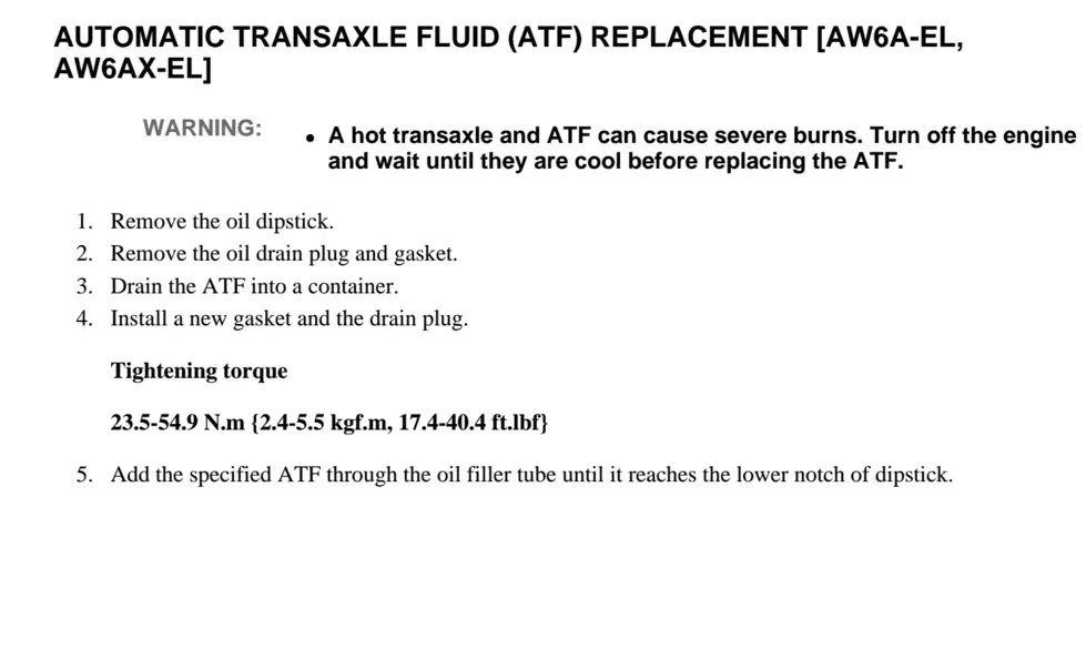

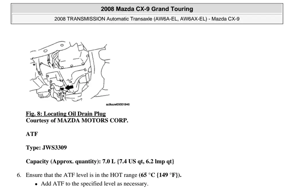

hi guys i have an 2009 cx-9 GT and it has 35,000 miles. only maintenance I've done on it has been the air filter and battery. according to the owners manual I'm good. however should i be looking into replacing the transmission fluid and gasket if so were can i get the filter and gasket? The workshop manual only says to drain it using the drain plug and replace the drain plug gasket.

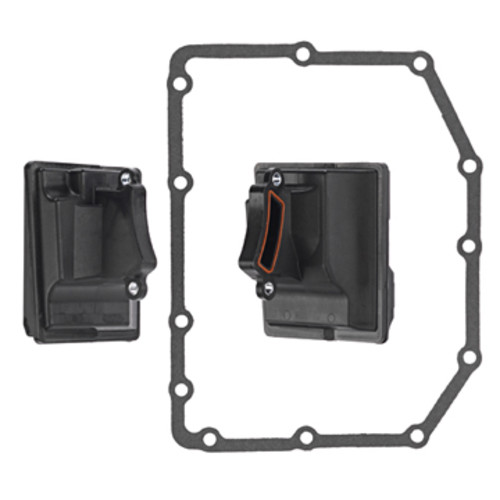

But ebay sells the filter kit. thanks.

I was at the dealer today picking up my 10 quarts of trans fluid for my flush and they said the transmission does not have a serviceable filter.

I checked the fluid yesterday and even after 137,000 miles is still looks pretty good. So I am bumping this job to lowest priority. I will do an oil change and the load leveling kit install in the next few days, then this likely just after the new year.
