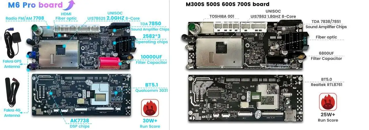

I think I've narrowed it down to two (technically three) units that run in the $300 range. Stepping back and thinking logically about it, what does an extra ~$100-$200 matter when I see/feel/interact with it evetime I get in the car. It would pay for itself in my UX. I've been catching up on XDA and learned some new things. The most interesting and still trying to sort out is adding the ~$20 Mazda canbus to retains using the OEM dash panel where it would be blank with aftermarket head units. Also 9" (720P screen) vs 9.5" (2K screen), they fit the same frame. I'm also leaning towards the 360-camera setup (I better understand what this really means in terms of requirements) b/c I've been wanting to upgrade my backup camera. The add-on cameras set would be $50 vs buying one standalone fisheye lens for $30. This would be a fun toy on an old car.
Opt 1:
Forefeel - Their higher end units use Qualcomm Snapdragon 665 chips (Q2 '19 release). Snapdragon chips have a lower power consumption, which is REALLY enticing b/c heat kills. While its performance score is slightly lower than Unisoc, it is better overall due to lower power consumption.
Opt 2:
Mekede/FYT - Their higher end units use the Unisoc UIS7862(s) (Q4 '22 release chip and designed for tablets). It has DOUBLE the cache memory over snapdragon. LOL, this chip has a max memory rating of 6GB; there's debate on XDA why even offer it with 8GB RAM, other than marketing (what other memory intensive functions can you do on an Android radio..?). The MOST appealing thing is (drum roll), HDMI INPUT! I believe it is the first Android head unit with HDMI Input (not output, that's been around). I also love the fact that Mekede has FULL disclosure of their chips and specs, and show their PCB - LOVE it! Caps are an easy/universal upgrade, will need to check out digikey to see what other componetns has upgrade potential.
Qualcomm SM6125 Snapdragon 665 vs Unisoc UIS7862S
Extensive thread on mods to Unisoc chip units.

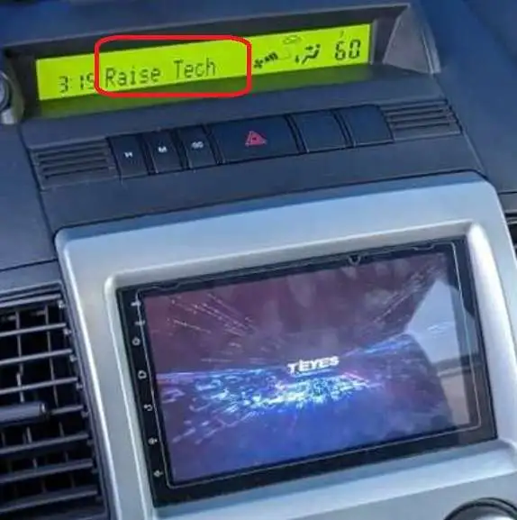

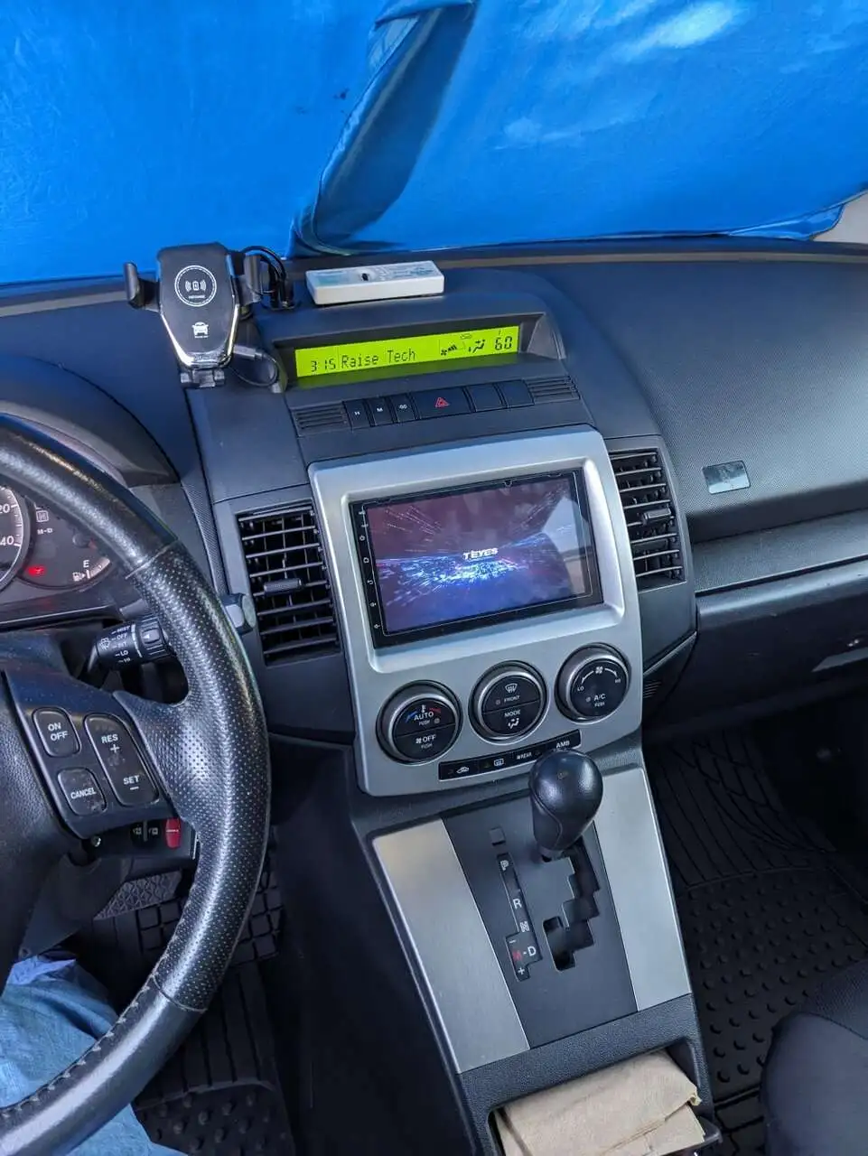

Attached is a picture of my setup. The primary source of navigation is Google Maps on the phone and Waze on the Android unit is used as a secondary option. It really helps with the road conditions updates and a way to look up an alternative route if you're stuck in traffic.

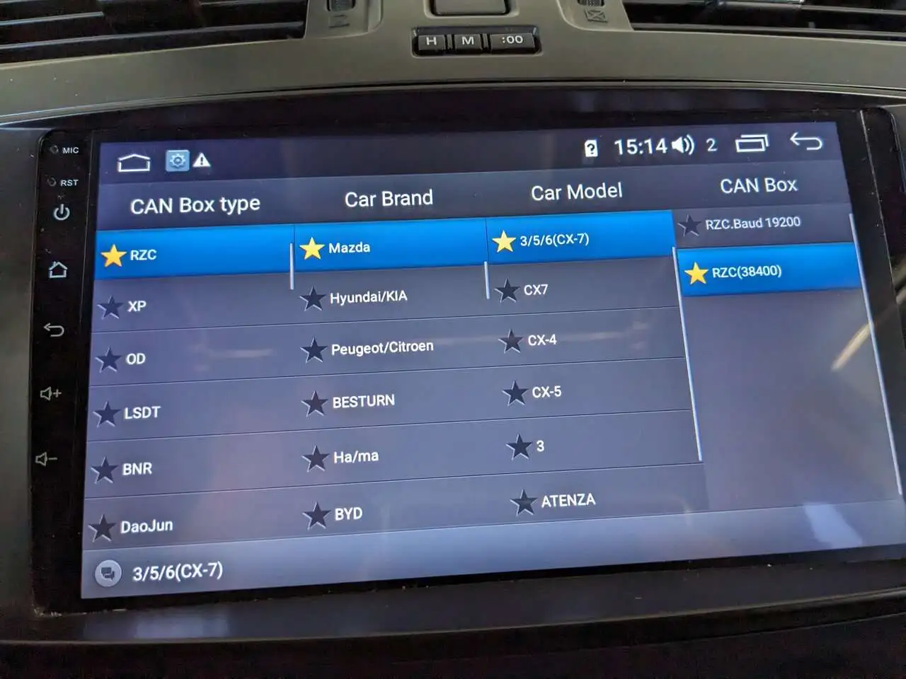

I am very curious about your Canbus setup, hope you can provide some details. Do you know the model#, version#, and mfg. date of your canbus unit (should be printed on the box)? In my cross-comparison, there appears to be ~5 different version floating around that works with Mazda (they look similar, differ in version and date).
Can you check your Android unit's 'Factory Settings->CAN Type Set' to see what make/model/year/version it is set to?

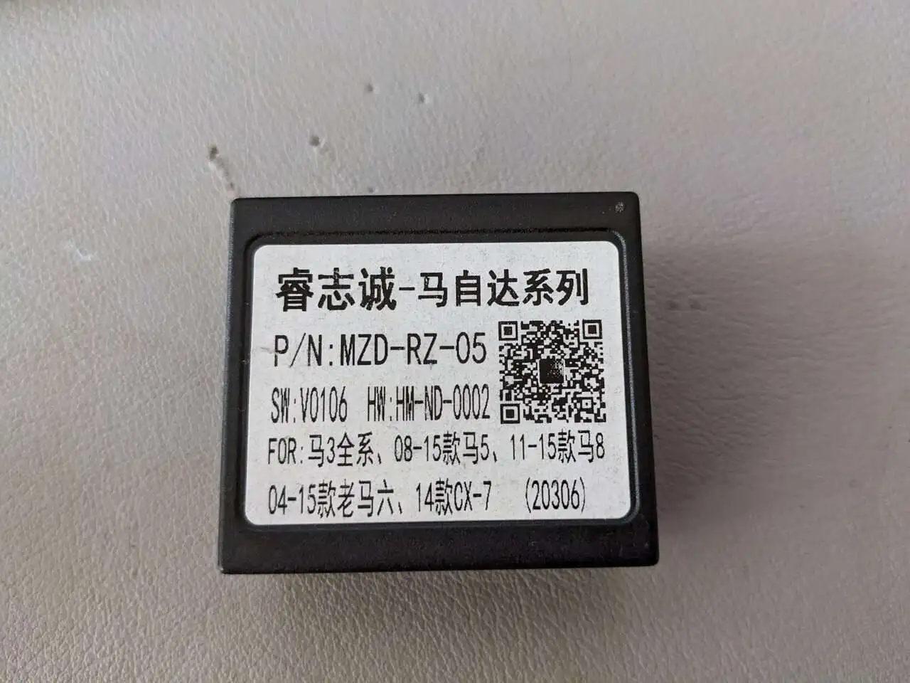

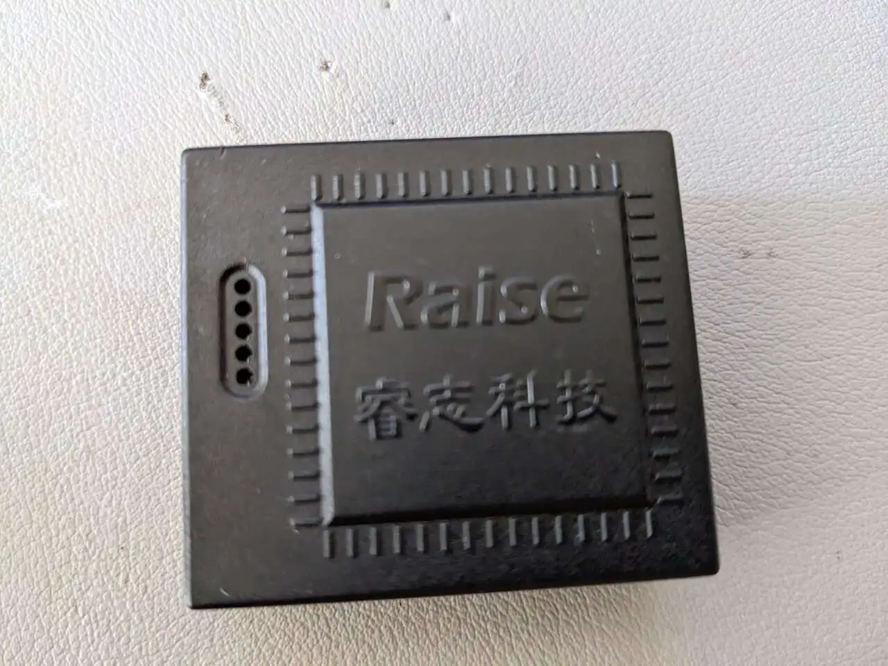

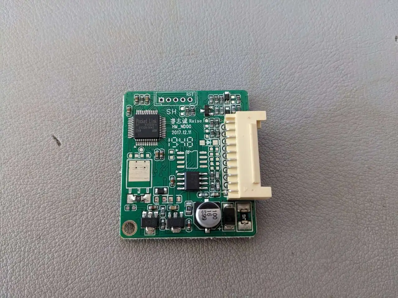

Hello, sorry for the wait, here's the information you might need:
"Canbus box" is hooked in between the android unit and the car interface. This is a modular design by Chinese, since there are a lot of different implementations of canbus functionality in the cars.
1. I'll go check settings and post here.
2. But generally speaking, you don't have much choice with the Chinese canbus controllers. Canbus box interacts with the head unit, receiving information such as "what mode is it: radio or navigation software now?" and displays this information on the led screen of the car.
The same with the keys, it acts as a weird interpreter between the keys and the android functionality.
I don't think you can control AC via the canbus in these cars, and even if you can, I don't need "ok google, turn on the AC" functionality.
3. And with teyes, it comes already preconfigured to match the car / android device communication protocols. It was almost plug and play in my case, I just didn't want to control the buttons via canbus, but chose to control these directly, hence, rewired key1 to android stereo instead of to the canbus box.
4. The canbus box doesn't have a networking interface, it talks to the android stereo over rs-something, I guess. The holes on the box are the guides to 5 pins, which is jtag or rs or similar connector, I believe.
5. The links can be translated with google translate, I checked, the translation makes sense. Just right click anywhere on the page and select "translate to English".
The guy in the video is talking about how to wire and configure a canbus box to make the buttons in his car work through the canbus rather than key1 wire.
6. I think there are two "key" wires in mazda5 with BT functionality, I believe. One goes to the OEM stereo to control "up", "down", "vol+", "vol-" and another is for "pick up the phone", "hang up" and "voice button". In such situations, controlling the buttons via canbus is easier to wire.
Bottom line: if you go for teyes, you won't have to mess with canbus wiring and configuration (like what those videos are about), it's already working out of the box. You'll only have to either find or build a proper harness.
These are the settings for the 2014 Mazda 5 that work for me on Otojeta radio from 2020.
For the 2008 Mazda 5 I used to have, the box came pre-configured with the stereo, I didn't even have to dive into the factory settings to select this.
