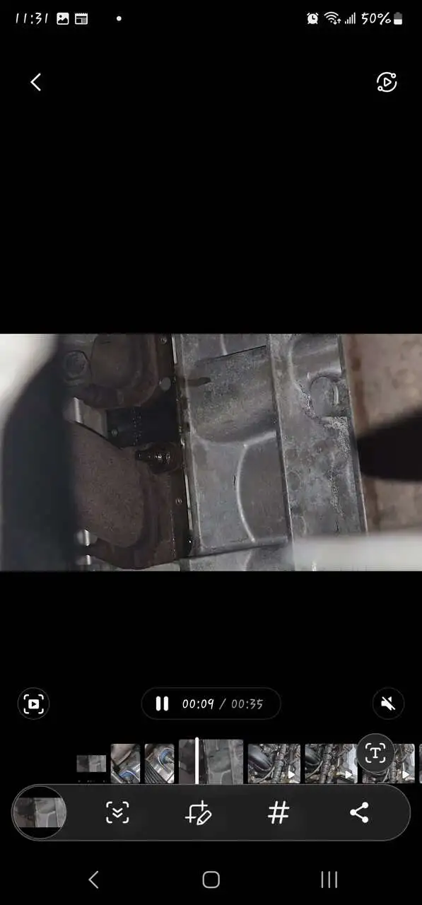

Am having the same issue this week after some extreme cold night in georgia. I've just replace the valve cover gasket but it's still leaking ..its coming from behind the rear exhaust manifold.i don't see anything running down from the top so far

2007 cx9 with 200k on it. I've never replace any gasket until now. Not even the water pump as yet.i may have the remove the cat,if the bolts aren't frozen

I don't want to take that chance because it's getting on the exhaust manifold. I prefer to just fix it ,once I figure out the issue
