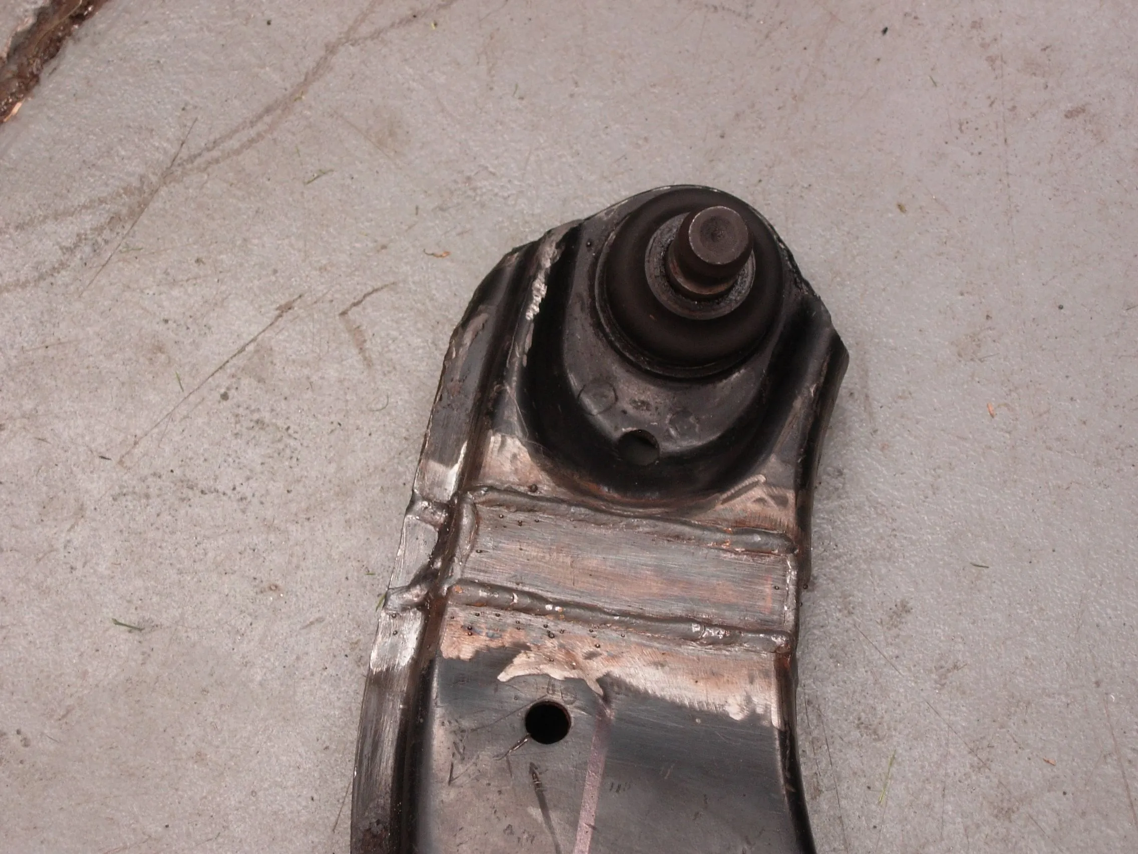

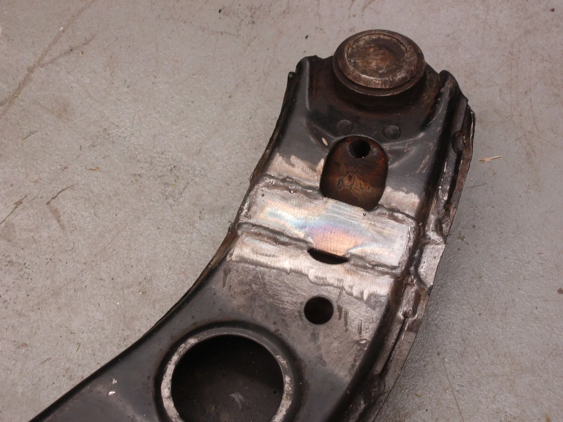

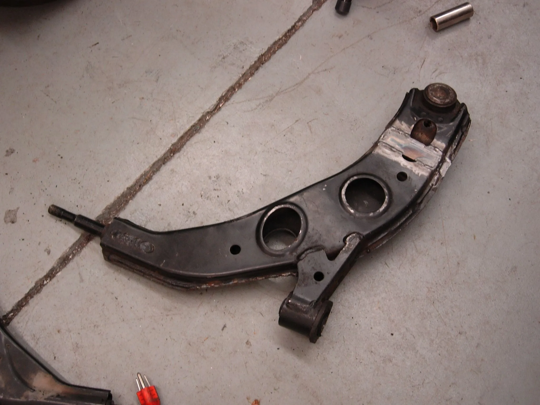

After fooling around for so long in an attempt to figure out what to do with the front right suspension and axle issue, I finally came to a solution. The answer was found in simply extending the length of the control arm. I'd been hesitant to try this method as I was worried that I wouldn't be able to maintain the trueness of the arm with the tools I have on hand. In the end, I cut the control arm about 2 behind the ball joint and inserted about 1 of material. When fitting the modified arm, it fit perfectly and allowed the proper amount of play in the CV. Whew.
In previous attempts, I tried to dismantle the axle so that I could have a new center shaft fabricated, but I wasn't able to separate it completely. Furthermore, using a spare control arm, I cut out the ball joint with a hole saw and moved it further out via a piece of 1/4 steel plate. However, during welding, I cooked the nylon liner that supports the actual ball. Doh. I wasn't aware that a liner existed. You learn something every day.
Anyway, I'm glad this portion is behind me. The only big hurdle remaining is the drive shaft. I hope to have a solution for that soon.

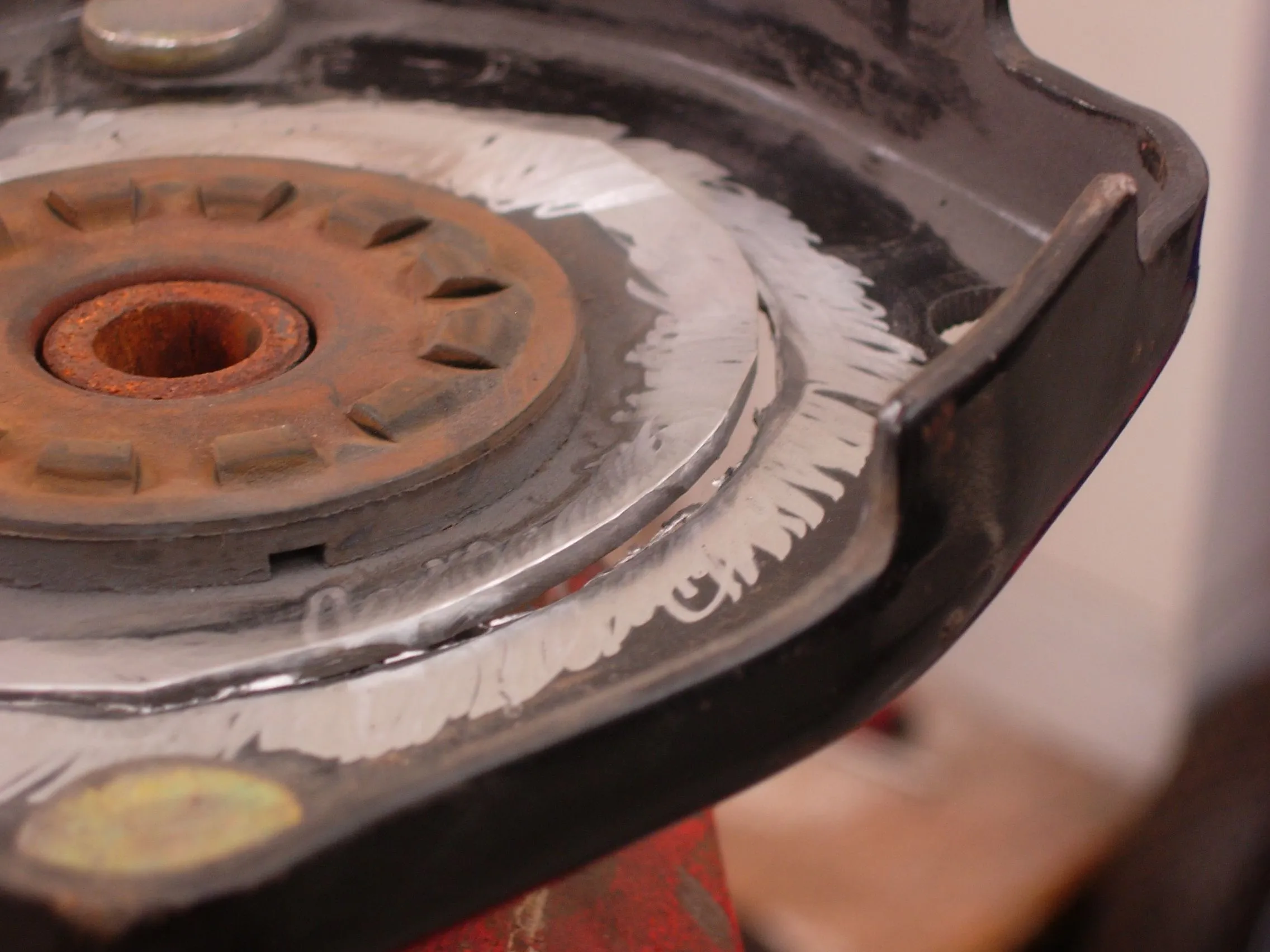

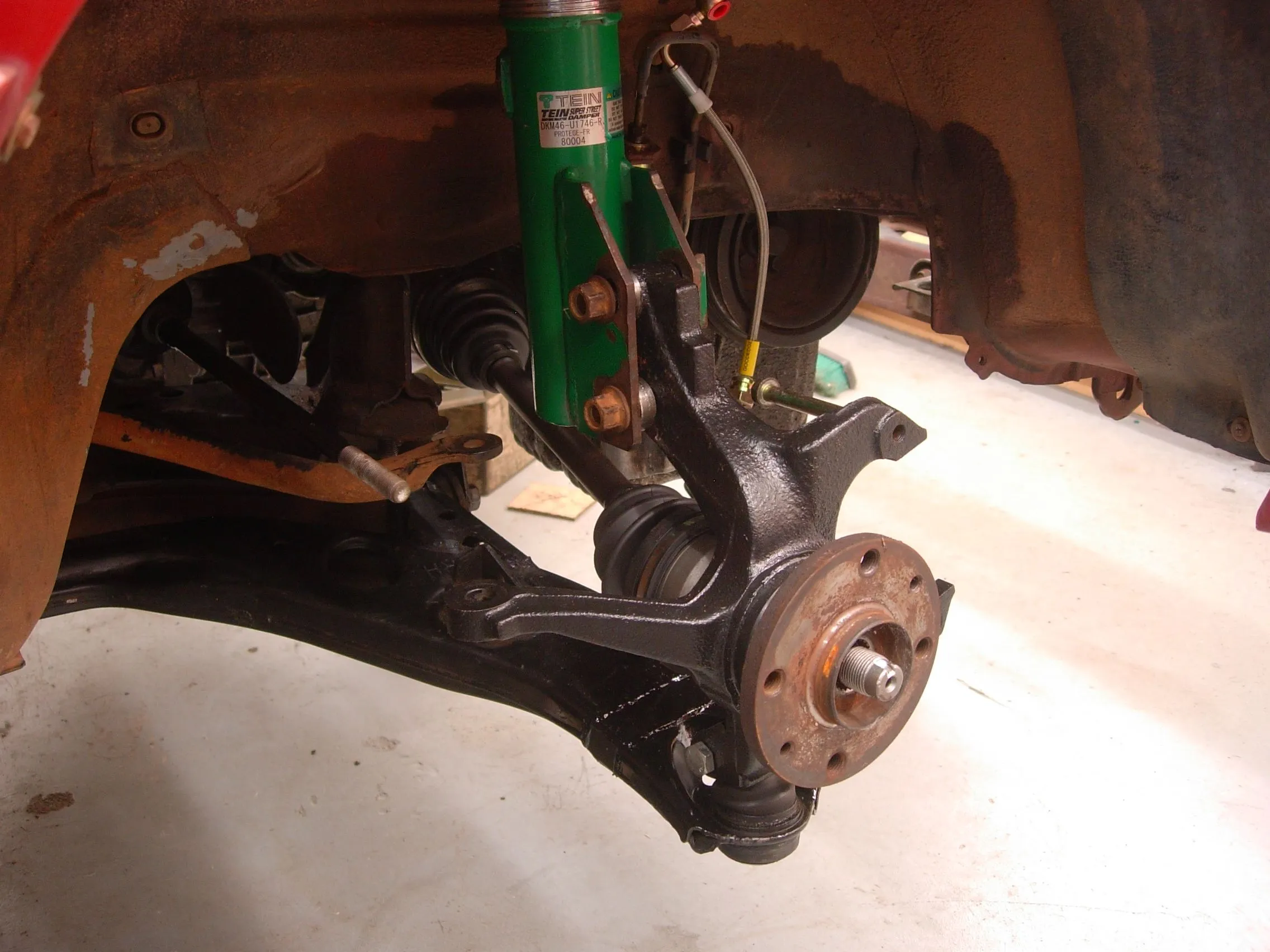

While assembling the rear struts to the knuckles, a significant amount of force was required to push them inward and allow them to mate with the knuckle. This concerned me as it places undue lateral stress on the strut rods and will induce accelerated wear.
Upon closer inspection, it turns out the angle (I don't know the correct term unfortunately) at which the Protege5 top hats direct the struts is much more pronounced than that of the Tracer's. To correct the issue and orient the strut angle to more closely match that of the Tracer's, I cut about two thirds of the way around the perimeter of the raised area on the P5's top hats. I then applied force to adjust the angle and re-welded the cut. I suck at descriptions tonight so just look at the pictures ;).
