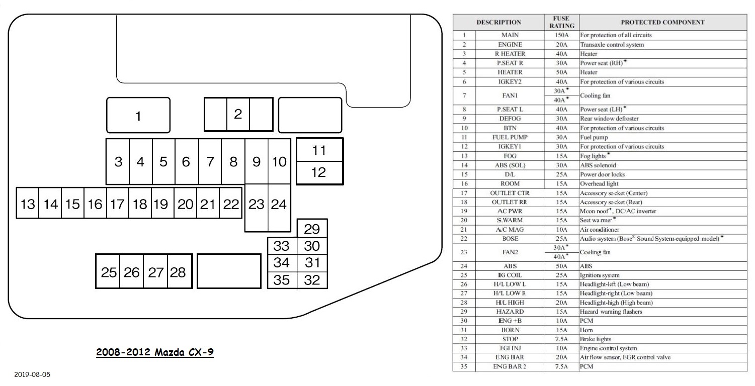

Have you checked the door lock fuse? #15.
Hey Bronco Boy -
Yes, I did check the fuse. Sorry, I should have mentioned that in my original post.
