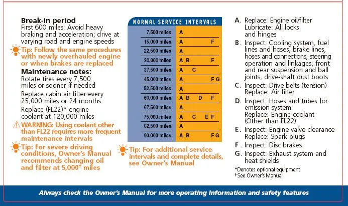

A quick reference guide came with my car. It only listed a scheduled maintenance plan for every 3750 miles - so that would seem to infer that they expect oil changes to be done at that frequency.
Oil Change - Quick Guide
Attached is an image of the quick guide - 7,500 for an oil change - I guess Mazda wants you to visit the dealer more often so they get to know you better (or maybe your wallet). However 3,750 x 2 = 7,500

Thanks for the heads-up pmeilakjr; looks like my memory isn't so good. Seems pretty long before changing the oil... Is that what they really expect? A lot of people would have no idea when it should be changed, other than when the guide tells them to come in.
