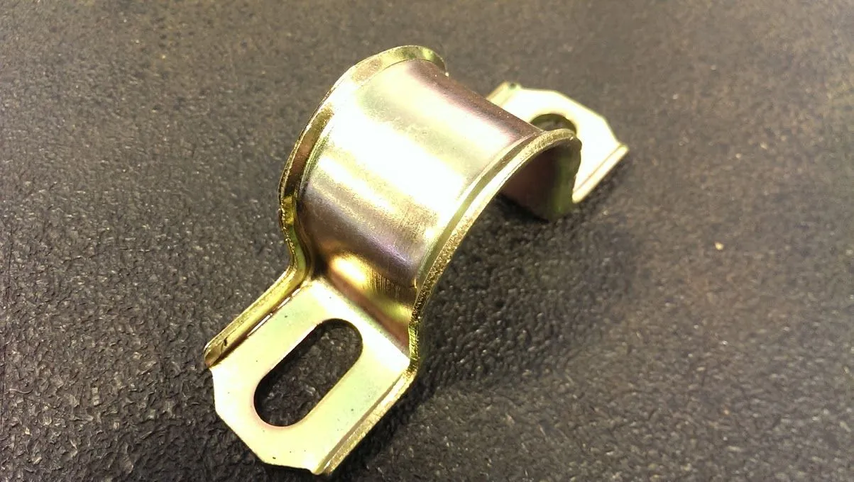

Thanks for the follow-up. Can you post a pic of the brackets that came with the moogs?

Sorry about the late reply. Because the centerline of the bushing, the supplied bracket wouldn't line up with the holes. The sway bar collars would have to be removed or at least moved. Plus IIRC the factory holes are spread out and the supplied bracket holes would have to be elongated. Wasn't worth it to me.
Yeah I shoved my phone up in there to get the pic. It's the rack side that is extremely tight.

Thanks for the pic of the bracket! It moog brackets look quite weak/flimsy compared to the stock bracket. So it sounds like the only drop in replacement is OEM, which IIRC was revised.
