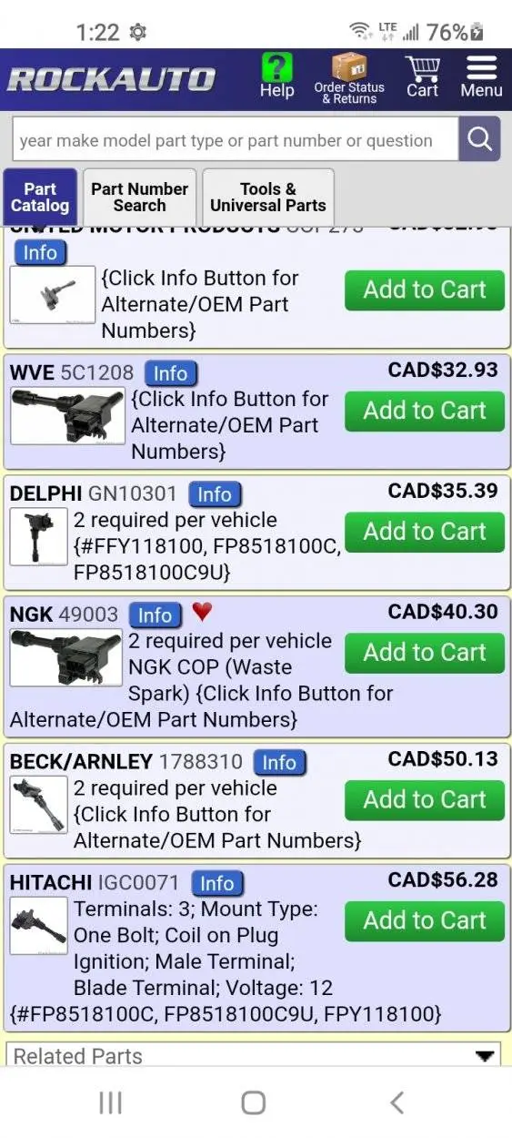

Coils for our car can be a real problem.
They can be bad, brand new, right out of the box.
Hitachi coils are a quality coil and worth the extra money.
I almost always buy the cheapest replacement parts for my car, but not for coils.
Cylinders 1&4 are on one coil and cylinders 2&3 on the other.

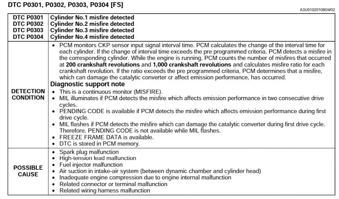

Here's what the FSM says...
If you've got the same code, I would check the condition of the plug to see if it's fouled or burnt, and check the plugs gap.
(NGK V-Power, regular copper plugs give the strongest spark and they are dirt cheap but they need gapped or replaced more often)
I forgot whether or not it's cylinder 2 or 3 that has the coil, but check the connection between the coil and the sparkplug.
Carefully inspect the electrical connector that plugs into the coil for corrosion or bent terminals and check the wiring harness for any kind of crack or broken/damaged wire.
If it were me, I'd put dielectric grease on all the connections, including the 12V connector on the coils.
It helps prevent corrosion and arching/sparking.
You may have a leaking or fouled injector.
A fuel system cleaner may fix it or a new injector may be needed.
(inspecting the injector is a bit of a chore.)
I can't see a vacuum leak affecting only one cylinder ?
You may have low compression on that cylinder due to age and wear, or high compression due to carbon deposit buildup reducing the volume of the combustion chamber.
