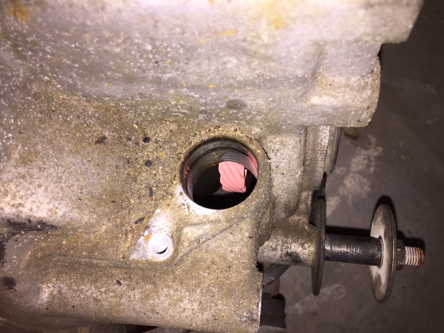

Quick question. What do you mean by the ring gear? The ring in the trans or the VSS? I took the dummy sensor out of the trans today and I found a pink ring gear inside. The trans was from a 2001 ABS Protege. I think I have some luck if this ring gear will work.
Sent from my iPhone using Tapatalk
someone correct me if im wrong but all Manual trannies come with that SPEED RING, only the LSD trannys dont?
Correct. Since no MSP's were ever produced without ABS, Mazda saw fit to leave the speedo drive gear off the differential.
