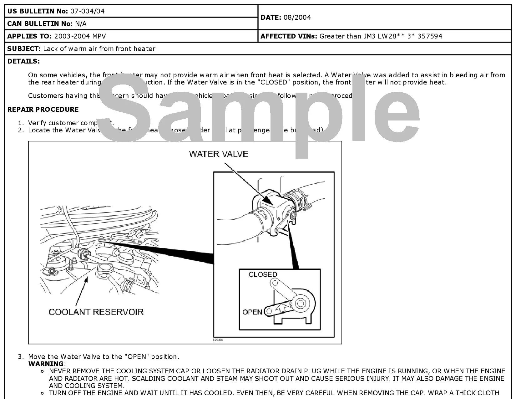

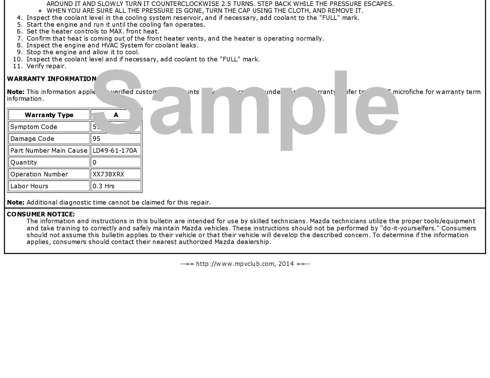

2001 mpv no heat
Mazda MPV Technical Service Bulletin-0.webpMazda MPV Technical Service Bulletin-1.webpive been told of a water valve somewhere on the passenger side i have a diagram of 2002 but i do not think its the same
