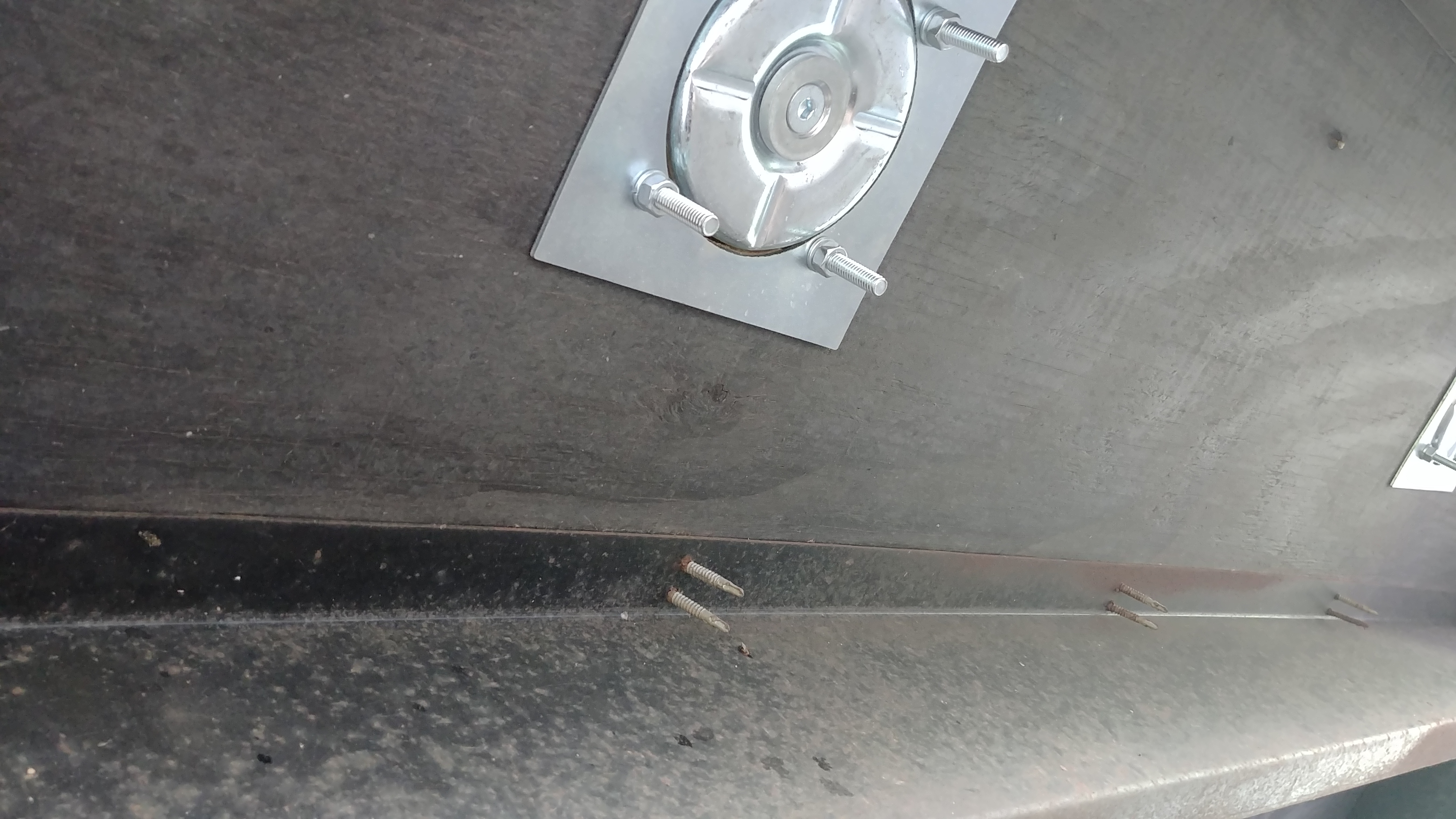

Time to fix the new D-ring mounts properly that I added to the trailer. They're listed as 6000 lb load each, but uh...the plywood they're bolted through isn't. I tried it for last month's TT event, but it really didn't give me the warm fuzzies seeing the floor flex when strapping the front of the car down.
First thing first was cutting off a handful of floor screws that were hanging right in the way, because of course they were:

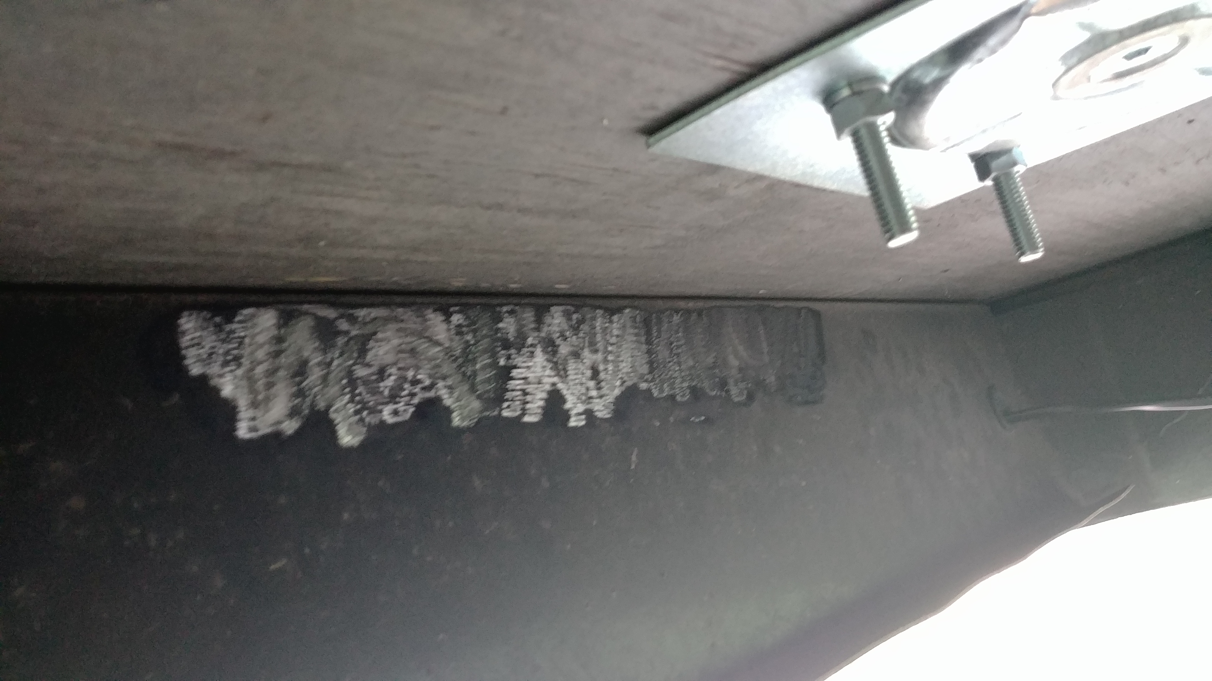

Grind a bunch of paint and surface rust off so I have something decent to weld to:
And then weld-through primer for all that, and the tops of the plates that I won't be able to get to to paint after the fact:

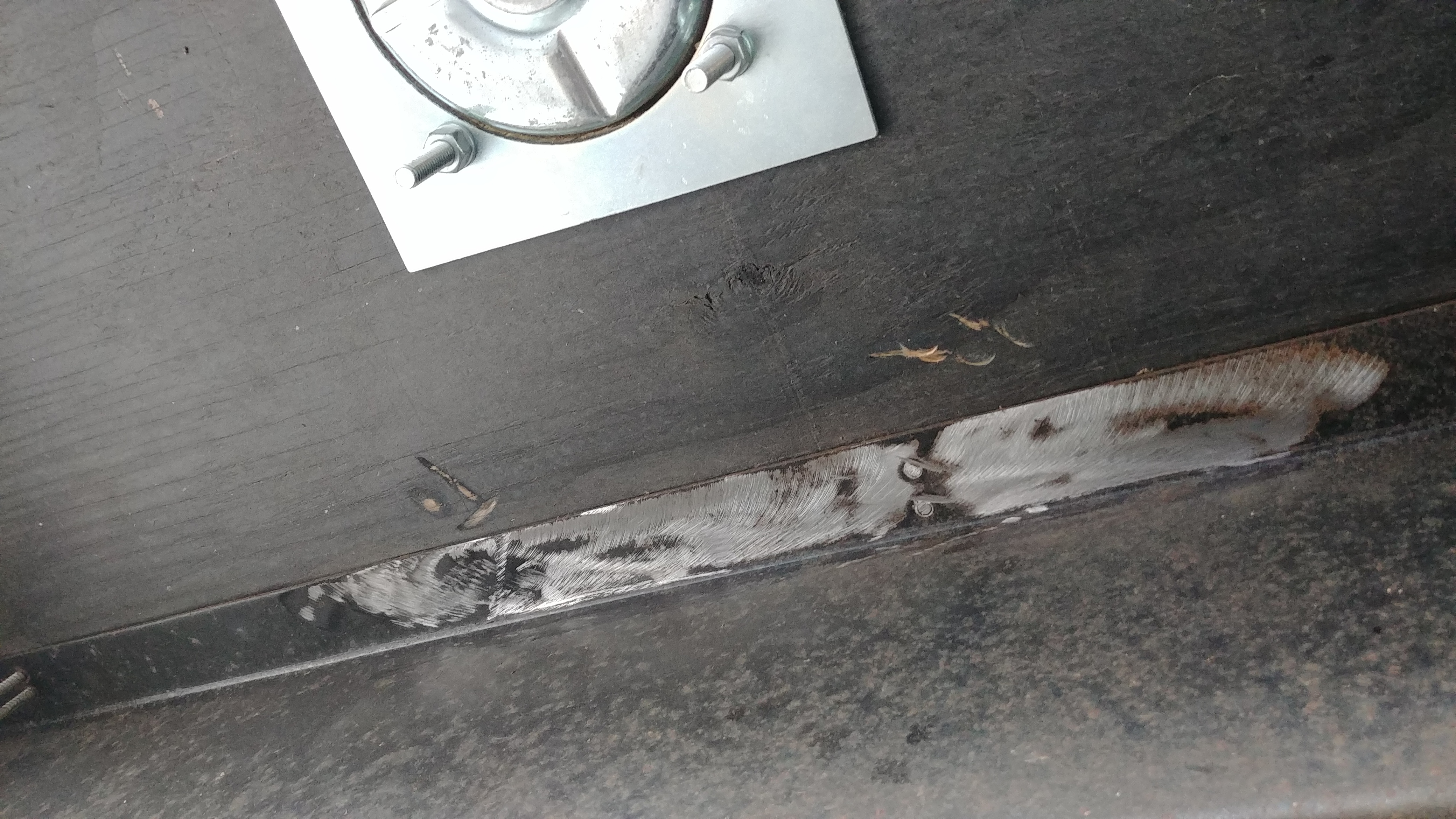

I got the plates welded in. Welding upside down sucks donkey balls, but other than that it wasn't too hard of a job.

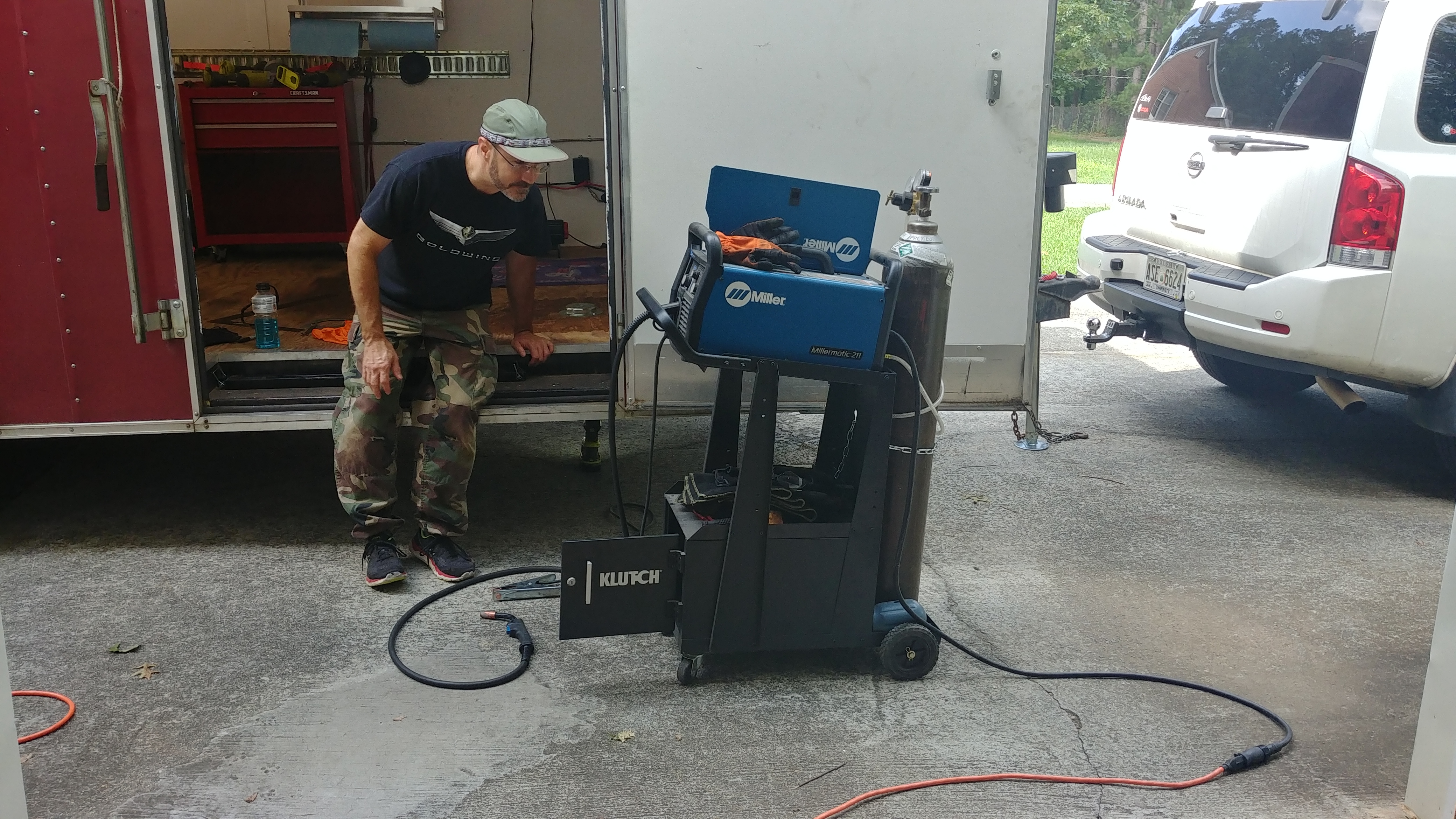

Had the first opportunity to run the welder on 120V. Seemed to do the job fine and, somehow, never tripped the 15A garage breaker :lol:

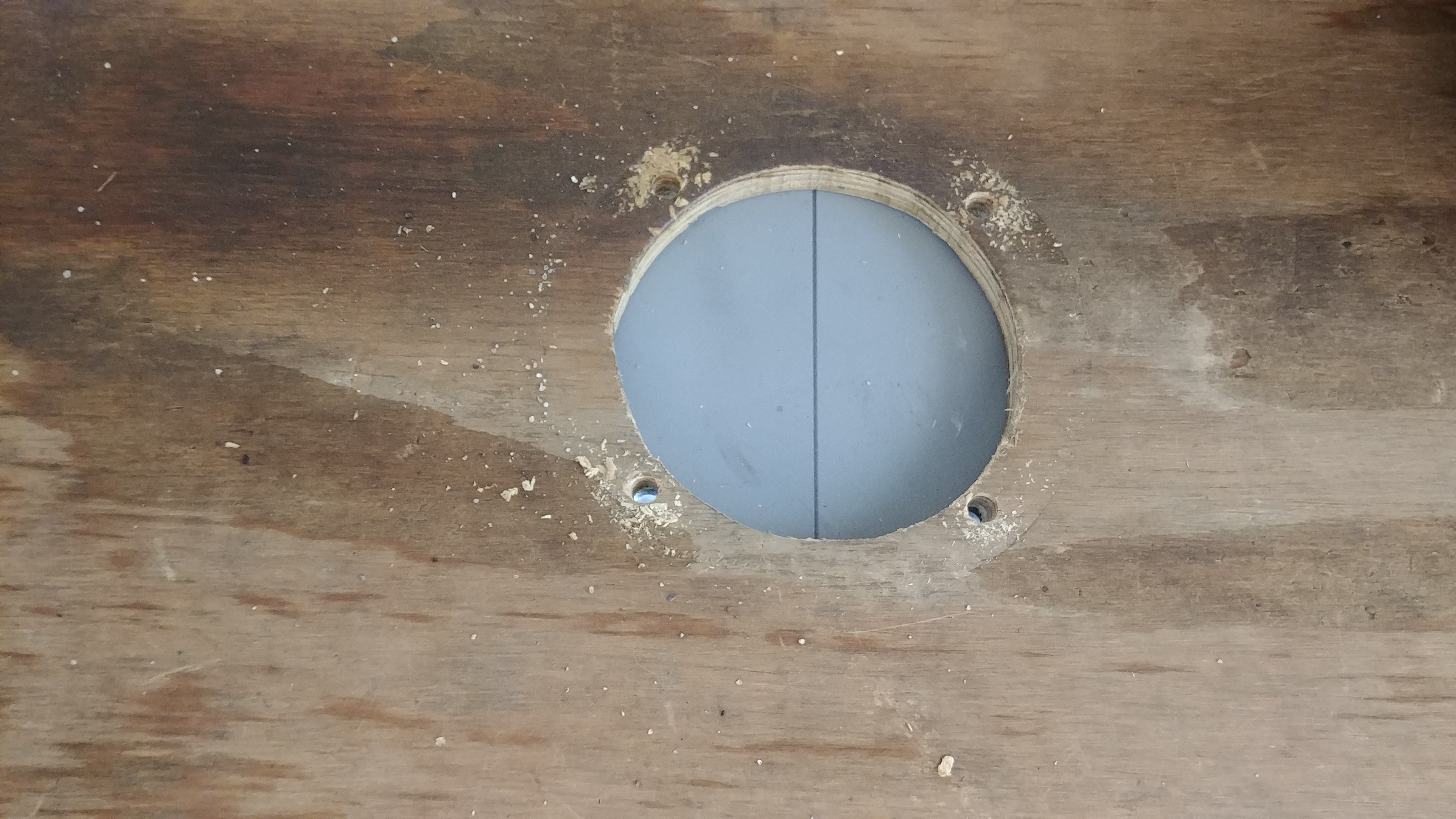

It was a multi-step process of figuring out where they needed to be (the frame is made of Z channel, so 1 side I had to be right against the frame rail, and the other I had a couple inches of flat steel to play with. A buddy helped me get them more or less centered from above, then we popped a pair of transfer punch marks on the plate. Drilled those, took it back up and bolted it to the floor to confirm alignment, then back to the shop to drill the other 2 holes. Rinse and repeat. But once that was done, the floor supported the plates for welding, which made that part significantly simpler.
Without a doubt these aren't the prettiest welds I've ever made, but they'll do the job :D
