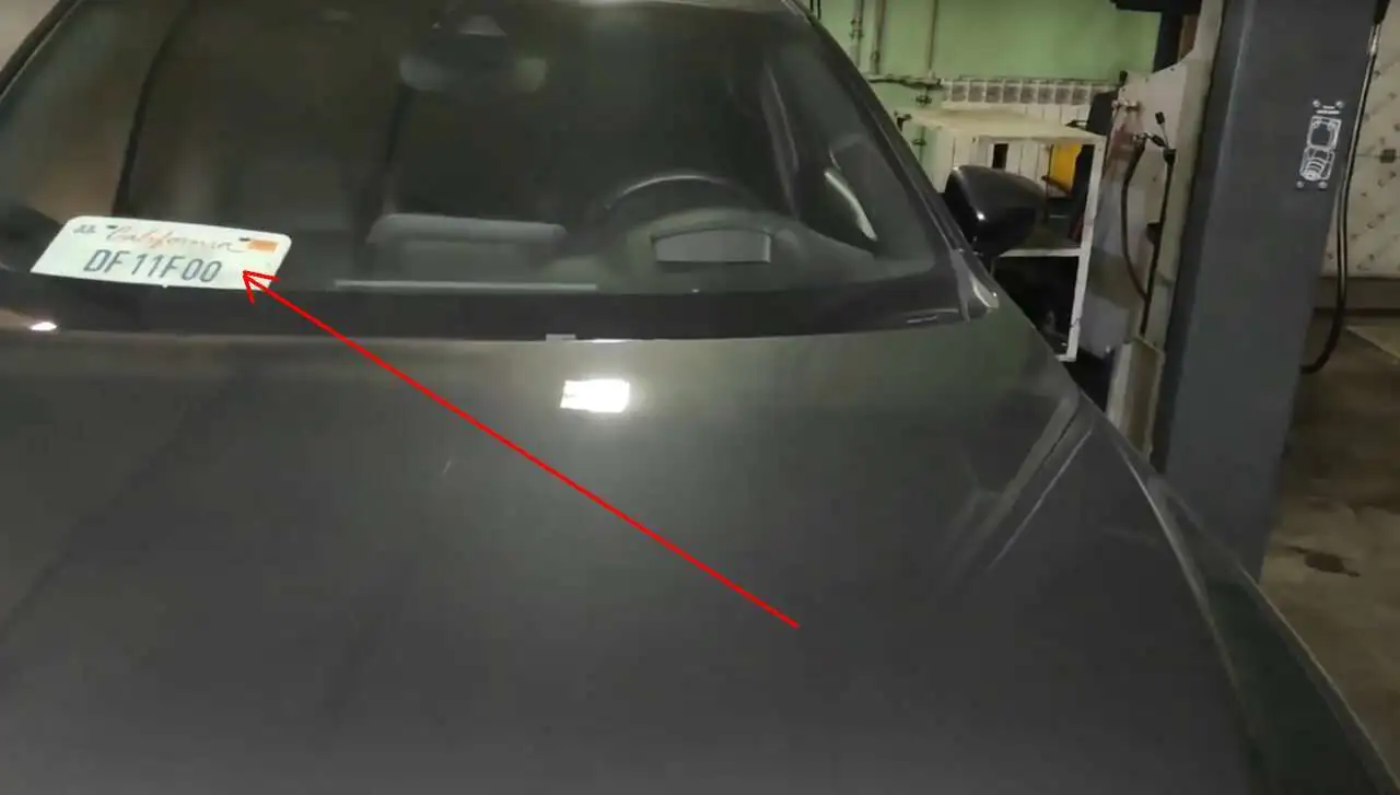

Actually, this car came from the US - if you noticed it has CA license plate, probably he bought it at auction...
