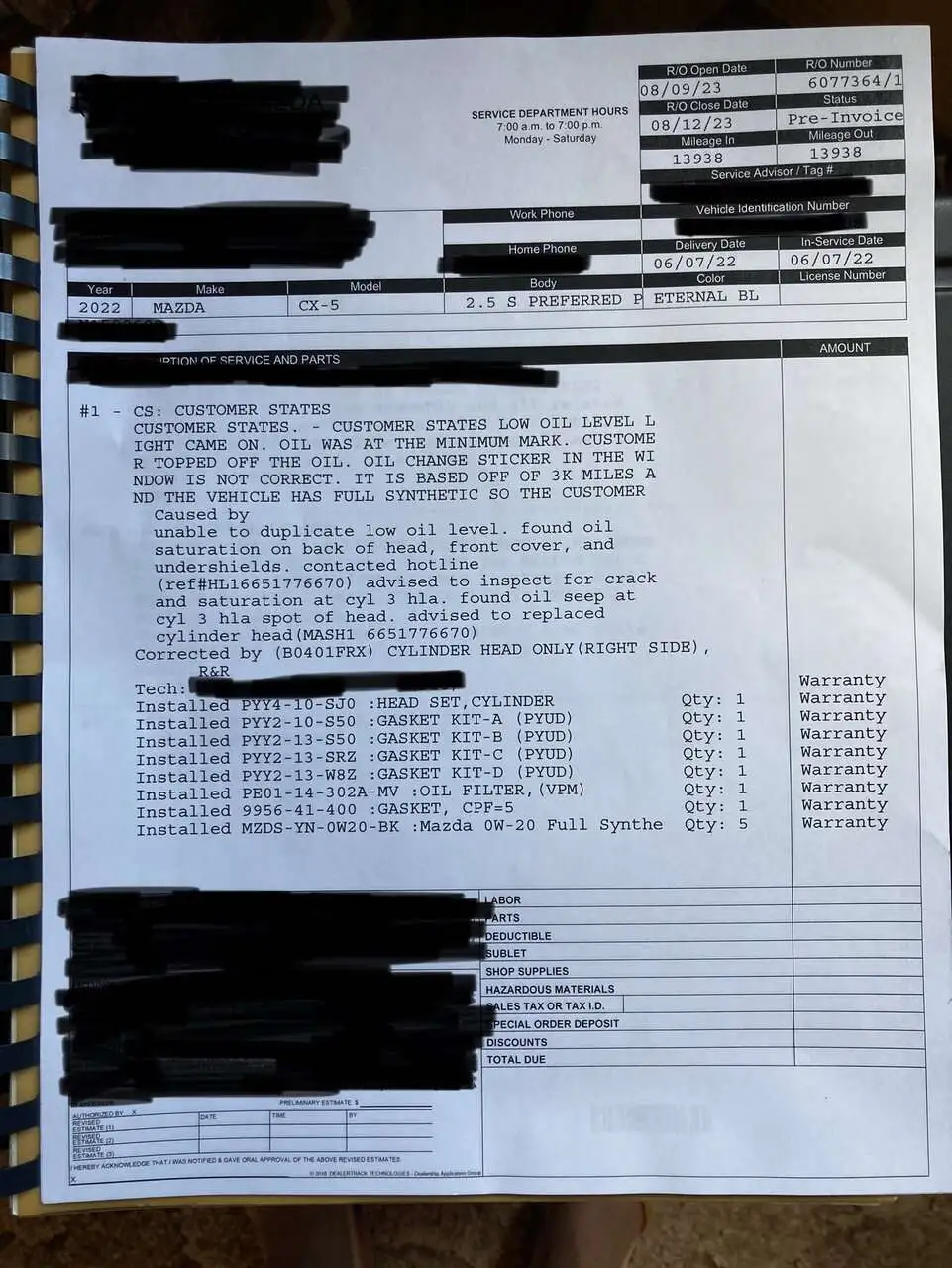

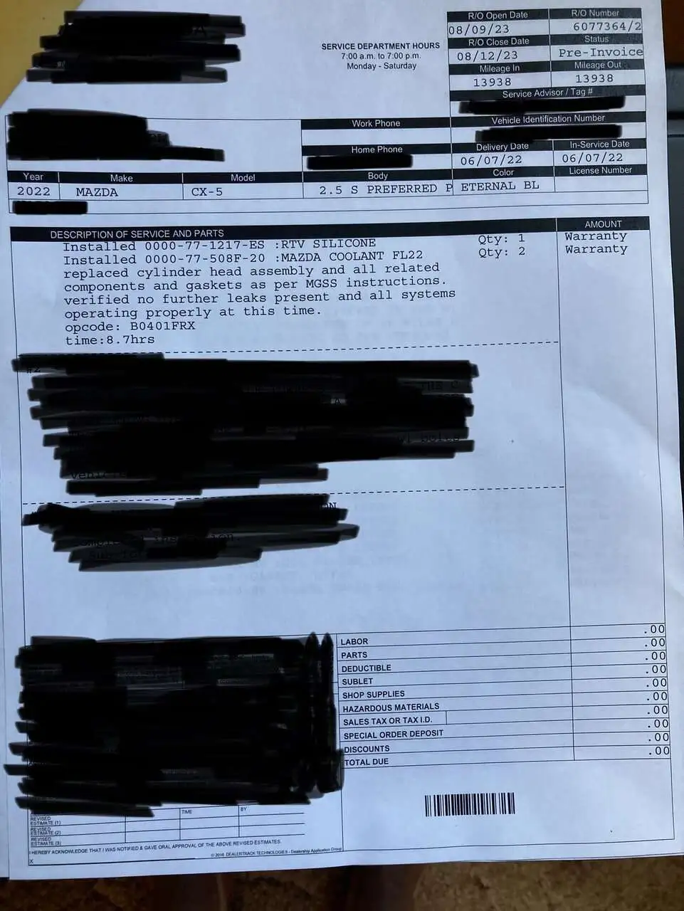

It is still happening with the 2022 models. I just got my cylinder head replaced under warranty. It's a CX-5 with a skyactive engine; it's not the turbo. I bought it new in March of 2022 and it only has 13,000 miles on it. There were no warning signs or symptoms other than the low oil level light coming on. I have the oil changed twice a year, so that definitely shouldn't have happened. I stopped immediately so no damage was done to the engine. I hope the replacement head will last.
Sorry to hear, that's disappointing. Do you have an invoice that you can post? I'm sure others would be interested in seeing what was itemized on the invoice (to compare part numbers and such).
This in in reply to sm1ke. I think I posted a blank reply a minute ago.

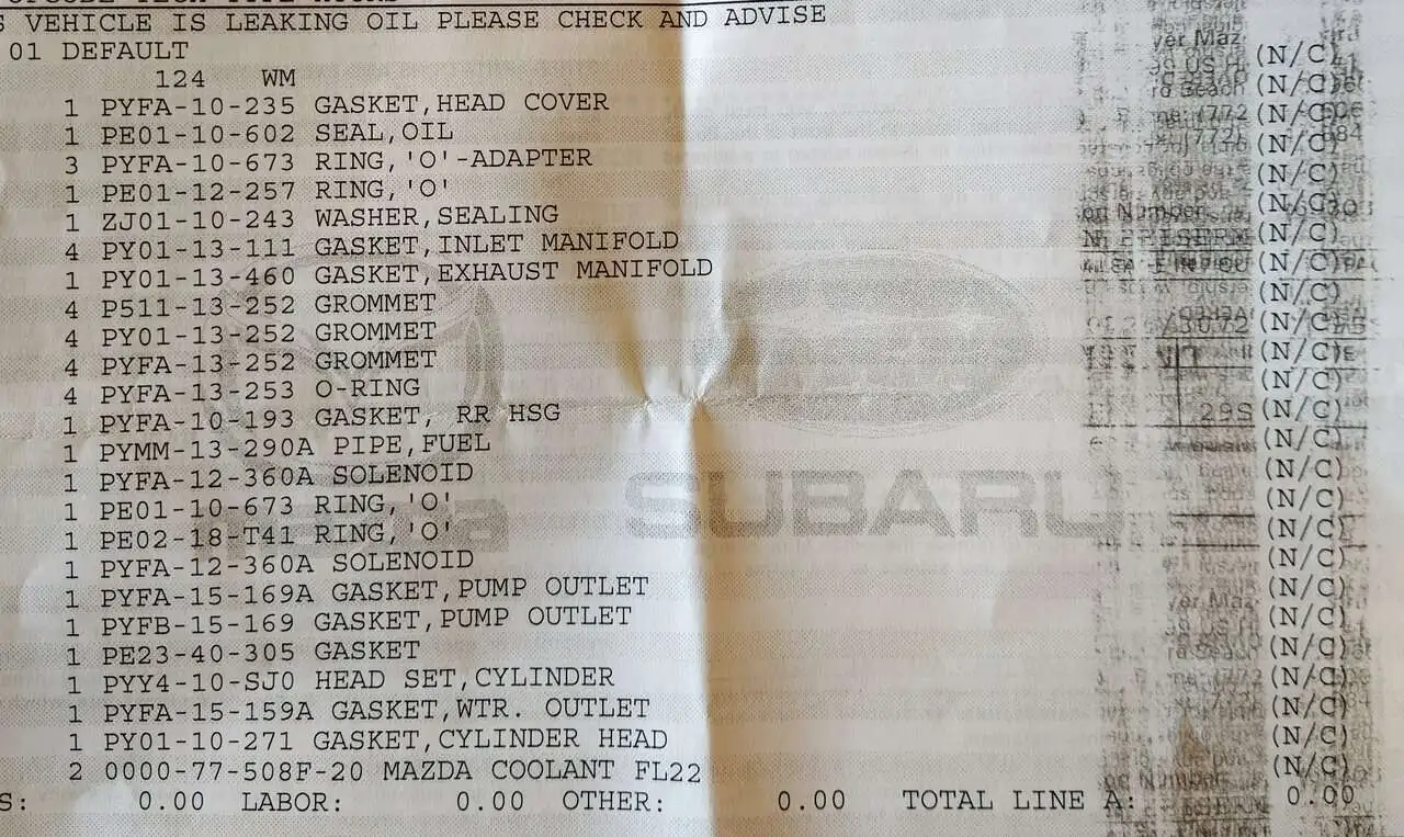

We have a 2019 cx5, leaking oil down back of engine. Minimal dripping. Big odor. 32k miles. Brought it to Mazda. Drivetrain warranty still active. Part & labor covered. This is what was replaced. If there are any mechanics out there, how does this look to you? Thanks & Good luck to all.

I made an account just to reply to this thread. I've been a tech for Mazda for over 15 years now, doing my second bad head related replacement today actually. The first time I found one was on a CX9. No complaints, was just a simple 16k service and I noticed that the oil and coolant had mixed together, opened a ticket to Mazda Canada and they sent an engine replacement. Now the problem is so common that we just replace the head and gasket. The problem seems to be from a small crack in the head near the exhaust manifold bolts. The engine will either leak coolant or oil depending on where it's located, but the leak gets worse the hotter the engine gets. Thanks to supply problems, took well over 2 months to get the parts needed to repair this CX5 I'm working on today. As far as how common this is, my dealership has done maybe 9 or 10 heads in the last year.
That parts list actually looks more than ok, with more gaskets being replaced than usual and also the HPFP pipe, which is surprising to see. I don't understand why the PYFA12360A solenoid is on there at all, much less twice, but perhaps it broke during the repair work and had to be replaced.
But no problem from your perspective however, because all the matters for you is that your vehicle is running fine and not leaking any fluid. Be thankful that your vehicle was still under warranty when the head cracked, and that you didn't have to go to war with Mazda about getting extended coverage!

The cylinder head assembly PYY4-10-SJ0 which includes valves、valve springs、valve spring seats、and cotters pre-installed has been used in recent cracked cylinder head repairs on the 2.5L NA with cylinder deactivation as showed in reports with invoice.
Service Alert No. SA-037/23: New Cylinder Head Assembly Established
eljavi‘s Invoice
DianeJinOK‘s Invoice
Your dealer replaced a lot more gaskets、grommets、 and O-rings even an expensive fuel pipe (PYMM-13-290A, $136.36) and 2 solenoids (PYFA-12-360A, $86.70) than other Mazda dealers. While 2 gallons of FL-22 coolant were used which didn’t show in other invoices, but yours doesn’t show any oils for oil change that’’s strange. Apparently the Master Tech at each Mazda dealer has different opinions to do the head replacement job on the 2.5L NA with CD.
Thank you so much for the info. You really put my mind at ease. We have had very a rough time lately and your words are a ray of hope. I appreciate you more than you will ever know. You are amazing! ❤️
eljavi‘s Invoice
Thank you so much for your comment. We just had our oil changed with them. That's when they noticed the leak. He also cleaned the under chassis. It was covered with oil all the way back to the exhaust. It was probably leaking oil for the past year.
