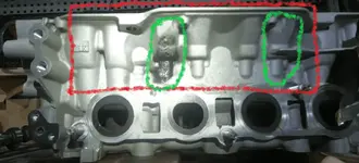

What might actually be very helpful though would be to find pictures of the new head, particularly the upper back side, where the damage always occurs. Any significant difference at the back of the head, between the new head and the original one would basically confirm that a redesign was in fact done. So far there have been no pictures of this replacement NA head to be found on the online parts sites, just those stupid drawings instead.

I like your proposed approach to answering the question (same/different head?). Am I correct in recalling that... somewhere in this thread... there's a a picture of the back of an "old" head? And/or are there pictures somewhere else in the forum? If we can get a picture of the back of an "old" head, then we're halfway there.
Re pictures of a "new" head, I'll see if I can execute your approach. No guarantees, but I'll give it a shot.
... Am I correct in recalling that... somewhere in this thread... there's a a picture of the back of an "old" head? ...
Here's a snapshot from the set of vids of a couple of cracked NA heads taken by a Russian mechanic, which were posted somewhere in this thread.
The particular areas of interest are marked in green, directly above the exhaust manifold studs, which is where the cracking has been reported. However, if they did modify the head by beefing it up, then the entire area marked in red might look different as well. And that upper section of the back of the head is also accessible on our vehicles (after removing the heat shield), for additional close-up pics if necessary.

@edmaz - Perfect! Thanks! That's the exact pic I was thinking about (because it shows the bracing between cylinders 1 and 2).
