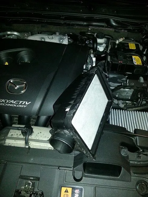

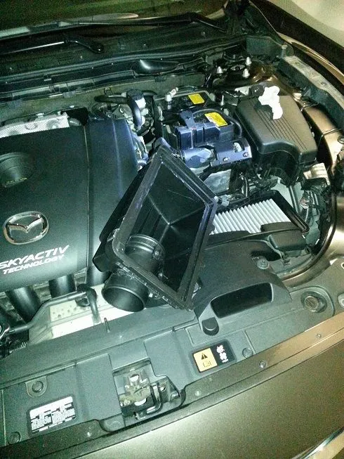

I noticed that on our 2.5L Mazda6 there's a thick filter glued unto the stock Intake box. It's actually about 5 layers and the middle layer has some sort of foam/charcoal chunks. Weird. Our 2.0L engine does not contain this thick filter element. Did you guys with 2.5L CX-5s notice that filter?
I ended up removing mine as it seemed pretty restrictive. My initial acceleration seemed a bit smoother although it may be a placebo affect. Still it was a pretty restrictive 5 tiered filter glued to the box. Another thing I noticed was a ink stamping that said MRZ which from my understanding was Mazda's previous gen engine.

A lot of the new cars have these as a secondary charcoal filter to filter out fumes. Some people remove them claiming it improves horsepower.

Did research on BMW, WRX, and Prius forums to confirm its a charcoal filter for engine fumes. Essentially this is a delete mod. Considering the 2.0L doesn't have one I've always wondering why it felt a bit more responsive. If removing it from the 2.5 to see any gains it would be merely accessing HP that was already there.
See post #1 of this link. Guy did dyno runs before/after charcoal delete mod. Noticeable HP gains for his truck. The talk in the BMW forums are that dyno's for their engines confirm HP (access) after mod delete but could not find images as proof.

Its a post filter that even sand would go through. Essentially not a physical filter. That's what the drop in filter is for.
So Mazda engineers deemed this beneficial for whatever reason(s) and you ripped it out. Now that's weird!
Its designed to filter out fumes at the expense of being more restrictive. I have little concern with fumes so I'll be glad to have less restriction. Another way to put it is I would never add this restrictive filter to our cx-5 2.0 which doesn't even have one. I mean these skyactiv engines and even older Mazda engines had air coming from the outside via stock cold air system. Also, I think its more of a California emissions regulation thing. Not sure if other countries even have these restrictive filters. If so than its not an original Mazda design intended for the engine but merely an add-on for models sold in the US (California).

That's the thing, these filters were designed to reduce emissions while the the car is parked and engine is shut off. Kind of like the charcoal canisters for the fuel tanks. I guess as the fumes rise it will hit that filter before going into the engine bay... But then the opening to ambient air is just a couple of inches away.
I think a question to Mazda would provide a correct answer. It may be there to protect the regular air filter by limiting any backflow that is caused by the intake and exhaust valve overlap open time. Ed
This is a PZEV charcoal filter. It's on all vehicles with CA and PZEV type emissions. My car does not have it because I purchased in AL where they don't endorse CA emissions or PZEV.
California's guidelines for Partial Zero Emissions Vehicles= PZEV.
Non PZEV cars don't have this filter while PZEV cars do. Found more vids of the filter delete. You gain a sense of how thick/restrictive it is. My engine runs a whole lot smoother now.
