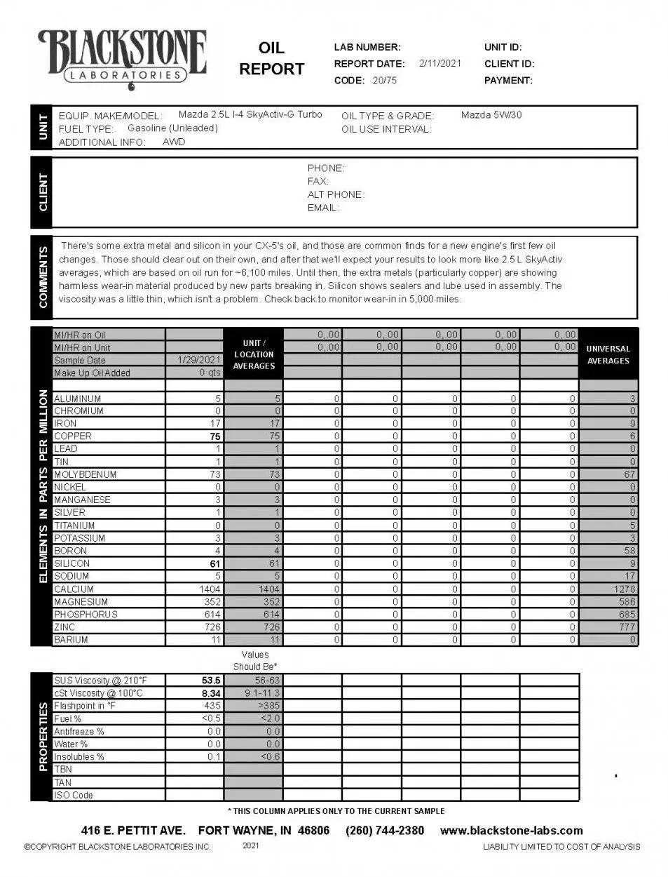

2.5 Turbo Oil Analysis?
My wife's 2020 CX-5 GTR, first oil change.

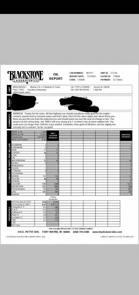

Here's a UOA I had done on my 2018 CX-9.

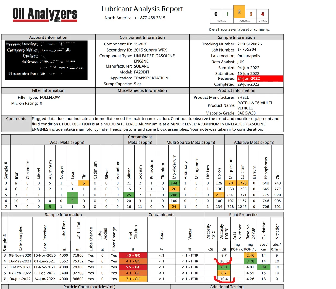

Here's another UOA posted from @crimeariver, who also has a 2018 CX-9. The oil dilution reported in this post appeared to be from a faulty fuel injector, which the dealer replaced under warranty, but my understanding is that he is still experiencing oil dilution issues, possibly from a different fuel injector (assuming the dealership didn't just change all of them).
There may be more 2.5T UOAs posted in the Skyactiv Oil Analysis thread.
I have done the old "sniffaroo" test on mine and I could swear I smellmsome fuel in it, when mentally comparing it to whatever normal is... will keep a nose out on it, maybe sniff other samples to calibrate (learning from my Beagle haha).
Getting change #1 done soon, will do a before and after sniff and will try that actual analysis to keep an eye on things (rather than a nose??) but yeah, potential dilution and my easy fix is to change it more frequently - oil is cheap.
If it keeps up I will ask the dealer to take a look to have it on record and if they need to change injectors I guess they will need to change injectors..

2018 CX-9 Signature. Sample taken at 58500 km on the odometer.
There is a suspected internal coolant leak. No other symptoms of an external coolant leak.

Uh ohh.. Well I guess at this point best you can do is keep a close eye on coolant levels, watch for white smoke from your exhaust... At least you're still under warranty. Thank goodness for Canadian Mazda's having unlimited mileage warranties.
Yeah the unlimited warranty sure is nice. I'll continue to monitor levels. I've also got the engine oil temp on display at all times now, lol.
I'm going to do one more UoA since the last one was free. My next oil change is in 3000kms. After that, I'll contact Mazda and we'll take it from there.
