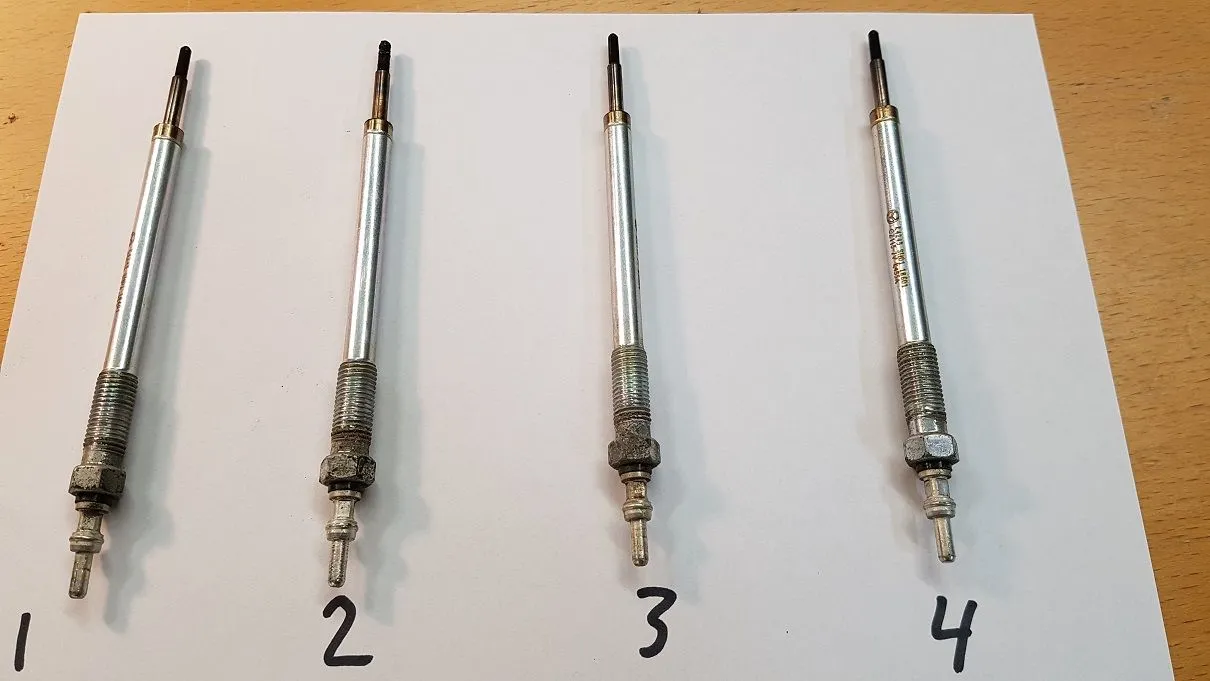

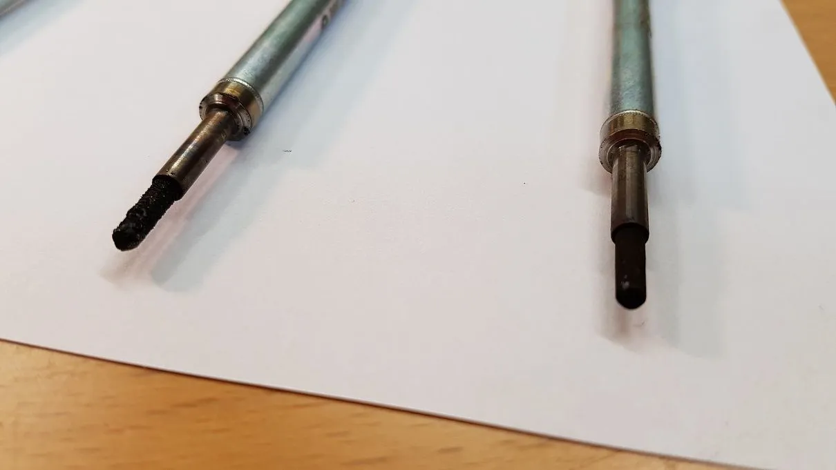

I took out glow plugs and checked and there was something with cylinder nr 2, anyway car will be fixed on warranty.
Yes it does look strange however, don’t do any more pulling parts because if they suspect you’ve been meddling they might withdraw from warranty.
Very good photos.
My car is at Mazda dealer and they will start to fix it tomorrow and they promised car back next friday. I told I have checked plugs and it was okay for them.
Got my Mazda back yesterday and now it's all okay with the car. It was broken headgasket on syl nr 2. They have changed new sylinder head with all the parts in it and head gasket. Got it on warranty so all the thumbs up for Mazda!
