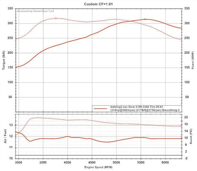

first post updated with some pretty big changes. i'll have some parts going on as well as new wheels getting fitted. i'll leave the wheels as a surprise. i've been tuning on a 2.5gal e-85 mix the past week and was making good power then i blew out a injector seal haha. Have a new set on the way then i can resume tuning. tq is a little low but thats because i'm running 0* timing @3k and 2* timing at 3.5k after i get the new seals in i'll bump that up a little bit.

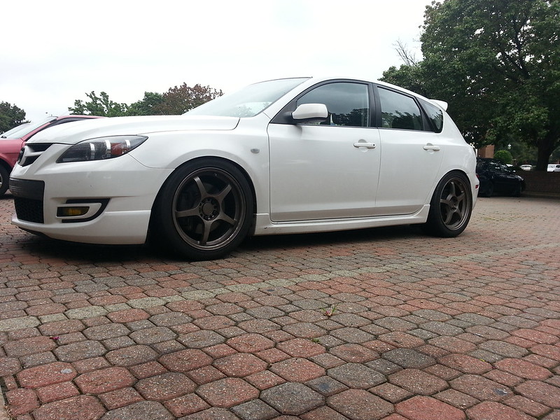

just fitted some new wheels and tires this weekend =D.
Ray's Engineering Gramlights 57f 18x8.5 +40 in front and +45 in the rear
Wrapped in some 245/40 Dunlop Zii's
looks alright i guess..:) (I still miss the protege)
you're allowed to miss it lol These ray's are pretty light the tires are what add's most of the weight. i wan't to say this wheel/tire setup is lighter then the work/hankook setup that i had on the msp
well they fit the car nicely, least they are not black or white.

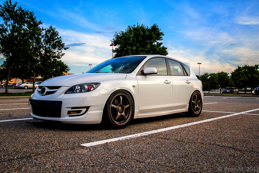

decided to break out the camera on a quick trip to the store this evening. the car is filthy but still manages to look good
