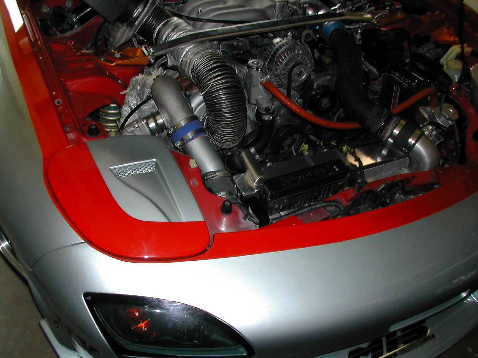

ha ha no worries just giving you a hard time , we use a t78 in our FD, 440hp @14psi

8k RPMs said:
nice. @ the wheels, or the flywheel?
that was at the rear wheels, we have a few more tricks and it should be back on the dyno with some more PSI
