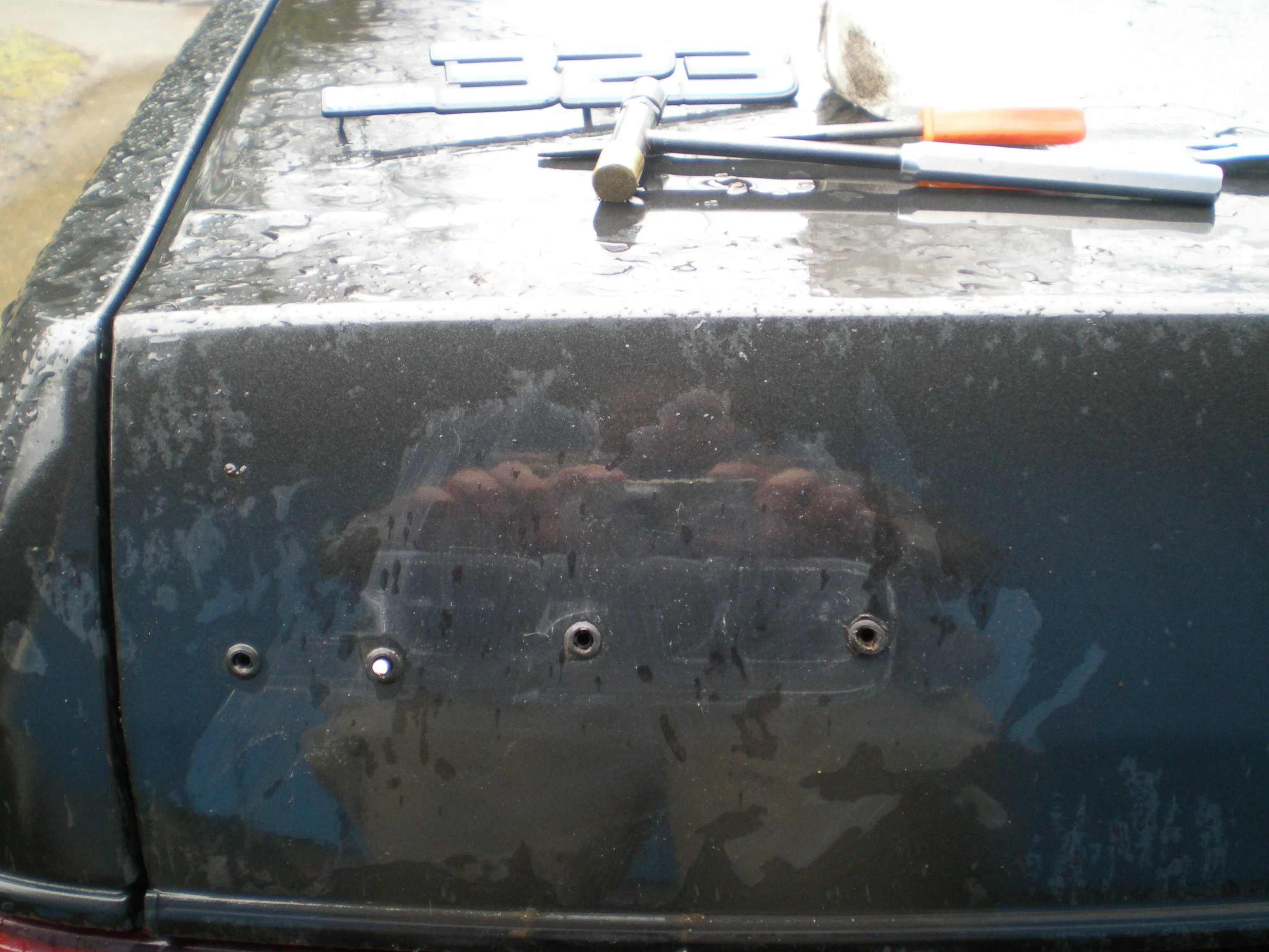

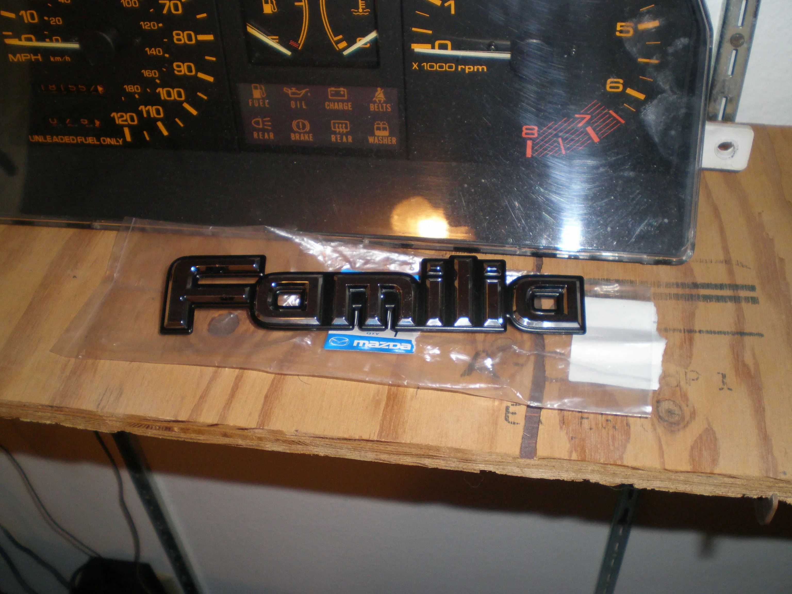

OK, heres a little teaser for you, ile post a few more later.
Braking my own rule of performance before cosmetics, but Ive been searching for a BF badge for a while, and located one in Japan. (rei)

So a few questions...
1. FE engine? and wtf is that you running a turbo carb system? I liek what you did though, with the plenum and everything...nice work there chaps.
2. What turbo your using? stock IHI or something else? PSI's boosting? How fast is your spool?
3. wheres the intake, cant see the HKS...unless you mean the air filter.
4. What about a FMIC, ever thought of it? If your not pushing many psi's I can see why you wont though...
Overall nice ride you got there. Fairly impressive, and Im glad to hear your a "engine first looks later" guy.

The engine is a B6T and they are fuel injected. The turbo looks like the stock VJ14. Back in the day the HKS filter was considered an intake for the 323gt/gtx. Looks like he is running a MX6/626 intercooler there in the stock location. It is better than the stock IC.
Derrick
That was my second guess on engine series. Should have known from the dif. mani. And how could you figure out the turbo without a clear picture of it? Only thing you can barely see is the compressor housing and that dont tell you much. And lol @ filter being considered a CAI, but cool beans.
Obviously, you dont know Derrick very well. Hes one of the owners of CorkSport, a Mazda Performance shop, the one and only Best place on this earth for Mazda performance Parts, service, and help. ;) He, Himself, has a Very well done GTX w/ the 1.8 BPT swap in it.
The car does have a ways to go. It is the stock IHI VJ14, only doing 9 psi on an unchipped ECU. All the work to be done is listed on the first page. But, it will have a new Imark bumper installed, and then will be shot with MP3 Blue. Front mount intercooler will be installed after the bumper, with the extra space, is installed. I do plan on putting a VJ11 in a little later, after most engine work is done, and after I can pay Derrick to chip my ECU. Then some Lancer OZ wheels, and I think Ile be good from there. Right now, I reach full boost around 3500 rpms? Off the top of my head, thats a guestimate, I cant remember.
And, I never said it was a Cold Air Intake, its just an HKS intake, which technically does away w/o the filterbox, and small intake pipe routing. ;)

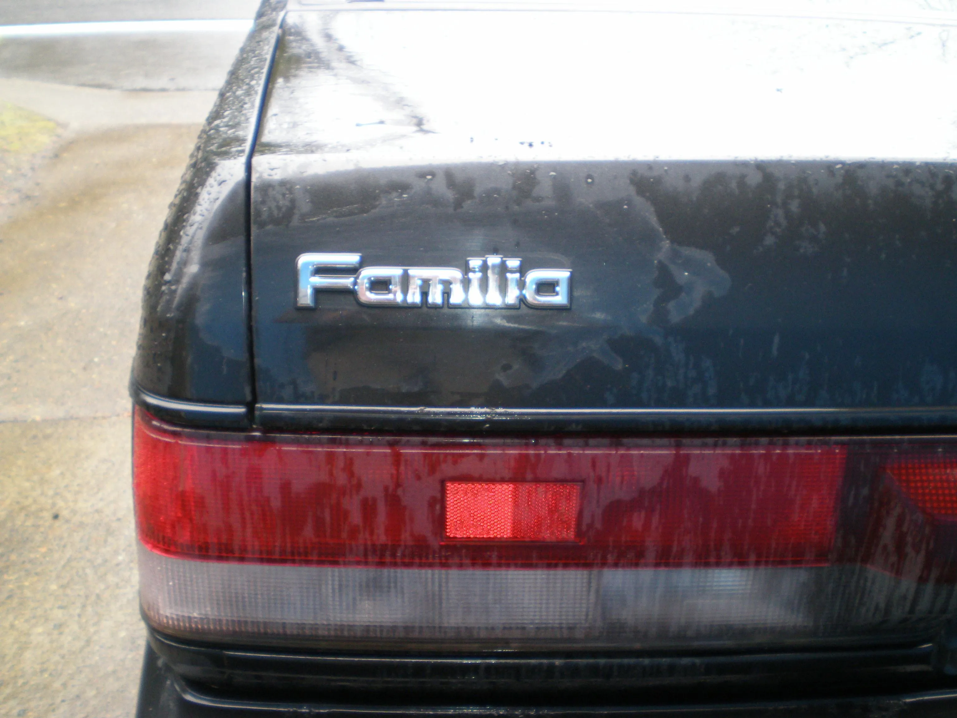

Ok, final shots from the teaser, Im very pleased. :D
