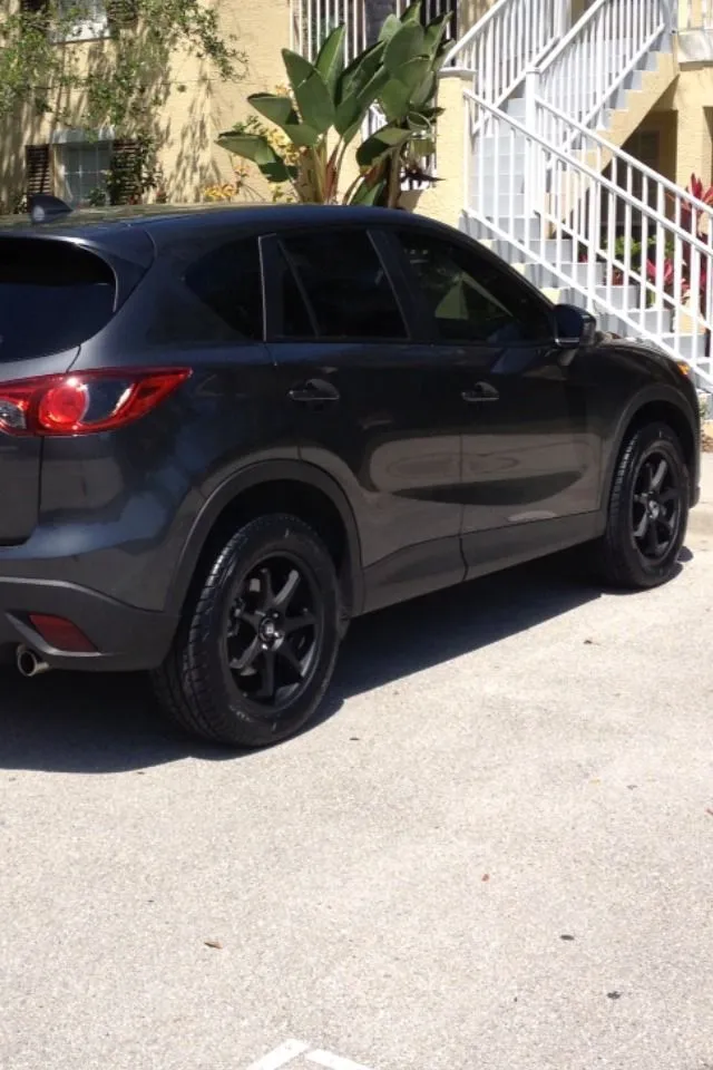

I have 18's as well. Styluz 18 x 8.5 with a 40 offset, and i have Goodyear Eagle Gt's 235/60/18

The other thing I considered when moving up from the 17 inch to 18 inch wheels was the width of the wheel........the factory rims 17 or 19 inch rims are simply to narrow only 7 inches wide for a vehicle with such a bulging back end. The vehicle should have wider wheels and tires....my neighbors cx7 has wider 18 inch factory rims and 235 tires. The width of the rims I have with a bit of a different offset dramatically improves the stance of the vehicle and fills in the bottom of the vehicle proportionally.

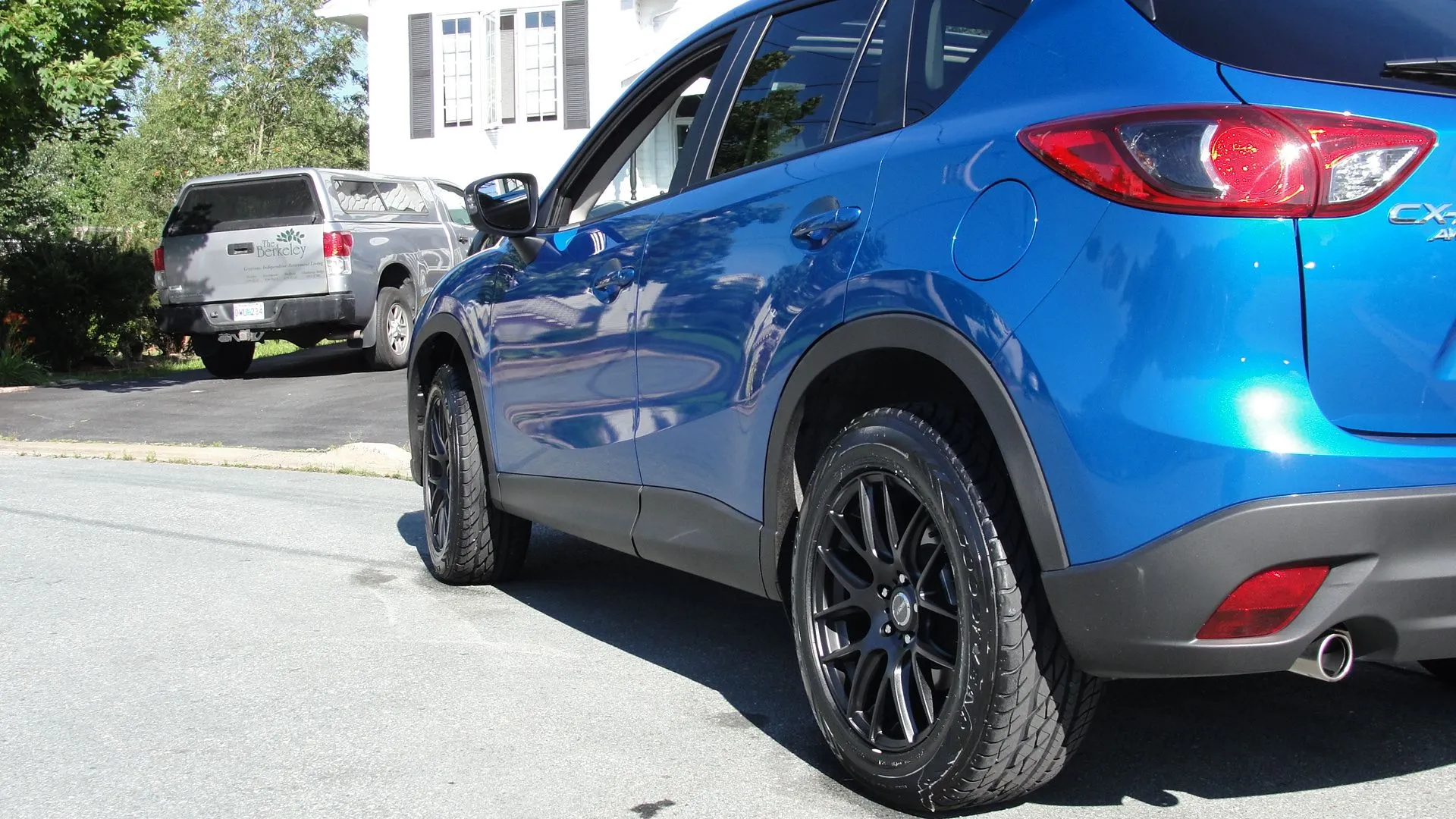

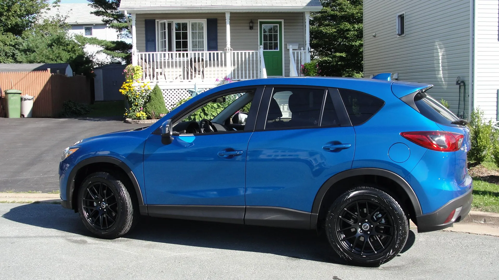

After much thought & deliberation I have chosen to run 18" wheels on my 14' GT. Should have them this coming Monday or Tues. I decided on Motegi Racing MR125's 18X8 w/ 35ET and for tires I got Nitto Crosstek 255/55 18's.
Stance problem resolved!
Pics coming soon!

My new wheels are 20lbs each so I'm definitely shedding some weight over the OEM's, the difference will be going to a wider tire to alter the stance and get a little more traction. I hope to weigh everything and provide some numbers to go with the pics next week when I have them installed. I used an offset calculator so my 18X8's will look almost identical to Snowie's 18X8.5's but with mine having wider tires.

New 18's
New Motegi Racing MR125 18X8's w/ 35mm of offset & Nitto Crosstek Cuv 255/55R18's...
OEM 19's... 58lbs
New 18's... 51lbs
