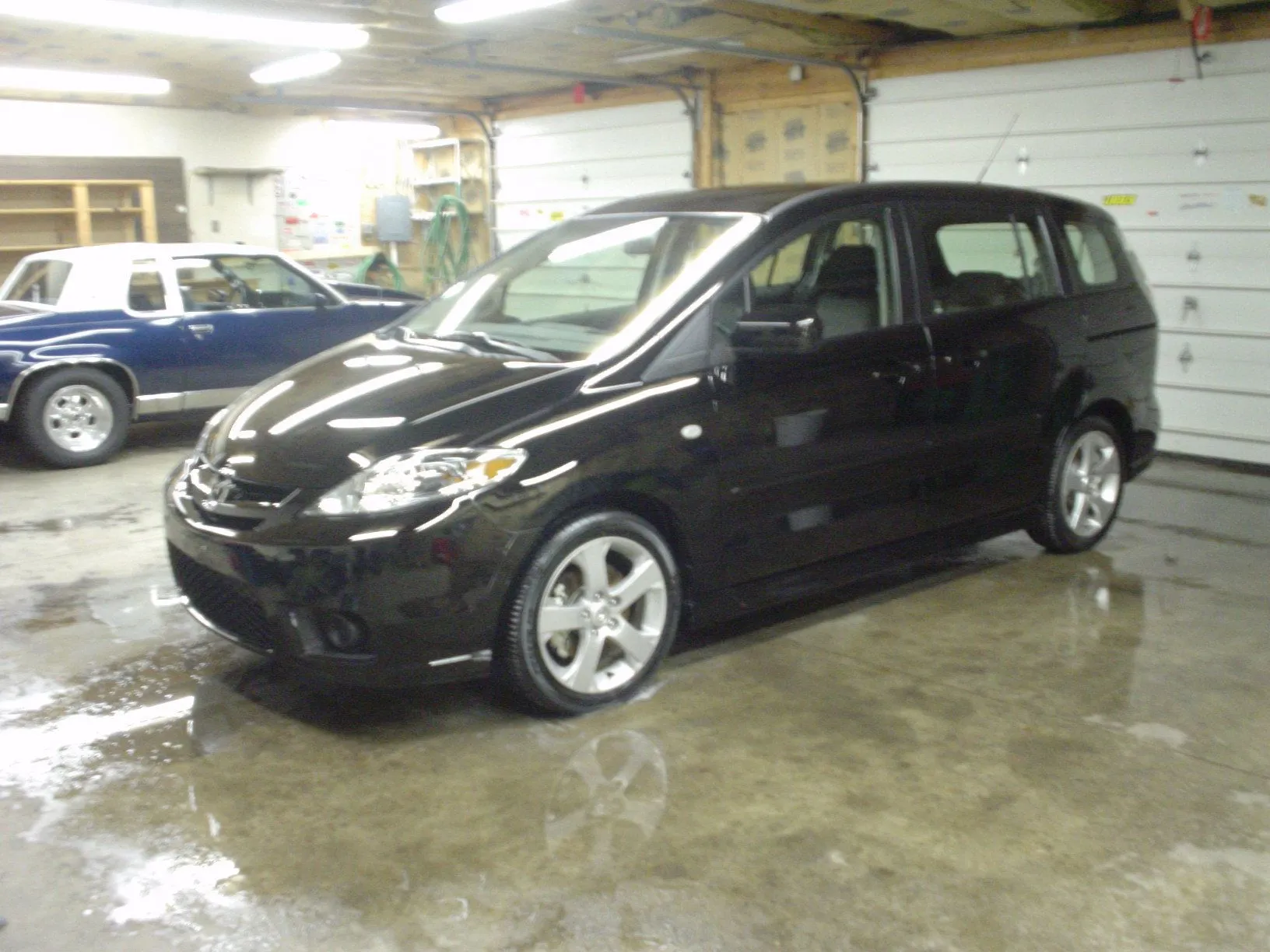

On my P5 slammed with 215/35/18's I have a 50mm offset on 7.5" rim with about .200" clearance to the fender and .200" to the coilovers. Different brand tires also have wider more square profile so be aware of this. As in a Toyo vs. Pirelli 215/35.

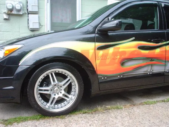

17's here 215-45-17's is all the tire you'll need to make that thing handle like its on rails just invest in some good rubber to go with um later!!!!!

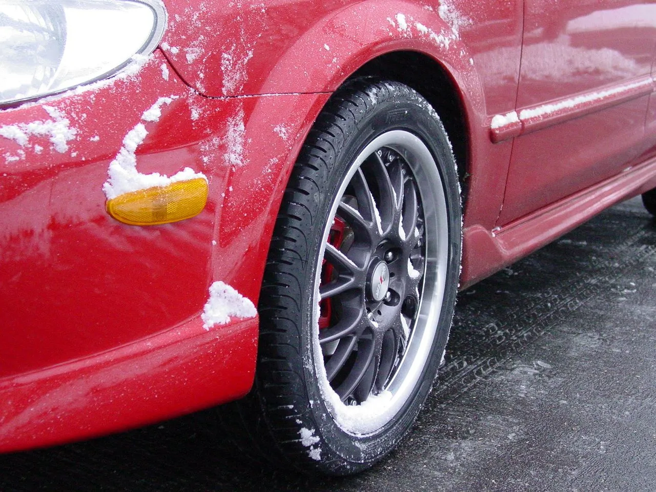

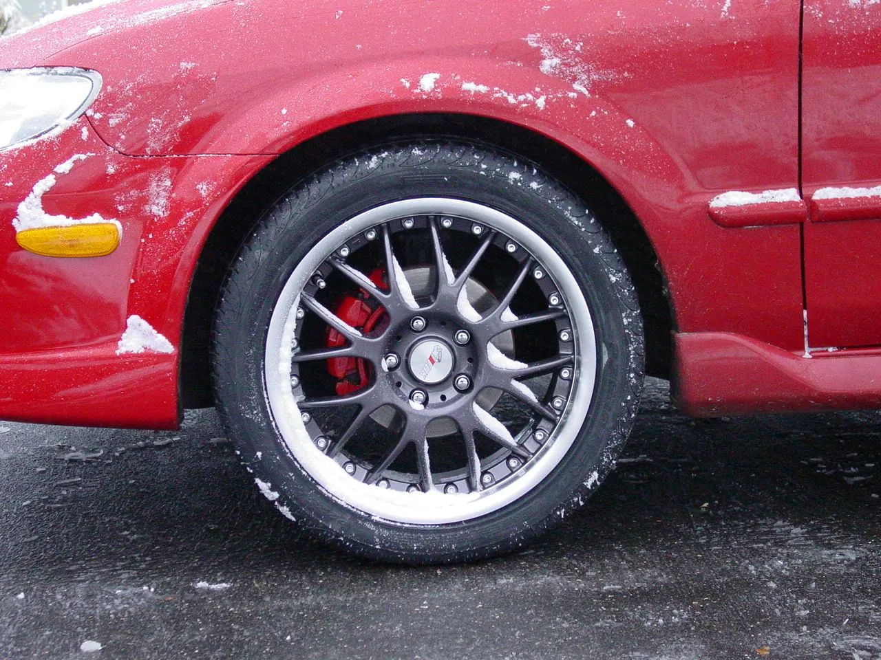

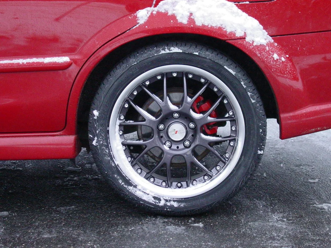

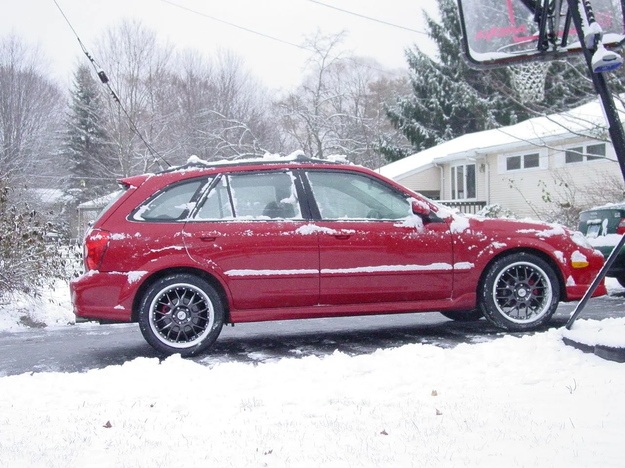

quick edit: while cleaning the cars and driveway I figured I would get some pics you can see the gap on the front and rear and then see the marks on the last pic
