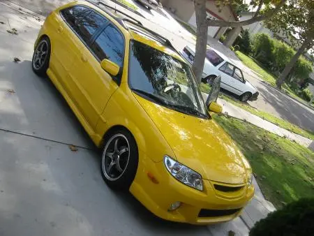

The only time mine rub is when I corner hard and the plastic front fender liner sits down on the tire. No rubbing in back at all, took it to the beach a couple weeks ago, loaded down, and rear tires were tucked nice(2thumbs) I know mine are only 7" wide with +45 offset and 215/35 and Goldlines. If you get 17s you will most likely want to drop it to get rid of the fender gap.
