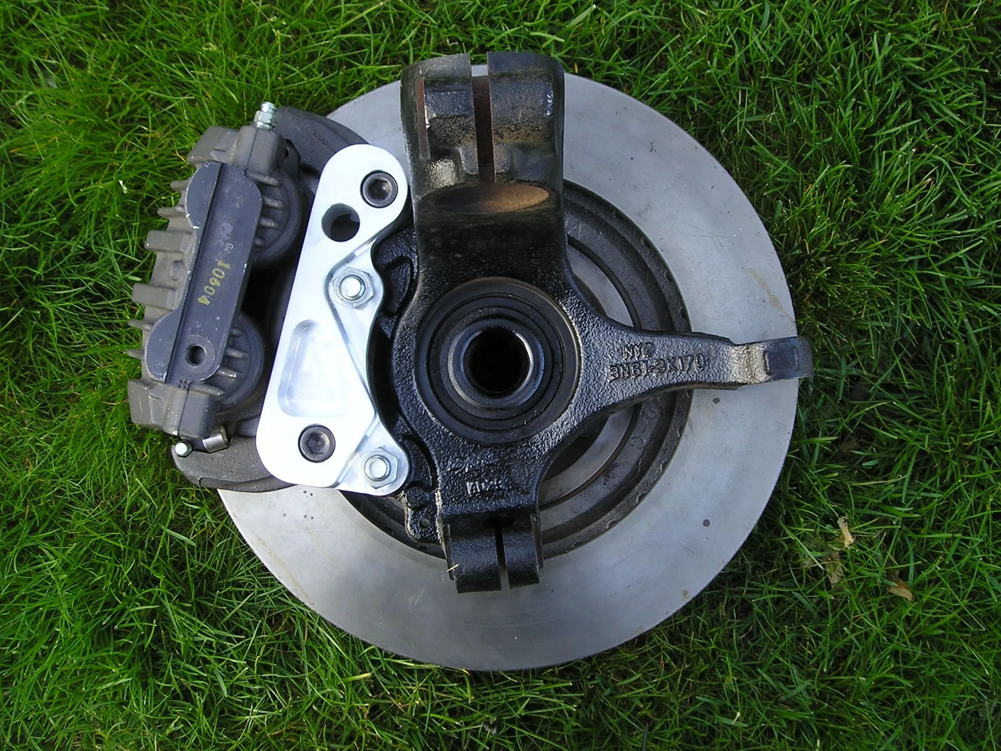

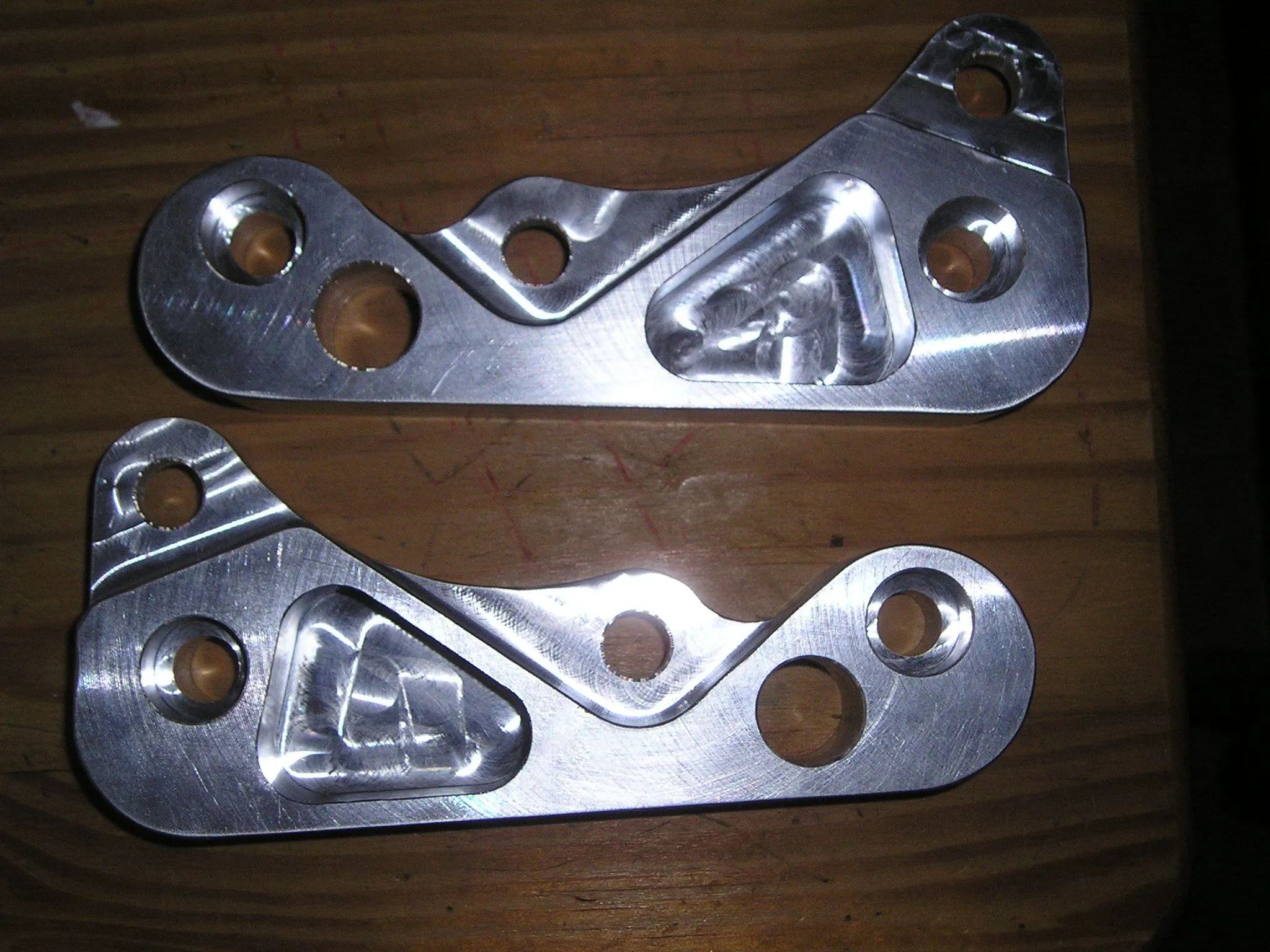

I have been working on this idea for a while now, and finally got my caliper bracket custom machined and mocked up on the car today.

I want to put together a kit that works good and doesn't cost near as much as the kits I have see.
I am still working on the correct brake hose then I can complete the install and test it out.
cost?
keep in mind I sourced my brake parts wholesale, however at auto zone loaded calipers with pads and brackets, and 2 new rotors are under $400.00 and I have about $500.00 in the brackets and a used 3 steering knuckle for $70.00 for the mock up at the shop . That and my time which is worthless if you ask my friends, still cheaper than anything i have found online. The cost of the brackets is high, but anytime you have a one off anything custom machined you have to pay to play...I haven't worked out a price on a per pair price for a larger run....I thought I should work out any bugs before I worry about that.
Who has a spare MSP knuckle I can work with..

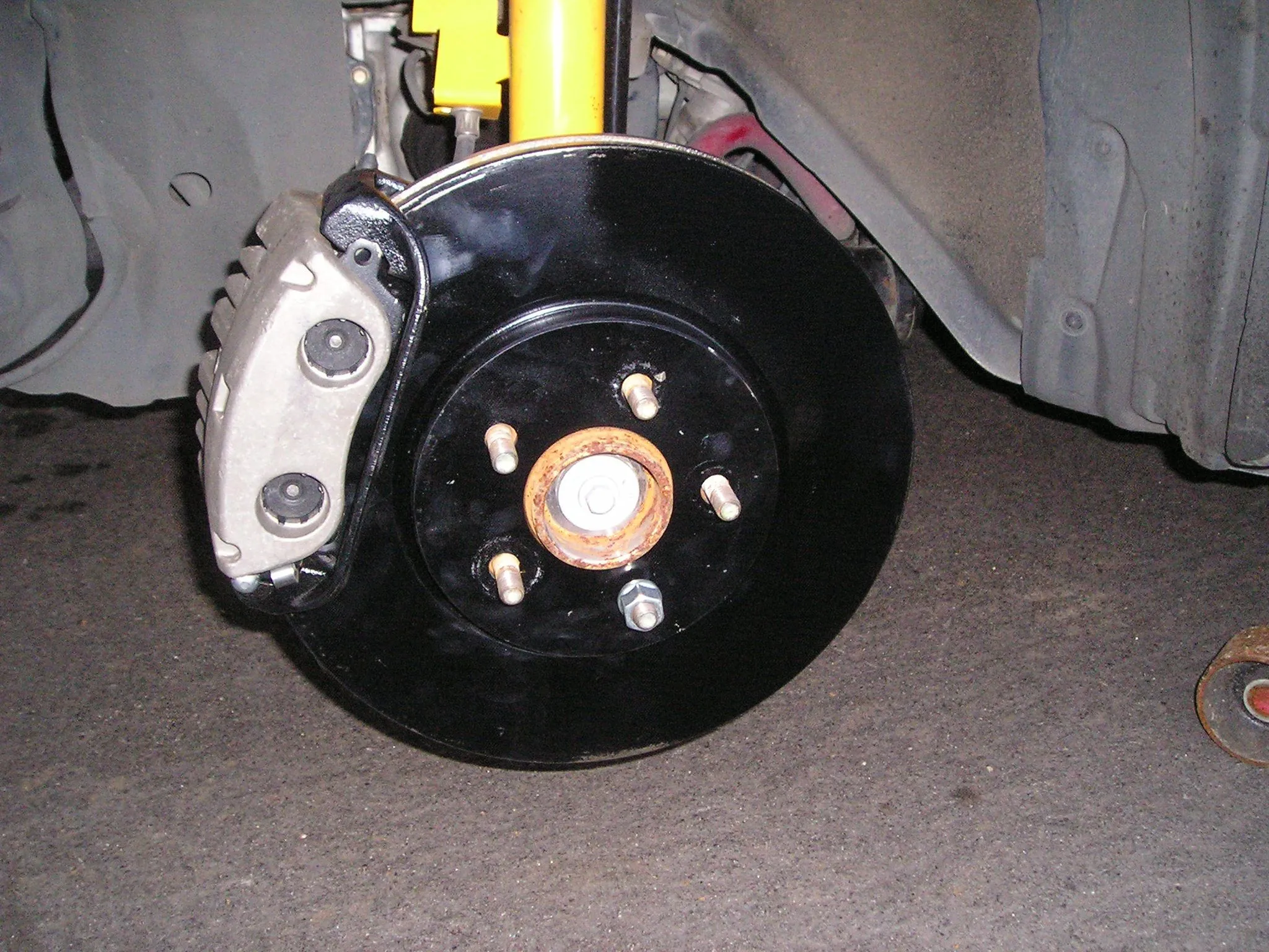

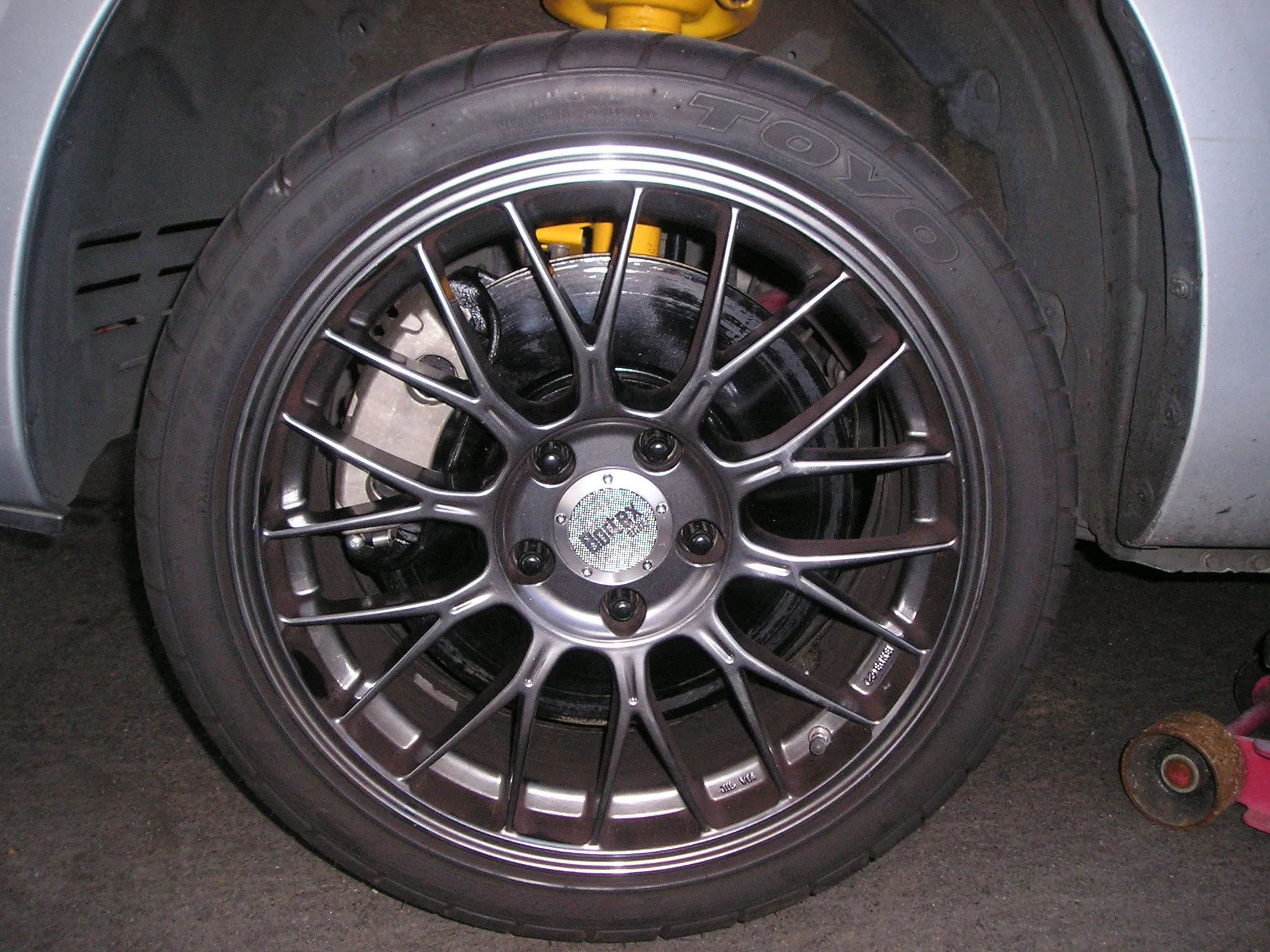

On the car

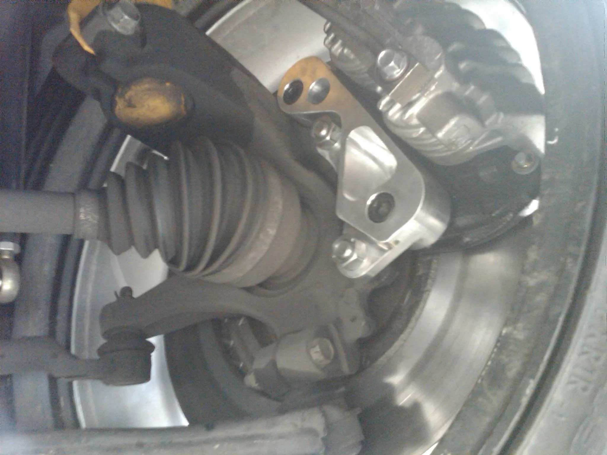

Well your right about it not being a kit...this is a one off idea that has finally come full circle.. Today is Wed April 29, 2009 and the new brakes are installed.
The bracket does move the caliper out to clear the new larger rotor, however the new rotor and caliper are both off a 97 Ford Cobra Mustang..In order for this to become a kit I would have to have enough interest in it to have my machinist run off a batch of brackets.. The idea was to use off the shelf parts that anyone can get at any parts store excluding the adapter mounting brackets. Spending $1300.00 for bigger brakes is hard on everyone, but what if you could do it for around 600 0r 700 maybe less....That's more of what the average joe might buy..
The car is out on the road getting some miles to seat in the brakes for Sunday autoX I can't wait.
Initial thought Brakes feel good, solid pedal.

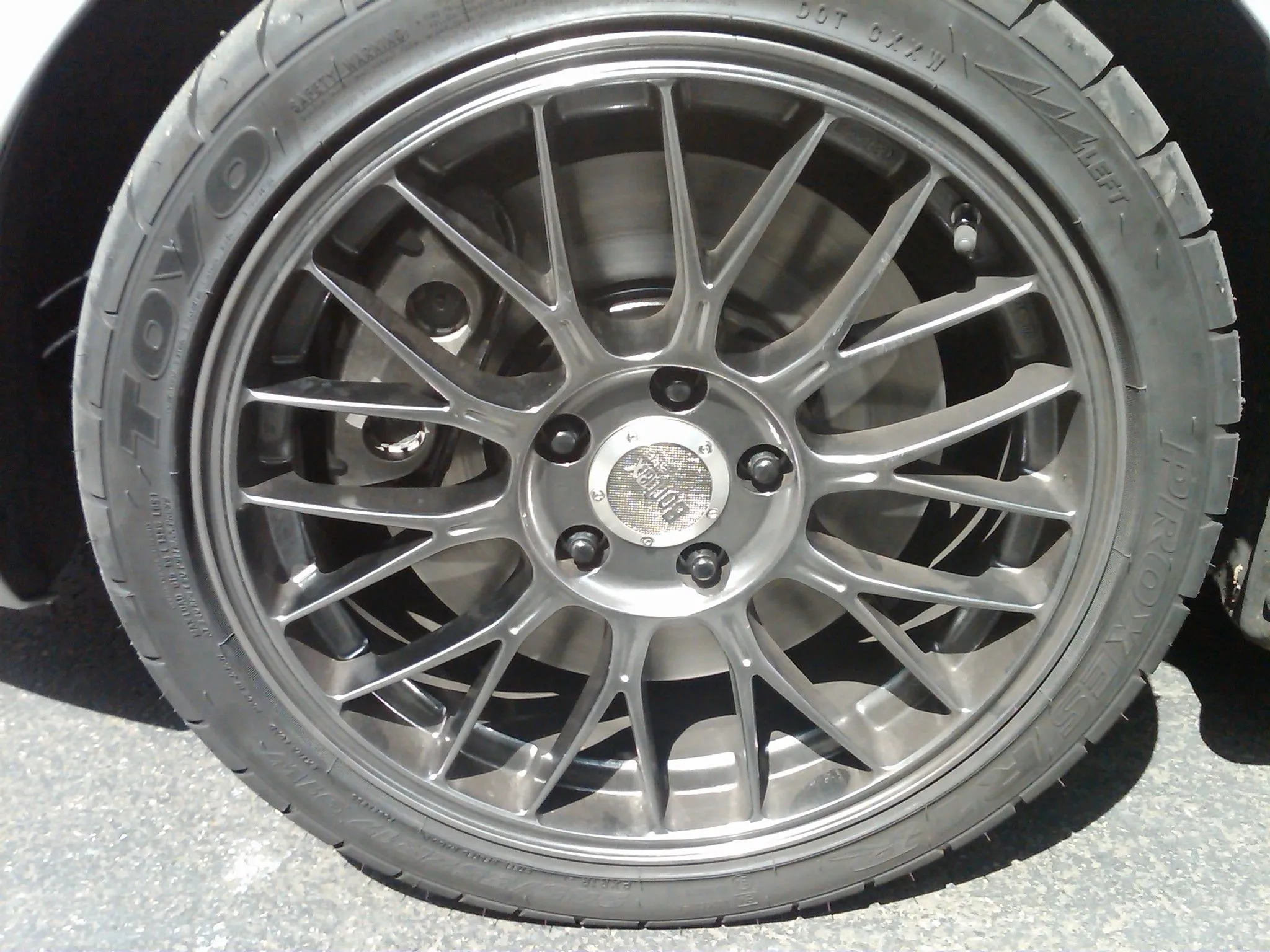

So after this weekend's event, I can totally vouch for this! This car stops amazingly well. We switched cars on our last runs and I ran 2.1 seconds faster in the 3 than I did in my MSP! That's a base model 2.0...
Oh yeah, the TOyo R1Rs are awesome tires as well!
