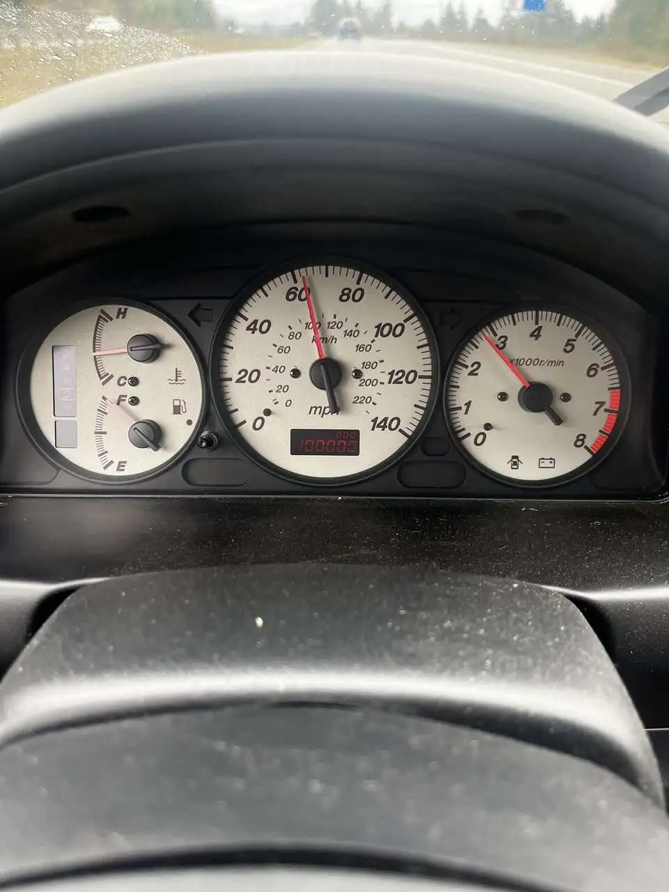

Boom! After 21 years my car has finally crossed 100k miles.
