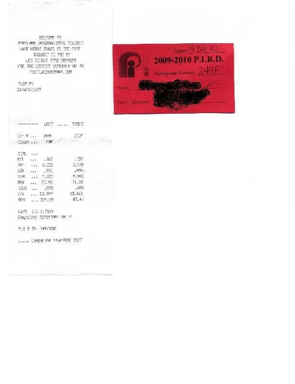

Finaly took the 3 out to the track. Running 225/40-18 tires with 400 tread wear rating at 28 psi.
I have some work to on my launches, the tires are no help either, but I doubt I'll do 1/4 mile runs again for a while. Other than that I am happy with the car and hoping to get tires and wheels for road racing later this summer.
My average time was 13.7 -13.8 with 2.4 sec 60' times at 105 mph average.

Maestro, nice run, especially the trap speed. If you can get these little babies to hook up, they do very well once under way. BTW, for front wheel drive the posted slip's 60 ft. of 2.221 is pretty good.

I am sure you will get the sixty foot down. The car is certainly pulling at the quarter with that speed. I have not gotten a handle on wheelspin yet. Well done!
