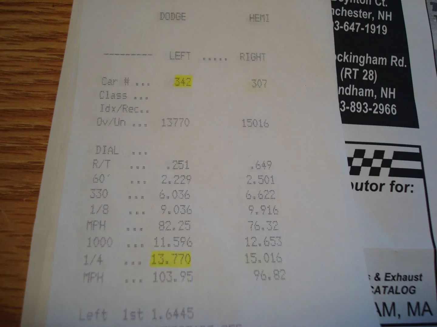

with all the mods done to my car i get no traction at all. dont really have the money to get slicks. i went to the track last night and got a 14.7 and then 15 something. pretty bad. how do you go about launching these cars? i had my rpm at about 2500 3000. and feathered the clutch a little but once i let go its just wheel spin till redline then wheel spin again in 2nd. is there a better technique?
lantagne21 - 2.22, 9.03 @ 82.25, 13.77 @ 103.95 (I, FMIC, DP, RP, MM, S)
