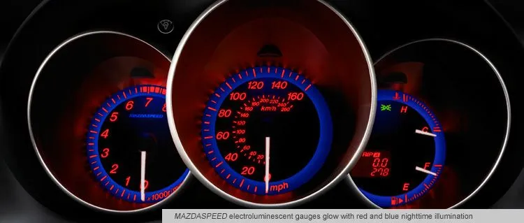

Not so fast (puke) 240ka, this is what it's supposed to look like.....
Not so fast 240ka, this is what it's supposed to look like.....
if only it could look that blue and uniform all around the circle. Ive been wanting to make it brighter but there seems to be no way without cracking open the gauge and putting in brighter leds, since its not an actuall bulb that can be switched

thats what my gauges look like on my 08

not a fan of the white needles. Sort of stands out too much for me... but whatever. pretty minor difference really. It'll be interesting to see how the new models look at night.

besides the needle, nothing has really changed. same shade of blue, but i do lean towards the white needles though, looks nice, but can lean to a headache during long drives having white glowing in front of you for so long.

Not sure what you mean, I have a 09 and I never noticed my needles were white until. This thread. They mos def do not stand out. If they did it would be a safety issue.
