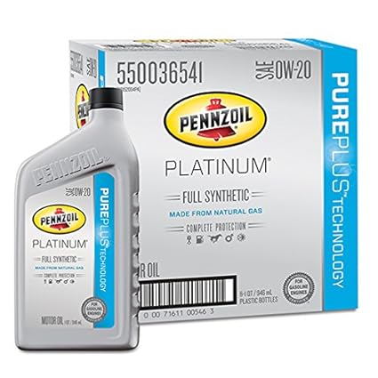

katman, which weight of Pennzoil Pure are you using?
Can one consistently get a cheaper price on this Penzoil alternative as this is basically the same price as Mazda oil? Rebates won't always be available when you need it.
https://www.amazon.com/dp/ (commissions earned)
It may actually be a little more expensive as this doesn't include a filter.
I don't get oil off of amazon as the shipping can be a killer. I think I paid around $5 a qt. The rebates and offers come and go. Even without rebates and offers, still probably cheaper as Mazda oil in my area is around $10 a qt, waaay too much for oil. I can get Redline 5-20 for around $7 a qt from a wholeseller which that too, is likely better than Mazda. Want a lot of moly? Redline has it. Want a real synthetic, not a group III? Redline is made with ester/pao.
I think without coupons and deals, the most I have seen it go for is $9 a qt. I think Walmart has it in a jug for less.

A five quart jug of Penzoil 5-20 from walmart will cost 25.17, or $5 a quart. That's every day price, if you have rebates, even cheaper.
