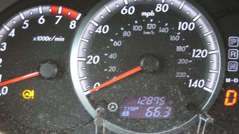

My 2008 mazda5 has about 11k miles and already had several incidents with Power Steering light. I showed Koeppel Mazda the TSB but they told me to drive / toll the car while the light is on because that's the only way for them to get paid.
I'm hoping more mazda5 owners will complain to NHTSA to pressure Mazda for the recall of the power steering issue.
That to me that is a bad dealer, carry your digital camera and take a pic including the mileage when it happens, that to me is good evidence (dunno)

I went to Manhattan Automobile Company instead of Koeppel. They kept the car for a day and performed TSB 06-001/10. The vehicle was washed before returning to me. I even got a free rental car from enterprise. Overall I am very satisfied with their service.

Found error code C1099. They replaced the following parts as per TSB 06-001/10 and also flushed the PS system.
BBM4-32-68Z Oil Pump Service Kit
BP4L-32-47YM Pipe Assembly
9956-21-400 Gasket
0000-77-110E-01 Trans Flu
0000-77-620E-03 Brake Part
BR5S-56-496 Nut-Clip
9947-90-620 Bolt
